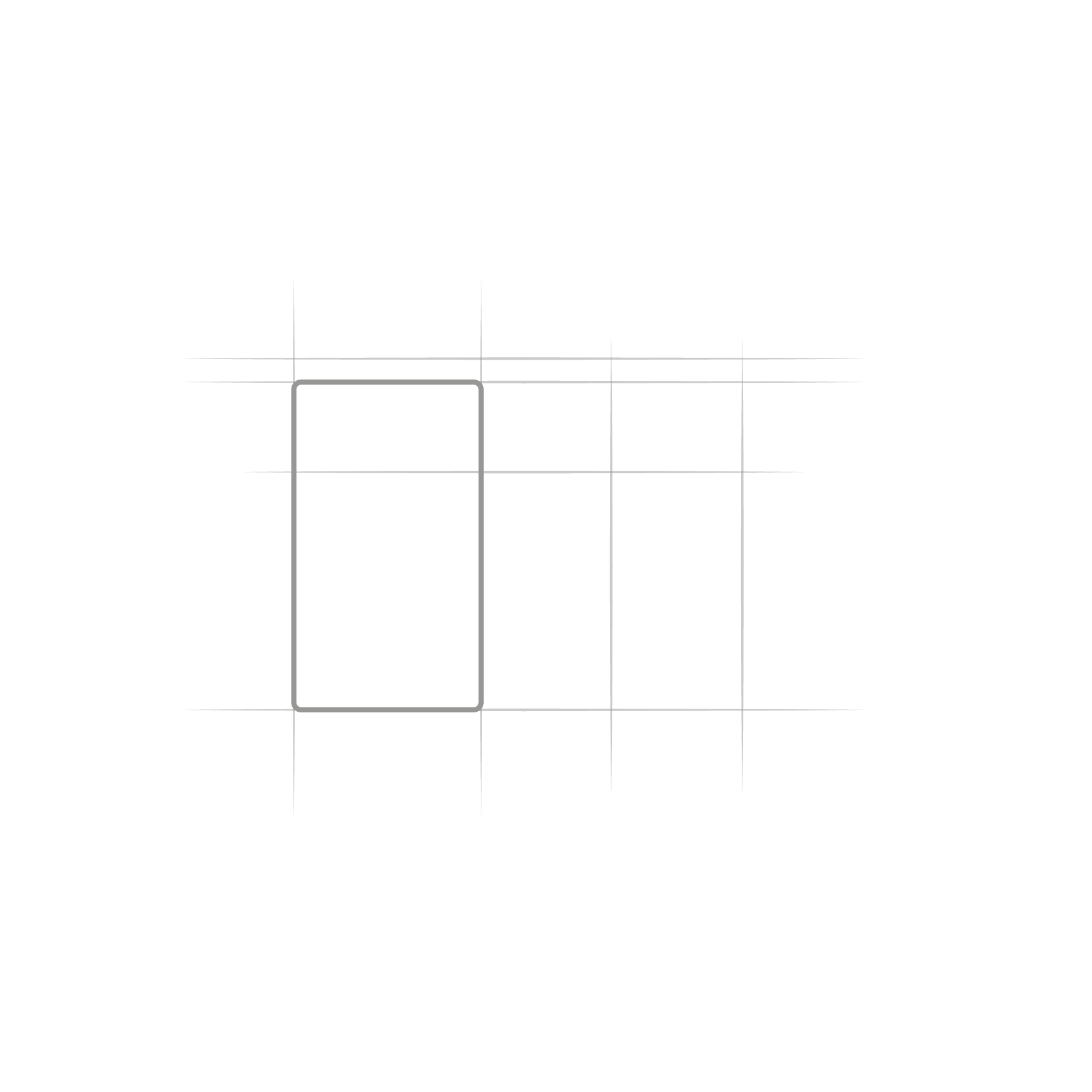

Start by drawing a few construction lines to create boundaries for the different views of the object. Try to get the proportions as close to the real object as possible by using your fingers or your pencil to get a rough idea. Remember to draw parallel lines first, then draw the crossing lines do get proper right angles. It's often helpful to use tick marks as targets.
Before going any further with construction lines, draw the primary shape of the object from one viewing angle. In the case of the battery, that's the rectangular profile of the front.
To draw a rectangle with rounded corners (also called fillets in designer speak), it's important to draw the parts individually. Draw straight lines, then rounded corners or vice versa. If you try to draw a rounded rectangle in one continuous stroke, you're going to end up with a potato.
Next, add whatever other features can be seen from that point of view. For the battery, that would be the terminals on top. A couple of center lines will help keep the location of the terminals correct (these represent the centers of the terminals, not the rectangle).

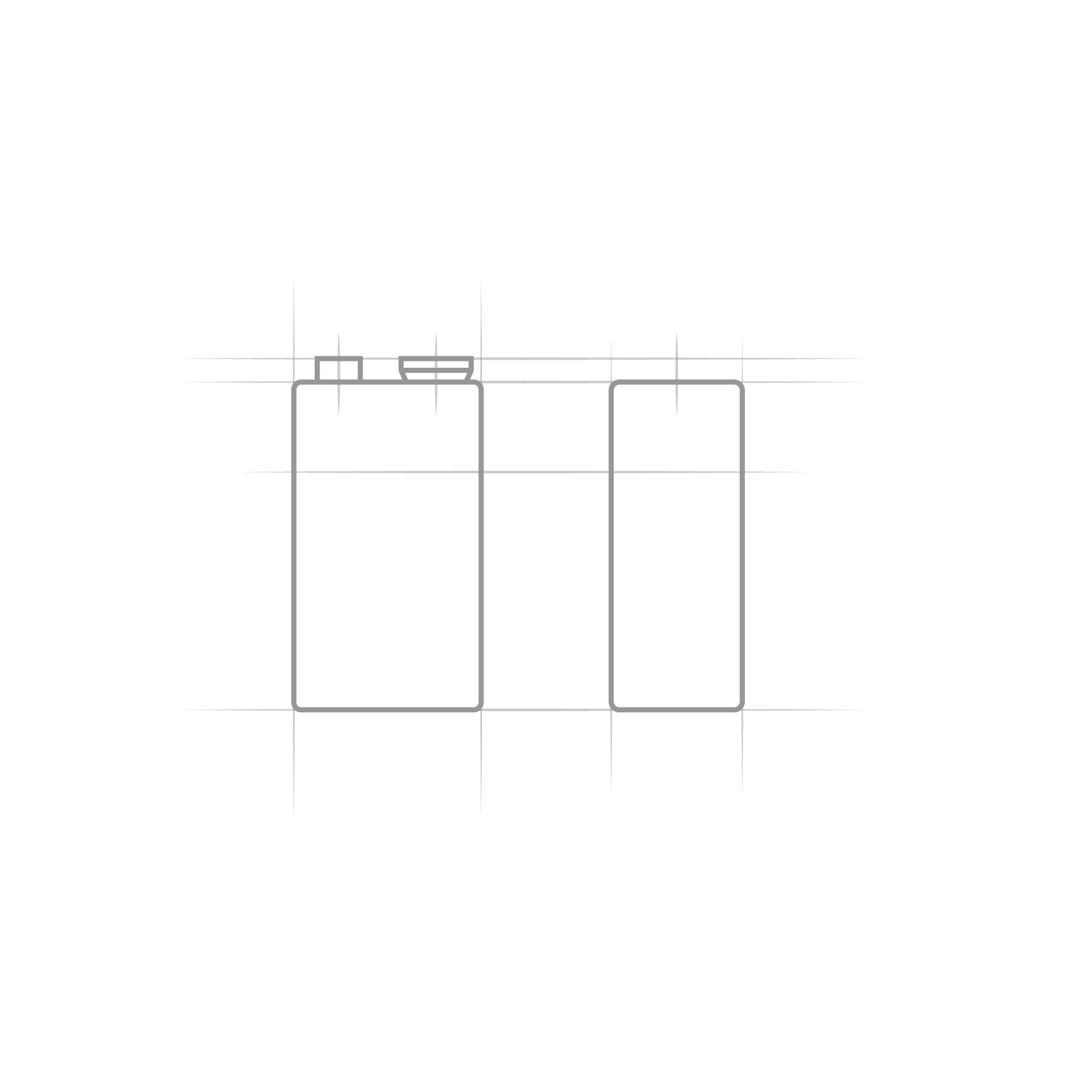

Step 3: Side View
- This video has no sound -
From the front view, the terminals just look like rectangles, one of them having an angled base.
With one view done, it's time to move on to the next view. The construction lines are projected from the first drawing, so the proportions and dimensions will be consistent.
This is the whole point of a multi-view drawing. When the views have dimensional consistency, it's much easier to understand an object, and it's crucial in using sketching as a design tool.
A centerline is used to ensure the terminal seen from the side is in the correct location.

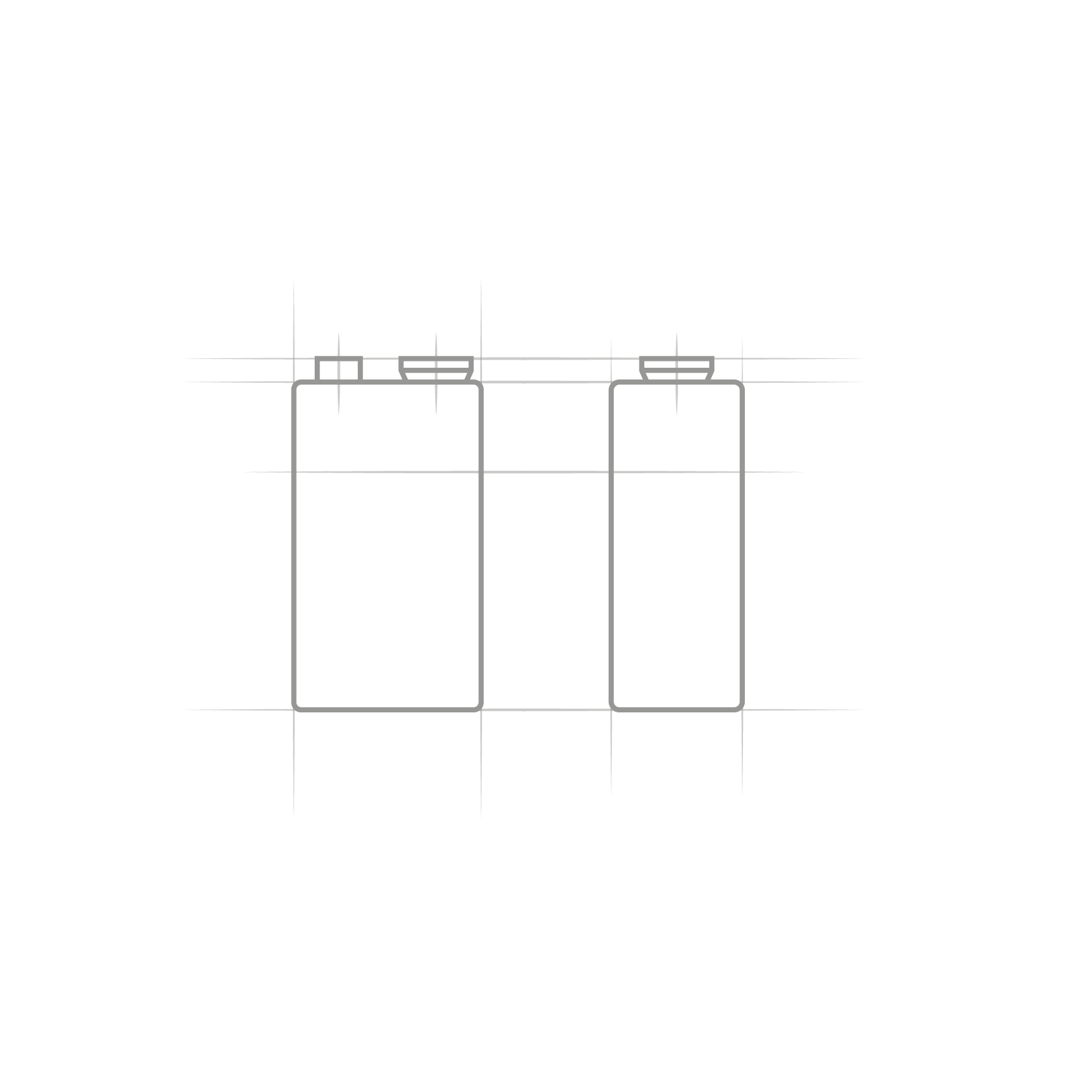

From the side, the terminal looks roughly the same as from the front.

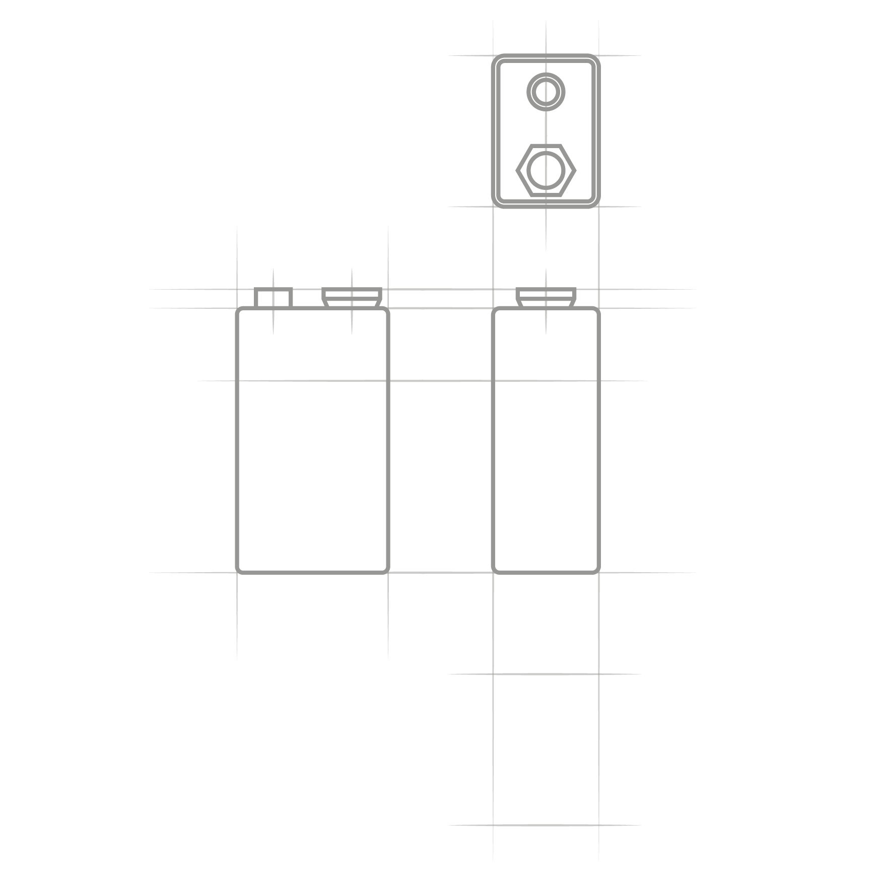

Step 4: Top and Bottom Views
Drawing a top view will use construction lines as well. The vertical lines from the side view are extended to make the long sides , then reference the front view to determine the length of the sides and draw connecting lines to complete the rectangle shape of the top view. This view is easy because the rough width dimension can come straight from the front and side view.
Another rounded rectangle will make the perimeter of the top view, and a centerline will help control the location of the terminals in the top view.
Finally, the details are added to the top. The negative terminal is a circle in the top view, and the positive one is hexagonal. The battery also has a small bezel around the top that's made from the way the cells are enclosed with the foil wrapping.
The construction lines for the bottom view are projected from the side view as well. Note that this view could be projected with construction lines from any of the views.
