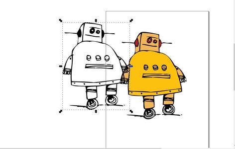

Step 2: Find and Prep an Image.
Picture 1 - Choosing an image: When taking a photo or looking for an image, keep in mind that it will probably turn out better if it's high in contrast..
Picture 2 - Scaling image:Scale your image so it fits on the page, first, click on it once with your 'select and deform tool', then while holding the 'ctrl key' (windows PC) on your keyboard (to keep length and width ratios equal), drag a corner to until it's the size you'd like.
Picture 3 - Trace bitmap: After clicking on your image with the 'select and deform tool,' select Path >> Trace bitmap from the top drop down menu (or press 'shift' + 'alt' + 'b' for windows users). Then uncheck smooth and check stacked scans (not sure if this is important), and remove background. Then click ok.
Picture 4- Delete original image (but keep new black and white bitmap): now, again, with the select and deform tool' selected, move your overlapped image over, then delete the one that isn't black and white.
save as .SVG: go to File >>Save as, then make sure under "save as type" you select "inkscape SVG (*.svg)."

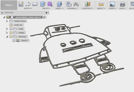

Step 3: Convert to .SVG Image to .STL Printable File
Picture 1: Open fusion 360, make sure your in 'model' mode, and then select the 'insert' drop down, followed by 'insert svg.'
Picture 2: Select which axis you'd like your image to be on (you can later adjust this with your printing software), then click the folder icon and find your SVG you just made
Picture3: Your SVG should now look something like this.
PIcture4: Select extrude from the create drop down, and start clicking on portions of the image you'd like to put emphasis on.
Picture 5: In the distance tab type in 1mm, then press ok.
Picture 6:Your 3D model should now look something like this.
Picture7: Making sure to right click the top directory of your 3D file, select "save as STL."
