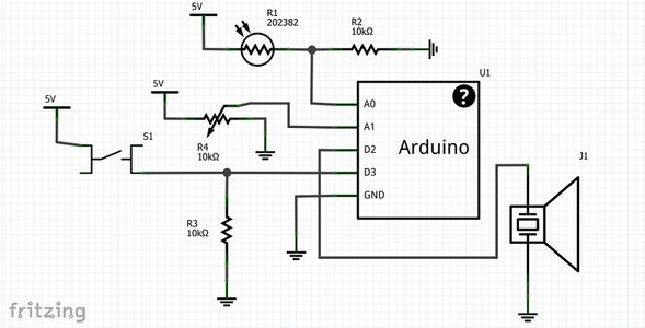

Step 15: Hookup the Remaining Components.
- Add the remaining components using the schematic shown.

Step 17: Test Project
- Near the beginning of the program for this project, there is a section marked as " // Easily change adjustable variables here." Go there and make these changes. See picture for example.
- Change gracePeriod to 3 minute and startMonLgt to the hour previous to the time you’re in now. For example, if it's 2:10 pm for you, then adjust it to 14 (time is in military format).
- If there's light in the room, then you should hear a beep and the LCD display should say "Minutes left:" with the minutes on the second row showing you 3.
- Find the serial monitor button on the top far right of the Arduino IDE. Press it and another window should show. Make sure the bottom right of the window is showing 9600 baud. If not then pick it form the list.
- The analog value of the photo detector sensor should be scrolling on the left. Divide the max value you can see in half and enter it as the threshold value in the adjustable variables section of the code.
- Cover the photo detector and the analog value should fall to a low value such as less than 50. Also note that the LCD will show you the time instead of counting down the minutes.
- When you uncover the photo detectors then a beep will sound again and the countdown of minutes start over again.
-Press the tactile switch until the minutes go back to 3 minutes. This verifies the more grace time circuit works.
- Let the minutes count down until the beeper starts which will remind someone that the lights need to be turned off.
- If all functions as described above, then adjust the gracePeriod to the minutes you desire.
- Also set the startMonLgt and endMonLgt to the times you want your project to start and end the monitoring of lights. I set mine for 21 to start and 5 to end (9 pm to 5 am).
