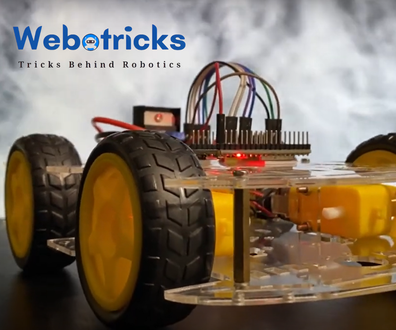

Introduction: Line Follower Robot Using Arduino
This project demonstrates how to build a simple line-following robot using an Arduino Uno. The robot detects a black line on a white surface using two IR sensors and moves accordingly with the help of an L298N motor driver module. This project is an excellent starting point for robotics enthusiasts and can be further enhanced for advanced applications like obstacle avoidance and path optimization.

Step 3: Testing and Calibration
Before testing the robot, calibrate the IR sensors using their onboard potentiometers:
Adjust the sensor sensitivity so that the LED indicator remains off when over the black line and on when over the white surface.
Ensure the motors rotate in the correct direction when moving forward. If needed, reverse the motor wires connected to the L298N motor driver.
Step 4: Running the Robot
Place black electrical tape on a white surface to create a path.
Turn on the robot using the battery switch.
Observe the robot as it follows the black line.
