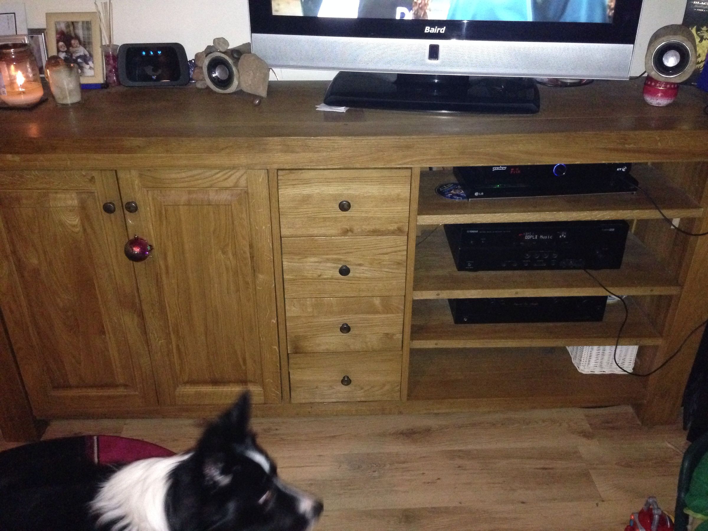

I had no where to place a centre speaker for my surround sound s I decided to make two and wire them as one to sit ether side of my tv.

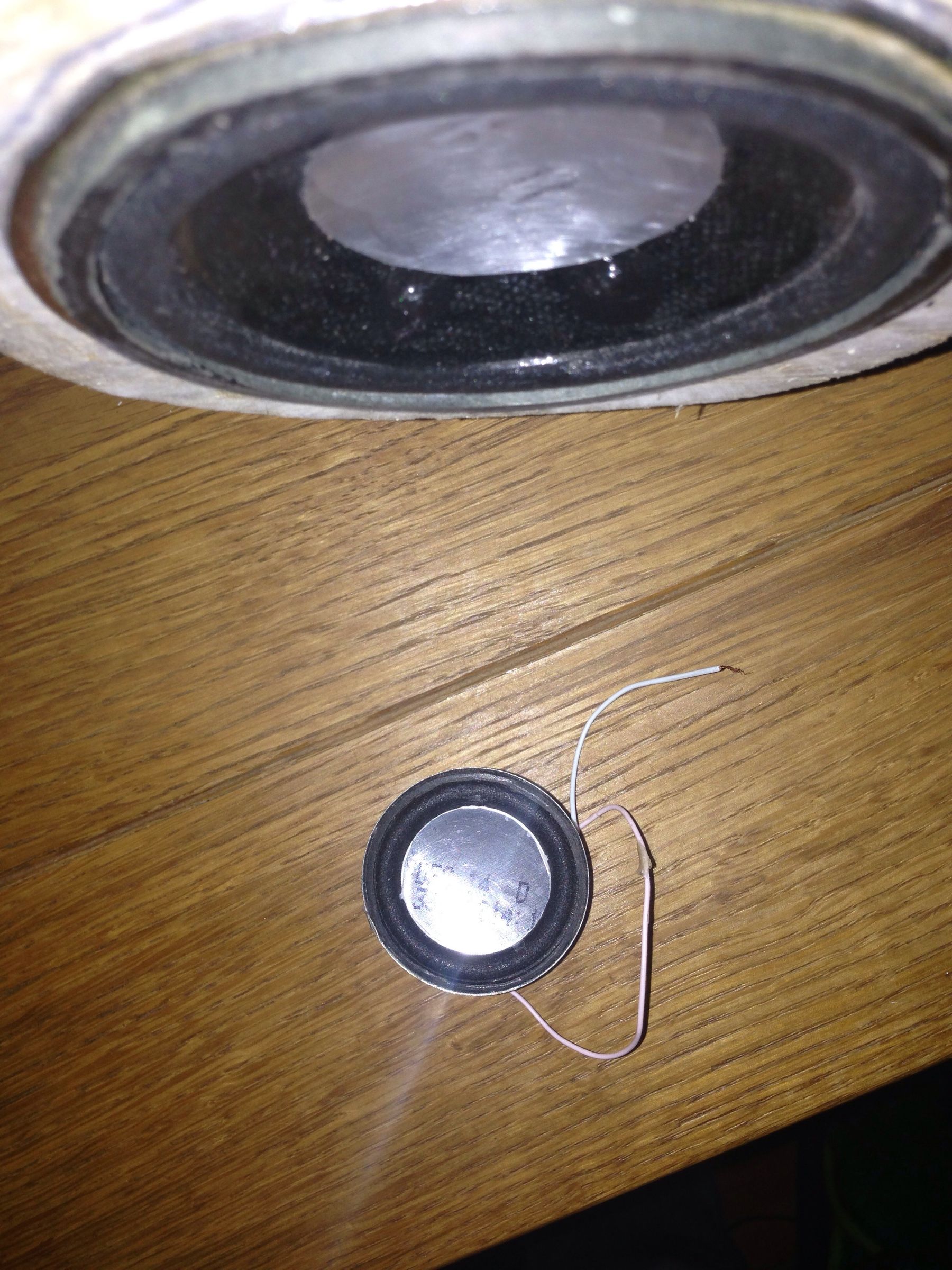

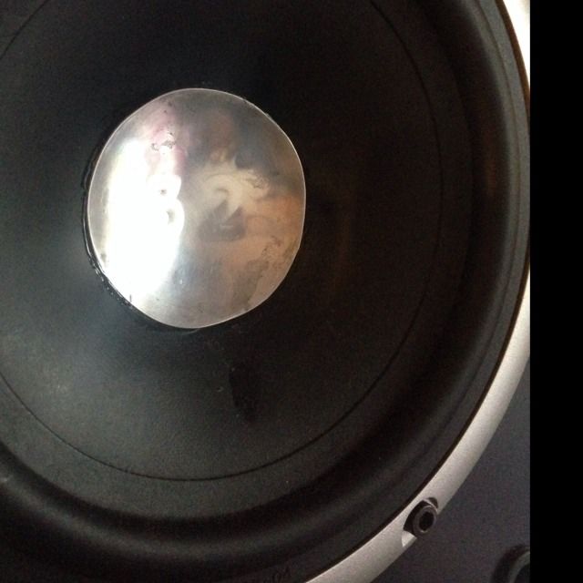

I drilled a hole through the back that was a tight fit on the speaker wire I pushed it through to the speaker hole and soldered it to the speaker. tied a knot in the wire before Hand to stop it getting pulled out again or pull on the speaker terminals themselves. I used 2inch speakers from old surround sound ones I have modified with two drinks can bases as centre caps other ible on here!
Step 5: Enjoy Separate Front Surrounds
So far these are great for vocals are clear and crisp with music and after a few weeks of drying they have not cracked yet the speakers are very tight in the hole and almost need pressed in I just put the speakers flat on a surface and put some body weight on the log to push it in?
I have not fitted terminals on the back and just have the wires going to a junction box as I did have them wired in series but have now just wired them in parallel as they sound more balanced with the rest of the system!
