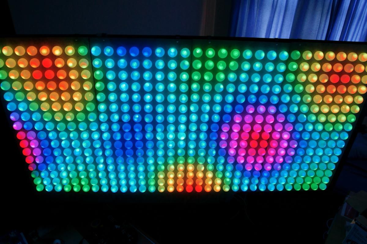

Step 3: Pixels
Thread the pixels through the holes drilled in the front panel, usually a snaking pattern is best. Make sure you note the data direction, by convention the male connectors are "in", but the lovely Chinese factories often ignore this. Many modules have a little silkscreen arrow on the PCB to indicate the direction. After you link all the chains together (they tend to be 50 or so pixels per strand).
Next you need to add the common ground. This bit is very important, and when done poorly can be the cause of many signal problems. The best way to get an idea is to look at the second picture. Get some THICK wire (important because voltage drop will affect both power and signal) and strip intervals (same as LED spacing) with a Stanley knife (roll the wire with the knife to cut 2 circles, then slice a vertical line between the two so you can remove the piece. Run this down the longest side and solder the ground wires to it (you will need to cut the ground wire between the pixels).
You then need to do the same for the Vs line. The best way to do this is to do the same thing AT THE OPPOSITE SIDE (maintain constant voltage across the LEDs, preventing colour distortions). If you are feeling lazy, you could just use the supplied power injection wires, but there is a significant difference if you do. If a job is worth doing, it is worth doing right.
