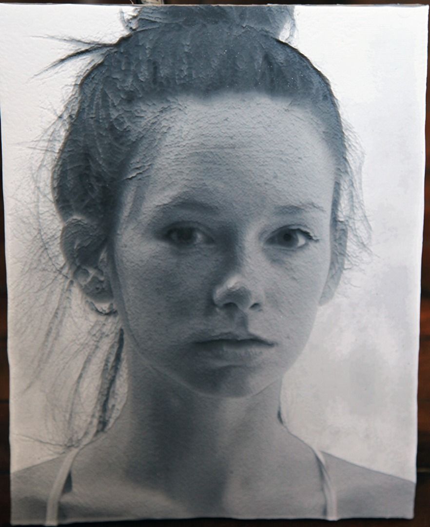

This Instructable describes how to machine an image into a slab of paint. The relief to be machined is developed from a photograph, where the brightness of each pixel determines the height of the relief. The slab of paint is made up of hundreds of coats of paint, forming a gradient from black to white. By machining the paint slab to different depths, different shades of gray are revealed, forming an image.

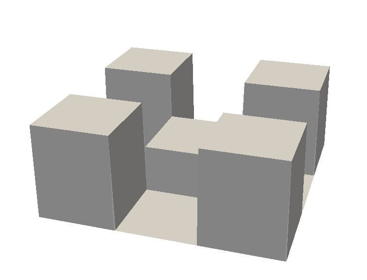

Before we can physically make anything, we first need to develop the relief model from the photograph. This is easiest if we start with a black and white image. A black and white image can be represented by a 2D matrix, where the indices are the pixel position. Each pixel has a brightness value, from 0 to 1, where 0 is black and 1 is white. The image below shows a simple matrix and corresponding image. The brightness value of the pixel at indices [2,2] is 0.5.
Now imagine that the brightness values are instead a height, where 1 is the tallest and 0 is the shortest. The matrix could be thought of as a set of xyz coordinates. For example, the coordinate for the pixel at [2,2] would be 2,2,0.5. Fitting a surface to these coordinates would result in following:

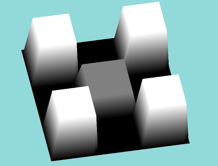

If you add a gradient to the surface, then when seen from above, this surface will appear to be equivalent to the source image.

Now that you have your substrate and your model, you are ready to program the machining operations. A relief at a reasonable resolution has a high polygon count, which eliminates some software packages, like CAMWorks and MasterCam, because the files are too big to handle. My image was 629x800 pixels, and resulted in an STL with just over 1 million polygons. I used Visual Mill for my CAM software.
I machined this as I would a soft plastic. The end mills to use depend on your image size and resolution. My CNC machine is a Roland 540. For roughing I used a ¼” ball mill at 12000 RPM, cutting at 30 in/minute. For my 11x14” image, the smallest ball mill I used overall was 1/8”. However, I used a 1/16" ball in areas of high detail. My machining time was around 12 hours.
If your CAM software can provide a color comparison between the simulated part and the model, this is helpful to check if your model will be machined with the desired level of accuracy. You can apply a black-to-gray color map, and see how closely the simulation matches the source image.
