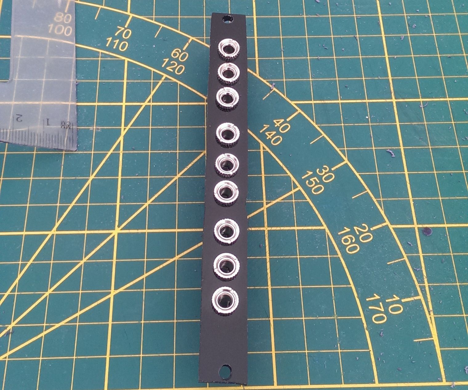

- Panel (I created one from plexiglass, 2 or 2,5 mm)
- Drill with 3M and 6M bit
- A cutting knife
- A perfboard
- A couple of sockets (I used 3 from thonk: https://www.thonk.co.uk/shop/3-5mm-jacks/)

- Place the potentiometers centred and in a way so they have some space in between them. Place the socket facing the same direction.
