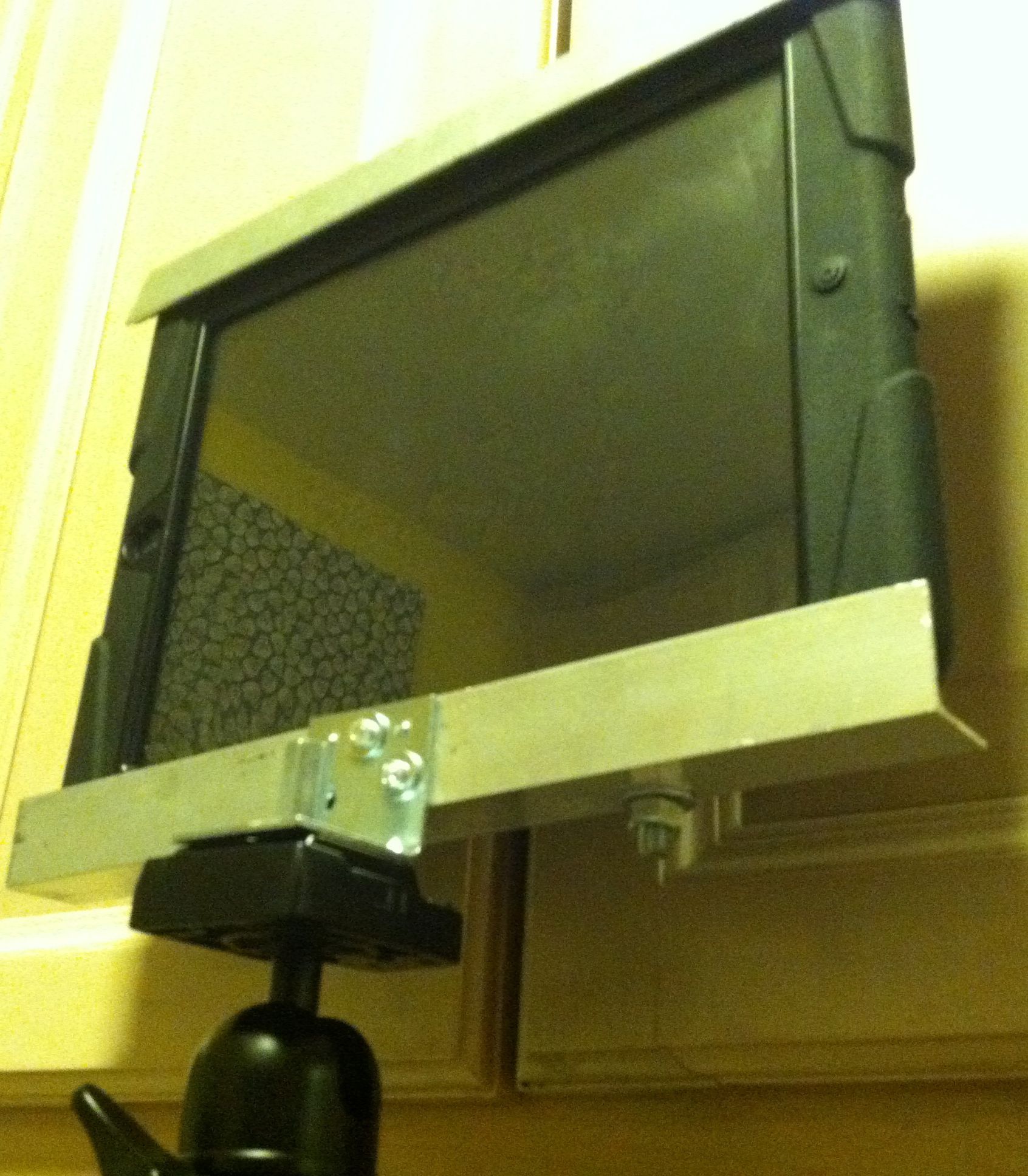

I found a nice piece of 1” plywood in my old man’s garage. After realizing my circular saw is piece of crap I ended up using one of his old hand saws and it was pretty amazing! Despite being ancient it cut almost as fast as the circular saw and the edge was quite a bit cleaner. The plywood I had was already sanded smooth on the top so I just sand the sides and bottom.
[Check out the drawing] Then I drilled two 1/2” holes along the 16” edge of the base for the threaded rods. Then I drilled four 1/4” holes for the nylon bolts which will hold up the glass. I countersunk the bottom of these holes and used the 1/2” paddle bit to countersink the top holes just deep enough for the nylon nuts to sit flush. Finally I attached the rubber feet to the bottom of the base.
Making the Boom
[See the green thing in the drawing] To figure out the length of the bracket to hold the camera I measured from the edge of base (between the two 1/2” holes) to the center of the base, subtracted the distance on my camera from the tripod mount to the center of its lens and then added 2”. For me this came out to 8.25”. That 2” addition is where you’ll be bending the bracket.
The flat bar of steel I had measured 36” in length. I cut it down to size using the cutting wheel on a Dremel and cleaned up the burrs using a grinding attachment. I center punched the holes and drilled them using the step drill bit (really useful for drilling holes in metal) and again grind the burrs out.
The steel bar seemed a bit beefy so I was worried I wouldn’t be able to bend it without a torch. I placed the steel in a vise and for one of the first times in my like my excess weight helped me out! Leaning into it I was able to get a decent bend creating a rounded-angled L shape.
With the extra steel I’m going to make a machete or a smallish Orc-sword!
Setting up the Column and Boom Adjustment
Using the Dremel cutting wheel I cut the threaded rod in half and cleaned up the burrs. Now I decided to go with two rods in order to keep the camera centered but I put them a bit close together and I ended up having to cut a bit off of the “wings” on the wing nuts that I planned to use to raise and lower the bracket. These nuts only go on one rod.
Bolting it All Together
Ok, so this is pretty self explanatory. At this point I bolted all this stuff together starting with the columns and ending with the nylon nuts and bolts (making sure they’re flush to the base). I tightened the column down hard until it was solid. I slipped one of the cut-down wing nuts, upside down, over one of the threaded rods, dropped down a washer and slipped the boom into the column. Then I dropped another washer and a right-side-up cut-down wing nut and tighten the boom down.
Final Stuff
So for the last part I used a hole punch to make some holes in the felt backgrounds. The idea is that those holes are for the nylon bolts to fit through. I glued a neoprene washer over the 1/4” hole to protect the camera’s finish and passed the thumb bolt through (with a few nuts behind it so I don’t damage the tripod mount by putting in a too-large bolt). Finally I popped two plastic caps on the ends of the threaded rods to finish them. The glass is simply rested on top of the ends of the nylon bolts.
Once you're ready to take a photo gently place your artifact on the glass (don’t forget a photo scale), attach your camera to the boom and snap some photos! I picked up a cheapish remote for my camera and it makes taking macro photos a bit easier as it keeps me from having to touch the camera which keeps vibrations down to a minimum.
