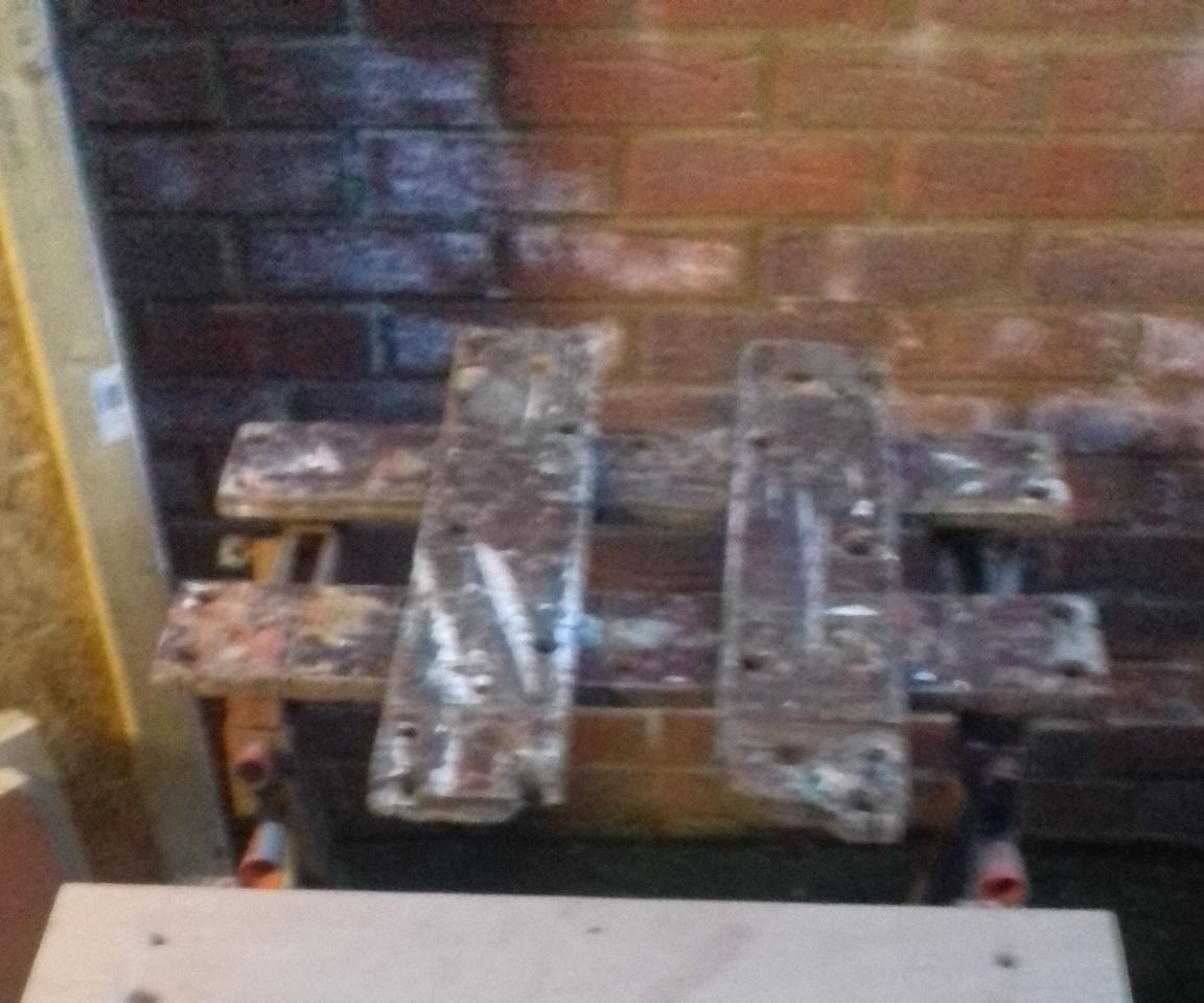

The saw was removed from the sole plate and the edge of the narrow side of the blade aperture marked, it was clear from looking at the blade guard this was apparent this was all that was needed on each side of the blade the distances from the blade to the ends of the guard were also measured. The sole plate and fence were then removed from the table board.
Using the blade slot as a reference the aperture for the blade guard was marked out. This could have been cut with a pad saw. Having a router I opted to use that. I set the cutter at the start point, then positioned the fence along side the router and clamped it down, I moved it to the end point checked the fence position and clamped it down, I was then able to use the fence to guide the router to cut the slot. This was repeated for the other edge and the ends cut free hand.
It was then just a case of reassembling the saw and bolting it back onto the board
