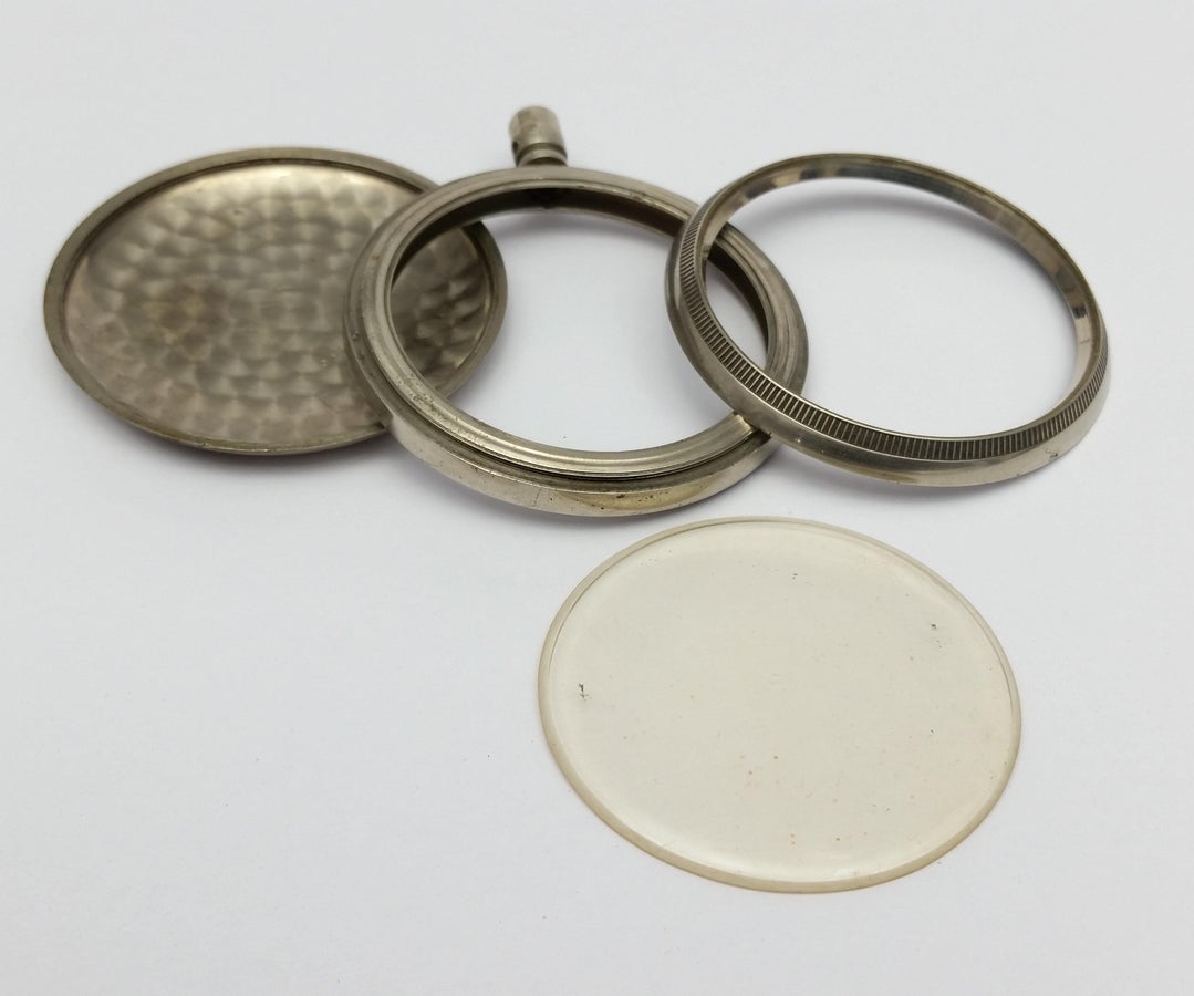

Now I needed to find a donor watch to salvage.

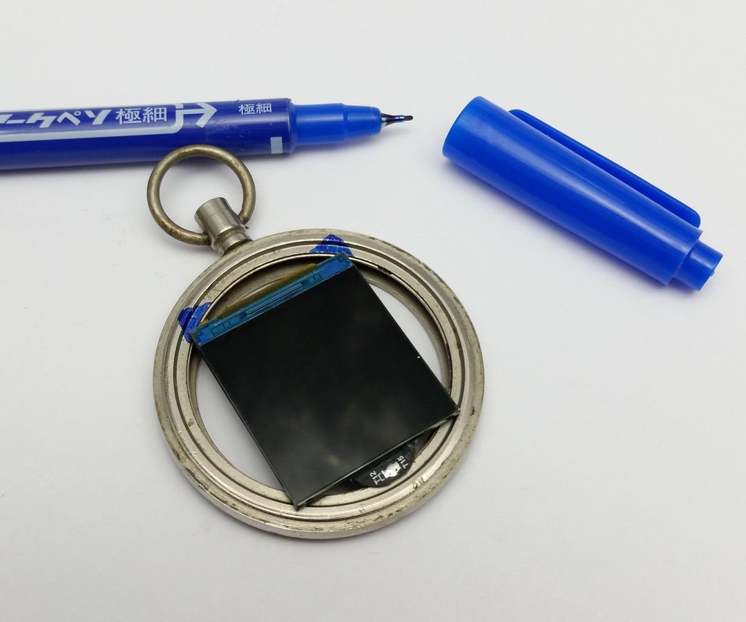

Rummaging through my box of broken pocket watches I was very glad to find that the innards of the D18 watch fit perfectly inside the most common ~42mm watch bodies, the only problem I encountered is that some watches had a thicker face bezel that got in the way of the screen corners, luckily they can be marked and filed away with a metal file without interfering with the front covers thread.
I looked for a watch that had a plastic dome instead of the glass as I wanted to tint it slightly darker and it also gives a bit more interior space compared the the glass covers.

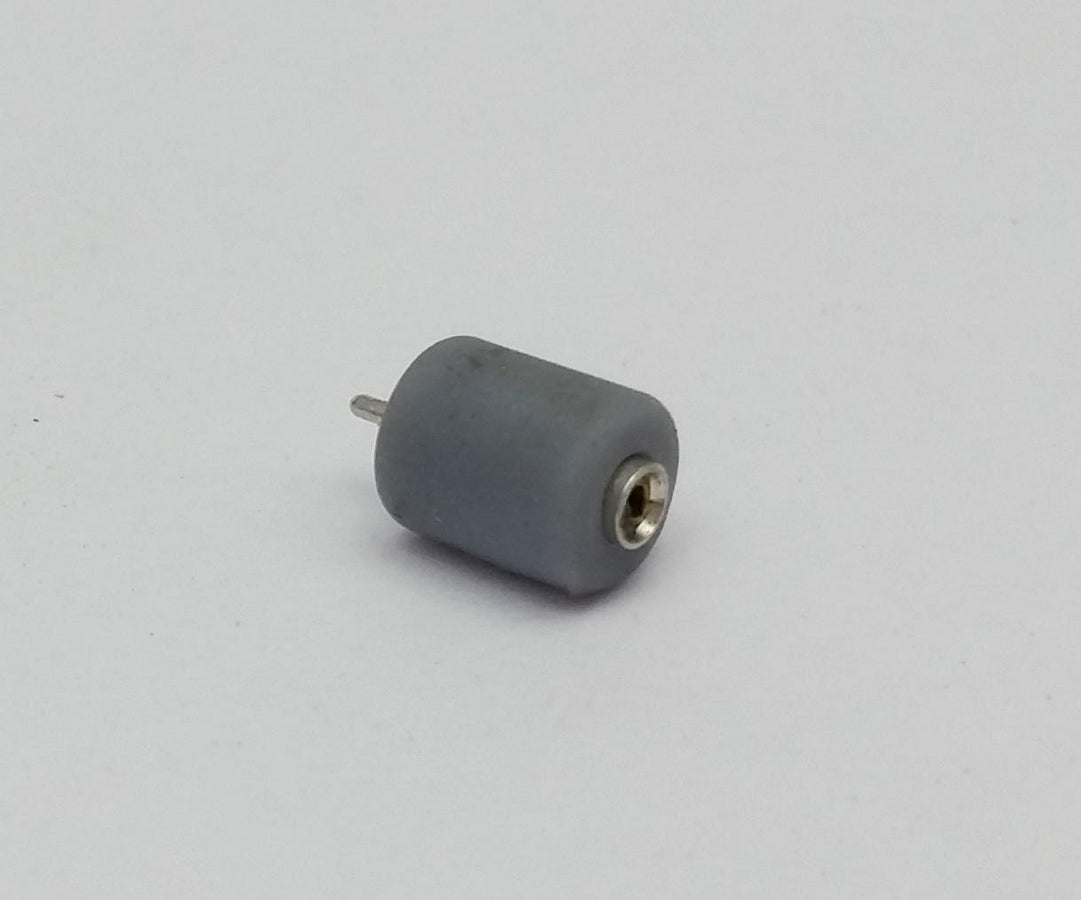

I used Pos DIP connectors for all of the connections in the watch as the are easy to use and create a secure connection. The charger presses the USB's negative against the body and a central male positive pin goes into the crown for the positive connection, the head is designed so that no shorts can occur when plugging in the watch and a insulating insert is inserted in the crown for the female positive terminal.

Starting with the female positive terminal that will go into the crown of the pocket watch, start by removing the plastic from one of the DIP connectors you will notice that on the small printed crown part the hole is bigger on one side insert the connector on this side and tap it in gently, it should be held in place by friction otherwise you can add a bit of CA glue with a needle point being careful not to get any in the connector.

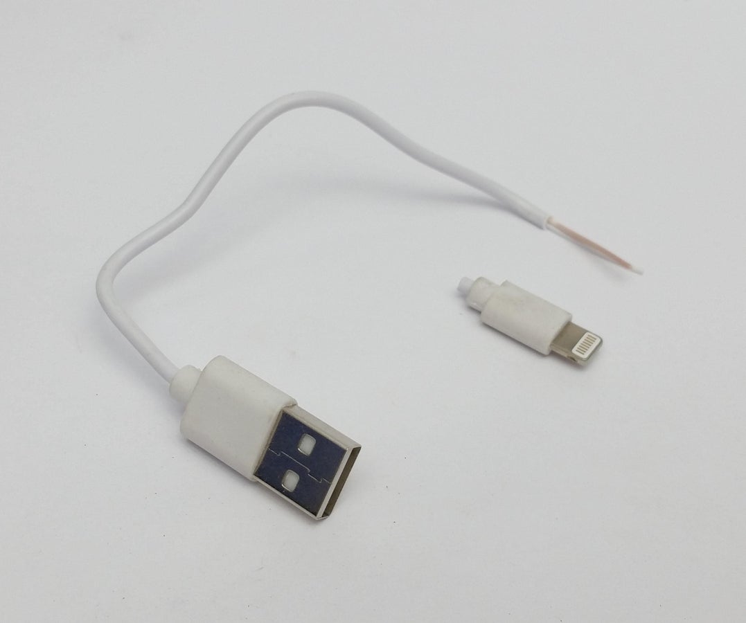

Now for the USB cable we will need the large USB type A side you can go ahead and snip off the opposite side of the cable. Removing the insulation will reveal two or four wires depending on your cable, if it's four we need the black and red and if it's two the negative can sometimes be white instead of black.
First feed the cable through the domed printed part then solder the negative/black wire to the copper wire and then the positive red wire gets soldered onto the female side of the third and final DIP connector and insulated with some heat shrink or tape.

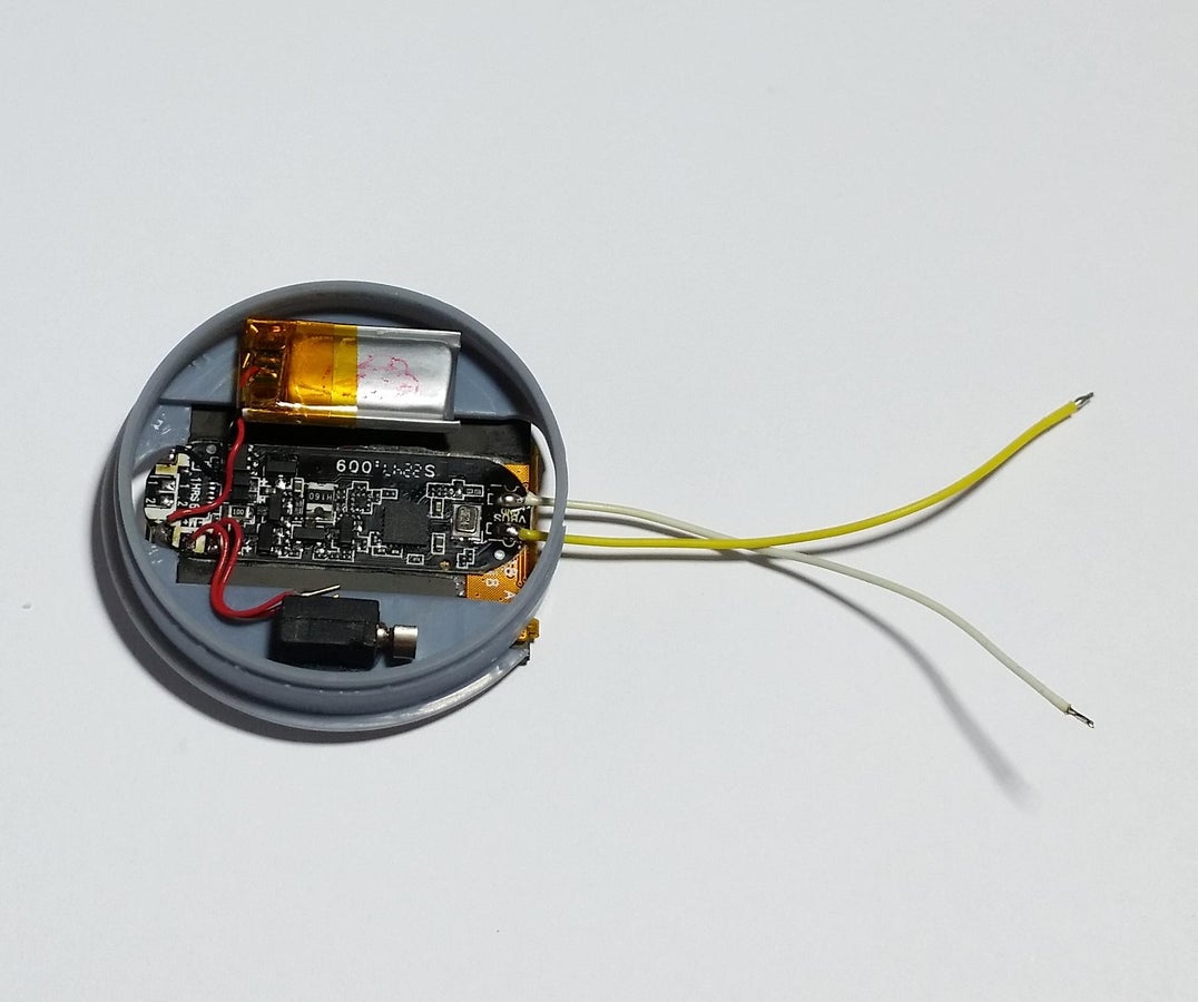

Next I re-soldered the battery and vibration motor along with two wires for the charger as pictured.
I removed the original touch sensor spring and soldered a piece of 0.7mm wire in its place.
We can now glue the screen in place on the holder and arrange and glue the battery and vibration motor to the back of the holder keeping everything as flat as possible.

Upon final fitting I noticed that the front cover of the watch catches the two top corners of the screen, to solve this issue I used a deburring tool to cut away some of the inner bevel of the lid until it cleared the screen.

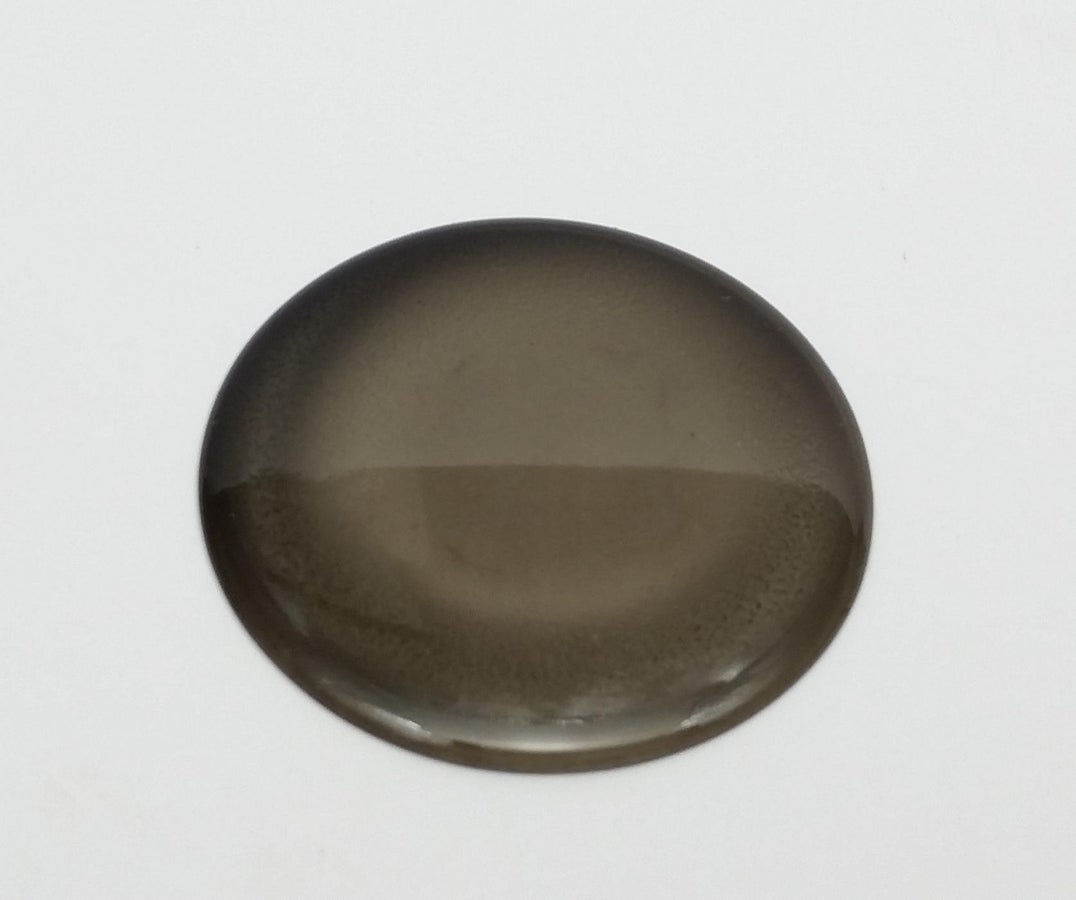

First we need to tint the original pocket watch lens to hide the screen when off. The easiest way I found for me to do this is to sand the lens with wet 400 grit sandpaper until evenly opaque and then spray it with clear coat with a bit of black paint mixed in. This way I can build up the coats until I get the desired tint.
You can also use window tinting film or even color the inside of the lens with a marker.
