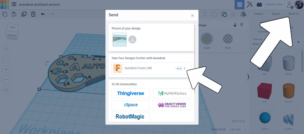

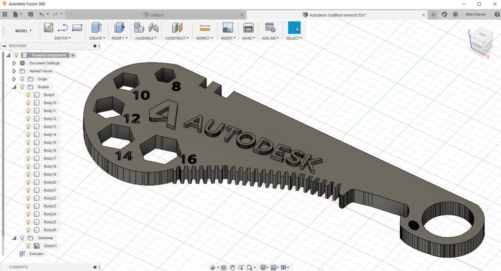

Optional export to Fusion 360 to continue the design with more sophisticated software.
From here we can 3D print this final prototype, or move it over to a more sophiticated tool like Fusion 360 and continue to tweak the finer details with a program that is more suited to take something from CAD (computer aided design) to CAM (computer aided manufacturing). More details on that in Resources section of the last step.
Model is Fusion 360, imported from Tinkercad.
