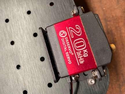

We’ll use a servo in this project to indicate emotion, by rotating the servo to a position that shows a happy, sad, or angry emoji.
To start, power off your rover. Wire your servo to the Pi by attaching the black wire to ground, red wire to an available 5V pin, and signal wire (often yellow) to pin 8. If your servo wires are attached to one another and the order does not match the pins on the board, you can use male-female jumper wires to connect them.
Step 2: Mount the Servo to Your Rover
Using the bracket you printed or purchased, attach the servo mount to the Viam rover so that the servo output spline is facing outward in the front of the rover (screws required, mounting holes should line up). Attach the servo to the bracket as shown here:
Step 3: Mount the Servo Disc to Rover
If you are 3D printing the servo disc, download the STL file and print it. Attach the servo disc to the servo by fitting it to the servo’s output spline.
