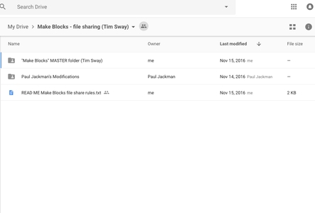

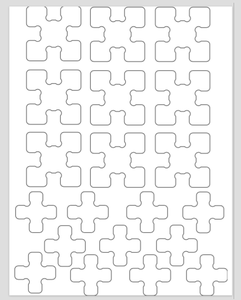

In the file share (https://drive.google.com/open?id=0B0o7W4Y8MocpUEVV... you will find my original SVG file of the pieces as well as any mods people have made, and a few text files with some helpful information.
I also made an 8.5"X11" printable paper template for those without CNCs to cut blocks out by hand. BY HANDERS NOTE: you can just cut 90-degree angles and ignore the circular fillets and rounded edges. those are only there for the CNC machines to be able to make the cut.

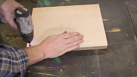

HELPFUL INFO! I created the file in VCarve for my small Piranha FX. I sprayglued a backer board under my material to help keep the pieces from flying free and screwed and clamped the whole thing down.
The shapes are based on 1/2" plywood. The plywood I used was actually .46" thick so the pockets and tabs are made to that size. Resize accordingly.
I did all my cutting "outside the line" with a 1/4" upcut bit. On my machine, they came out a little too tight for kid hands, so i adjusted the outside cut of the female pieces only X about -.0186" to make a slightly looser fit. Paul needed no adjustments on his machine. experiment accordingly before batching them out. But you CNC pros probably already know this. I had to waste a few pieces of plywood to learn :(
