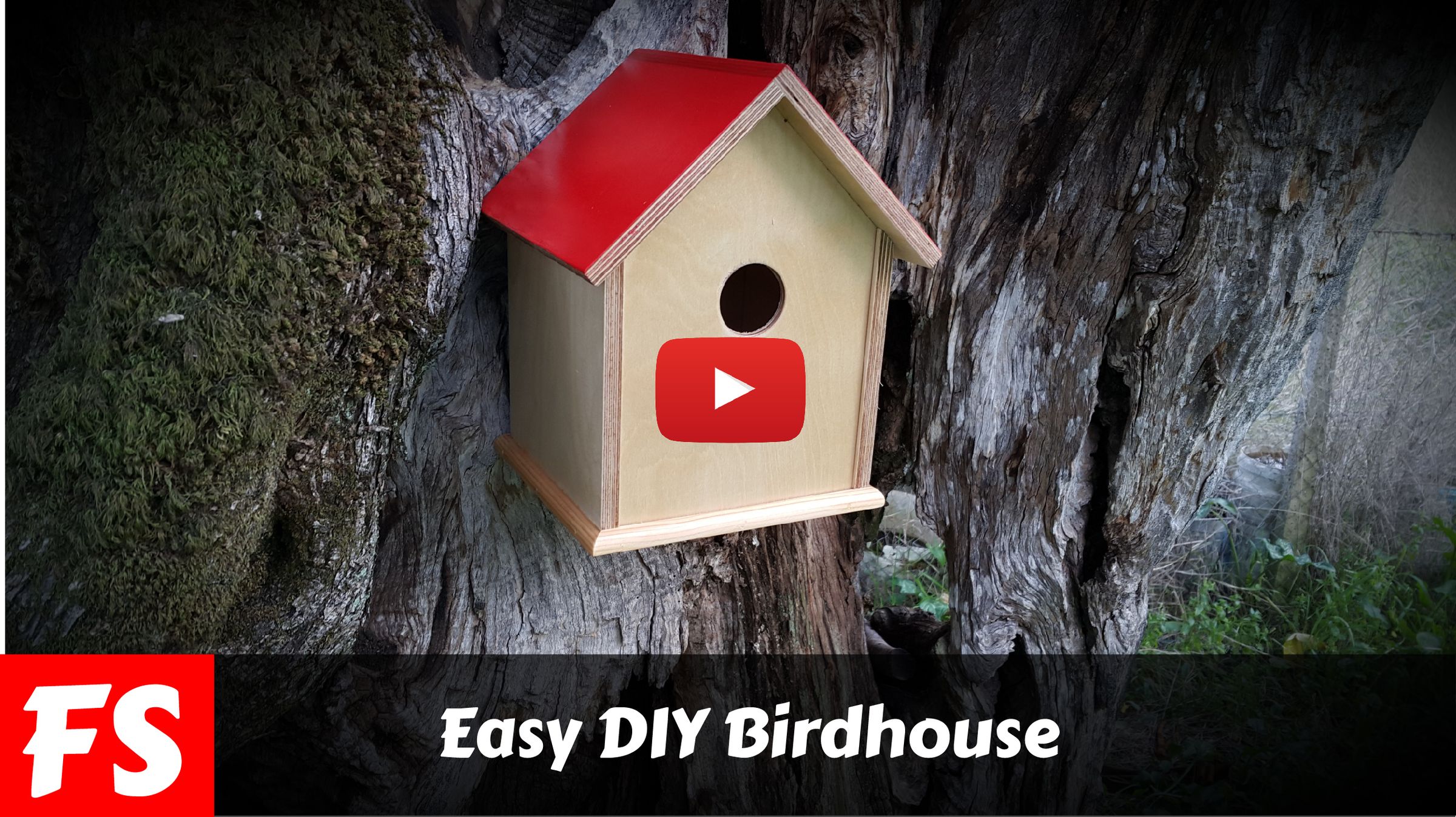

This is a video of the building process ,step by step:

Step 11: Finish
Paint your birdhouse the way you like it and also apply two coats of spray lacquer to waterproof it. Make sure that the paint and the lacquer are completelly dry before you hang the birdhouse on the wall or on a tree.!!
Have fun!!!!
