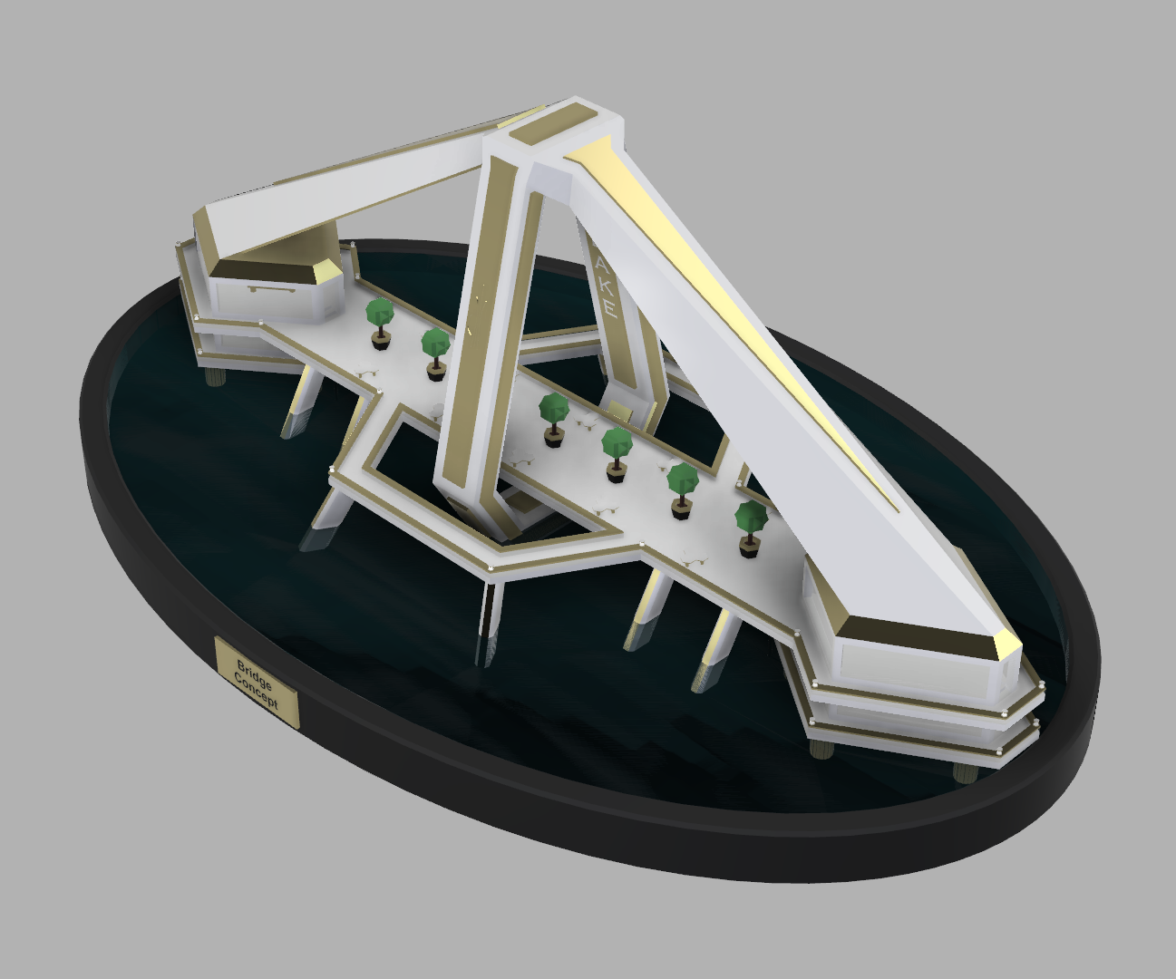

Step 3: The Design Process- TinkerCad
After gaining reference photos, I began modeling in TinkerCad. I won't explain this process in very great detail, because for this project, I mainly focused on Fusion 360, and not TinkerCad. For this model, I didn't focus on the details. I kept it simple, and allowed myself to spend more time with the other design. The 3D design still does feature the three parts of the flying car, which includes the ground module, the cabin, and the air capsule. But, it doesn't have an interior, or complex shaping. Using TinkerCad, I can design whatever I want quickly, just by stacking some shapes. This allows for quick prototyping, with simpler shaping. Although TinkerCad is easy to use, and allows for quicker modeling, it does not have all the features needed to make a detailed model. In Fusion 360, there is sketching, which allows the user to create any shape they want accurately. There is really nothing similar in TinkerCad to this, which is a large problem. I now realize that it is actually harder to make certain things in TinkerCad compared to Fusion 360, even if it is a simpler software to use. This is why i chose to dedicate most of my time to the Fusion 360 design.
Flying Car
Step 4: The Design Process- Fusion 360
This was my first large project that was first modeled in TinkerCad, and then modeled in Fusion 360, and it was a bit of a new experience for me. I had to figure out all the controls, and the many functions the software had to offer. The main one I used was sketching, which allowed me to sketch a 2D shape, and later on, extrude the shape to create a part.
Cabin:
I started off by uploading the first image pictured above into the software. Using the sketching tool, I traced an outline of the cabin, separating the different sections as shown above. Then, I extruded the different sections. I ran into many issues along the way. I had no idea how to do curved lines, and skipped those sections and did the straight edges. I later on figured out how to do the curved edges, and added that later. Also, I didn’t realize the many different sections I would need, so I had to restart many times. After I finally outlined the correct sections, I extruded them. Some needed to be smaller than others, and also be duplicated. After this, I had the cabin as a 3D design, with sharp edges, but needed to get rid of them.
Recently, I had a final project for school where we I used CAD, and designed a frame for a box. Throughout the design process for that frame, I got to explore many of the features that Fusion 360 had. I discovered the fillet option, where you could create a curved edge from an existing sharp edge. So, I did that to all of the cabin, except for the windows. After I designed custom lights using the same method, I proceeded with the ground module.
Ground Module:
Likewise, I used the same method to create the ground module, except for the wheels, battery, and motor. Those were also custom, and made with the shapes in Fusion 360. The wheels were quite easy, and were designed using cylinders with filleted edges. Then, I made the wheel covers. I started off with a circle in sketching, and then experimented with many designs. I decided to go with a three-point star, and extruded it into a cylinder. To replicate the curve in the wheel cover, I filleted the edges. The battery was made using a rectangular prism with chamfered edges. Finally, the battery pack was also made with a rectangular prisms, with many rectangular prisms cut out of it. Next, I proceeded with the air capsule.
Air Capsule:
This is where I started to drift a bit off course, and proceed with a different method compared to what I had been using at the start of the project. When I was browsing through the reference photos, it become clear that the arms holding the entire air capsule would be fairly difficult to recreate, especially for me. So, I decided to veer of course, and design the arms as thin pipes, with supports holding the pairs together. This was quite easier, and worked just as well. The large cylindrical structure holding the propeller was made using a cylinder with filleted edges. Speaking of propellers, they were made by sketching out a circle, and then extruding lines into piping shaped as triangular prisms. Finally, the last section to design was the interior of the car.
Interior:
Before I could even start the interior design, I had to work on hollowing out the entire cabin. Since it was extruded, the width was the same at many points, which meant that it wasn’t hollow. So, I used the glass portions to hollow out the main sections, and used parts of the armrest to hollow out the rest. Similarly to the air capsule, I also drifted a bit off course for the interior of the cabin. I didn’t really enjoy the look of the concepts interior, and wanted to make it unique to my design. Once Audi joined, the exterior of the concept was an all-white design, which I enjoyed more than the original color scheme. I felt that gold would match perfectly with the all white exterior, so I chose to do a white interior with gold and black accents. In terms of seating, I wanted seats that were more comfortable for passengers riding in the vehicle. I also decided that it would be quite difficult to design my own seats. So, I went on Thingiverse, and found a Recaro seat design, and used two of them in my design. One of the prominent interior features is the 49-inch curved display, which sits on the marble dashboard. The curved display was created using a curved line that was extruded. The marble dashboard was simply made of a rectangular prism, which had a cutout to hold to the curved display.

Step 9: How to Use Render Tool in Fusion 360
Steps to How I Rendered This 3D Model:
Notice: (You don't have to follow these steps to render your design. This is how I taught myself to do it, and it worked well for me!)
  1. Once you are complete with your model, go to the top corner labeled as "design." Click on the tab, and then click on "render." This should take you to the render workspace in Fusion 360.
  2. Next, open the color wheel labeled as "Appearance"
  3. Then, drag and drop certain materials to certain parts of the model. (Use Materials List Below)
Notice: (The next few steps are optional, and are not required for rendering. It is meant for people wanting to render with a custom background)
  1. After this, open the tab at the top left corner labeled as "Scene Settings."
  2. Then, go to your web browser (Used Chrome) and search for a website with HDR files
  3. After finding one, return to Fusion 360, scroll down until you find text labeled "Attach Custom Environment", and click on it.
  4. Once you click on it, it should open your file explorer and open download. Then, click on the file you downloaded as an HDR file, and click "Open."
  5. Then, it should eventually upload it to the scene, and it should appear in the render workspace.
  6. Finally, you are finished!
