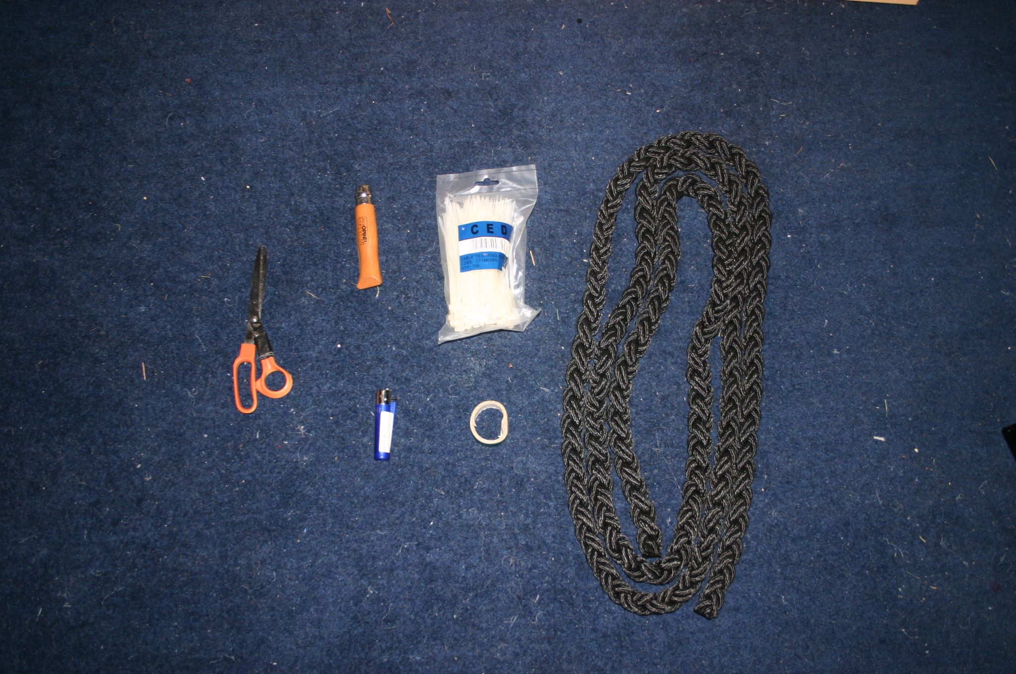

For this instructable you will need:
-A measuring tape
-A chain handle
-A marlinspike (or a skewer and pen)
-Silver pipe insulation (this should be pretty easy to find, failing that blue camping mat should do the trick)
-Foam football (these can be hard to find nowadays, inflatable ones are more common. If you can't find one, furniture foam can be used instead)
-Chord or string (Parachord/polypropelene builder's line etc.)
-Lighter
-8 or 10mm plastic chain
-A few inches of PVC pipe (not pictured)
-Duct tape (Not pictured)
