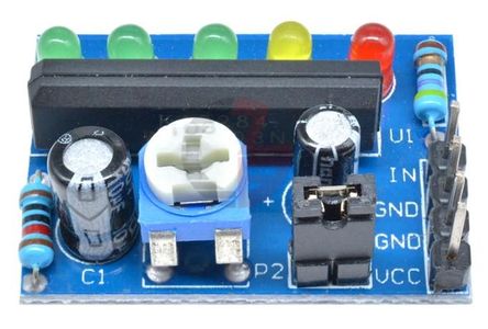

KA2284 module: The module has 4 pins. The supply voltage VCC for the circuit is 5V. The IN pin is connected to the output of your speaker and GND to the ground of your speaker. The potentiometer is used to control the sensitivity of the module.

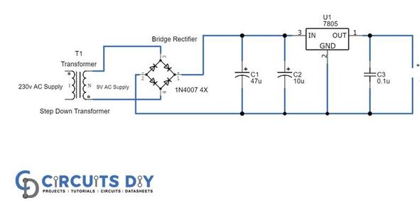

IN4007: 4 diode used in full bridge rectification mode for converting AC voltage from the transformer to DC voltage.
L7805: This is a 5V linear voltage regulator that steps down 12V from the transformer to 5V and supplies the module with the required power.
1K resistors: Used to limit the base current for the transistors.
1000uF capacitor: used to smoothen the rippled DC signal
47uF, 10uF, 0.1uF capacitors: used for the proper functioning of the linear voltage regulator. The circuit will still work without these capacitors.

Connect the Transformer with the 7805 as shown in the circuit diagram. Then power the module. Connect audio input from your speaker as shown in the diagram. Play some music and the lights should start dancing, adjust the sensitivity as you wish. Keep in mind to connect the ground of the circuit to the ground of the speaker. If it works then proceed to the next step.
