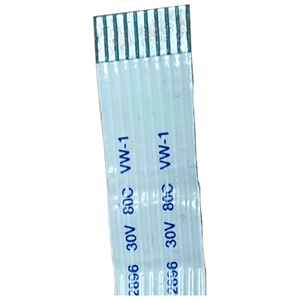

To do this I used ribbon cable (FFC) that has nine tracks with a 1mm pitch. It is the type you find in Flatbed scanners and printers.
At one end I used scissors to separate the cables. I just used the heat of the soldering iron to remove the plastic insulation when soldering the cables to the header pins. (plenty of flux)
I then set that end in UV Resin to hold things in place.

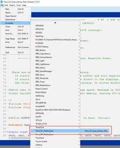

Step 7: Example Code
If the Library has been installed correctly:
In the Arduino IDE select "File" (top left). Select "Examples". Scroll to "Tims_I2C_Nokia_Eyes".
Select "Tims_I2C_Eyes_Library_Test"
This should open a new IDE window with the code to test the Nokia Eyes setup.
Upload it to the Arduino NANO or Arduino UNO.
If you look at the functions in the sketch you will get an idea of how to use the library.
