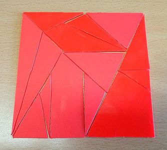

In this instructable I'm going to guide you on how to make the Stomachion template using only a pencil, a ruler and a compass, so you can make your own game set on any material you cannot easily transfer the template.

Now cut the pieces with no particular order.
Once you have them cut, you can start playing. You can rearrange the pieces to shape again a square...
