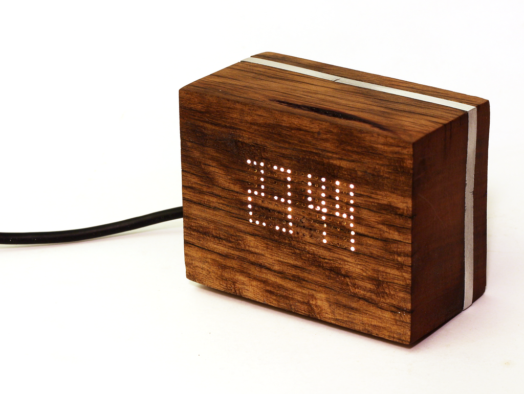

In this instructable I build a simple wood LED clock, using modern electronics components and traditional wood and metal working techniques.
I use a 16x9 LED matrix from Adafruit as a digital clock face, power it with an Arduino nano and use a DS3231 Real Time Clock (RTC) to keep time. I also show how to make the pretty reclaimed wood and aluminum box as the case. All with simple tools (plus small drill press). This is a fairly simple electronics build, I assume basic knowledge of Arduino and an ability to do some simple soldering. A good getting started Arduino tutorial is https://www.instructables.com/id/BLINK-LED-USING-A... and Instructables has lots of excellent soldering guides.

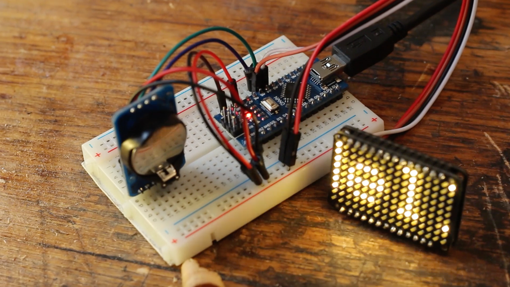

STEP 3: Build the Electronics and Upload the Arduino Sketch
Solder the LED's IS31FL3731 breakout board to the LED matrix, Adafruit has very detailed instructions on this here.
Using the above circuit diagram build the circuit using the breadboard. This circuit diagram can also be viewed here.
Install the Arduino sketch
The Arduino sketch can be downloaded here. Download and open it in the Arduino IDE then upload it to the Arduino. If all is working the 16x9 LED should be showing the time. If the time is incorrect follow this instructable to set the correct time on the RTC.
Your now ready to move on with making the box.
STEP 4: Preparing the Wood
I used a piece or reclaimed hardwood that ended up measuring 8.5cm by 6.5cm by 4.5cm, including the aluminum bracket. Saw the wood down to the size you want, then clean it up with a sharp hand plane or sand paper. It's now time to drill the grid of holes for the LEDs
STEP 5: Drilling the Grid of Holes for the LEDs
I lucked out with this project. An electronics perf board has holes placed exactly where the LEDs are. So choose a spot on the front you want the grid to be. Tape the perf board down and mask out a grid of 16x9 holes.
Now with the drill press and 1mm drill bit, very carefully drill out a grid of holes using the perf board as a template.

STEP 9: Finishing the Box
Drill 4 pilot holes in each corner of the back of the box and drill shallow counter sink holes with a larger drill bit. Screw on the back plate with some small wood screws. A little elbow grease is required to screw into the aluminum.
Sand everything smooth with p120 and then p320 sand paper. Finish the box with a finish of your choice. I used boiled linseed oil. Be very careful when applying finish on the grid of holes because you don't want to block them. I used a small amount of oil on a cloth and dabbed the oil over the holes.
You are now ready to mount the electronics.
STEP 10: Solder the Wires and Mount the Electronics
Use the above circuit diagram as a guide to what wire configuration you need. Solder together 12 wires in 4 'Y' configurations. I used female2female prototyping wires. Cover the exposed solder and wires with electrical tape or shrink warp. Reassemble the circuit without the breadboard and verify it's working.
Very carefully hot glue the LED grid to the bottom of the box. This needs to be done when the LED is on so you can make sure the LEDs align with the holes. I used some blue tape to help keep it in place while applying the glue. Insert the rest of the electronics in the box. Use the rotary tool with a grinding disk to grind out a small notch in the aluminum for the USB cable to pass through.
Drill some vent holes in the back plate, screw it back on and your done!
