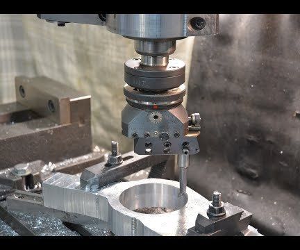

Sometimes a project gets made because the right materials and/or components appear, Such was the case with this hand tapping device, the construction of which forms the basis of this post. Except for the Irwin tap holders everything came from the scrap box (I prefer to call it the rainy day collection)
For quite a long time a hand tapper as featured here has been on my rainy day to do list but it had never risen to the status of do it NOW, That is until out of the blue it occurred to me that parts of my old Russian photo enlarger (from pre-digital camera days) provided most of the bits that I would otherwise have to make. I knew that it would come in handy one rainy day.
There are many ways to tap a thread but here we are concerned with hand tapping. The biggest problem with hand tapping is holding the tap square to the workpiece. There are various devices which can be made or bought to help in this area and the type of tapping machine described here is but one. It is suitable for many tapping jobs but not all. Often machines like this are made with a fixed frame which limits the height of the workpiece. I wanted a device which would handle a much larger range of jobs and that is what the old enlarger support offered.
The final step in this instructable links to a video of the process and the reader is advised to watch that.
I have entered this post in the "Trash to treasure" contest so if you like it please vote for it.
