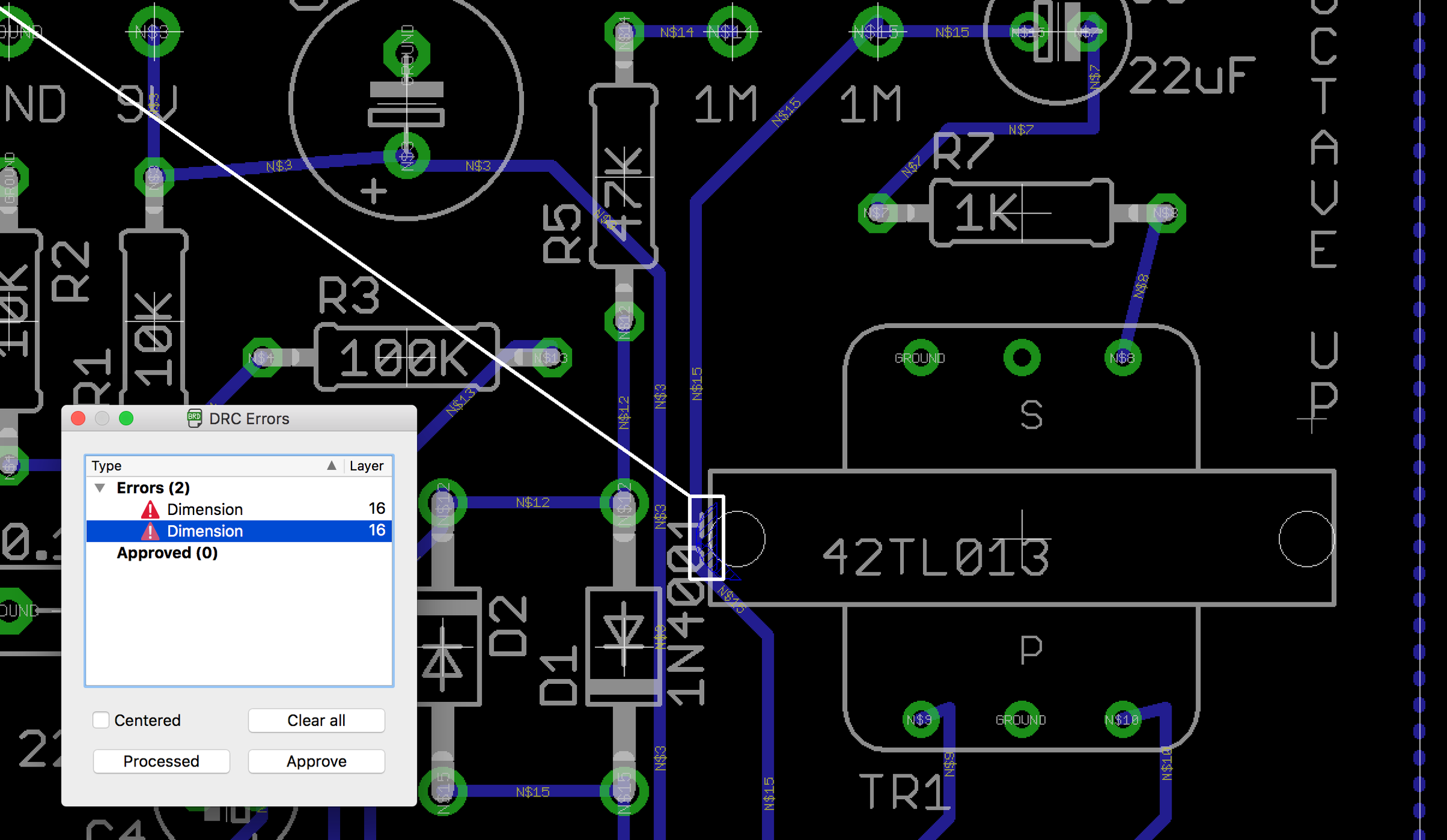

The second check is to look out for any glaring design errors. On the bottom of the left-hand toolbar we need to select the DRC button (Design Rule Check) which is basically just a button with the initials DRC with a check mark. Once selected, a new window should open. Click on the "Load" button and select "default.dru," and press "Open." You will then be redirected back to the original window where you simply press "Check." If all goes well, the phrase "DRC: No errors." will load at the bottom of your design window.
If all does not go well, the "DRC Errors" window will load with a list of errors. By clicking on each itemized error is will give an explanation what is wrong, and highlight on the board where the error is occurring. It is imperative that all of the errors are resolved before proceeding. Typically I don't use the check process in the error window itself. Instead, I exit out, make the necessary changes that it has indicated, and just run the DRC again (until the errors don't appear).

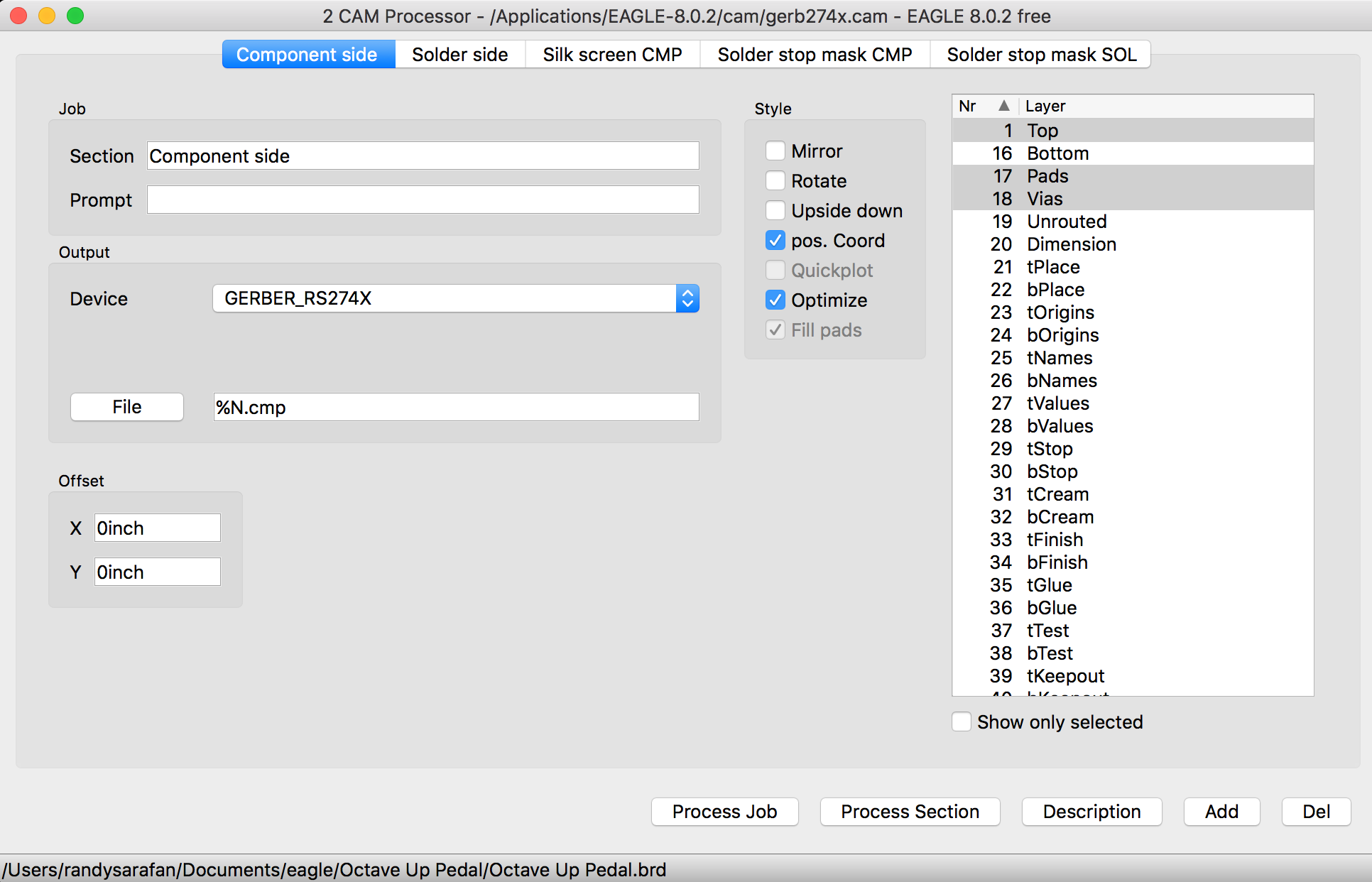

In the olden days (2016 or earlier), you used to have to open Eagle's native CAM processor and go through an elaborate rigamarole to generate gerber files. You still can do this if you want, but I don't recommend it.
Eagle's new process for creating gerber files is much more simple, and the one I will be using. It basically involves uploading the board to Autodesk Circuits, which is Autodesk's online hub for all things electronics. By uploading your board file here, all of the appropriate gerber files will be automatically generated.

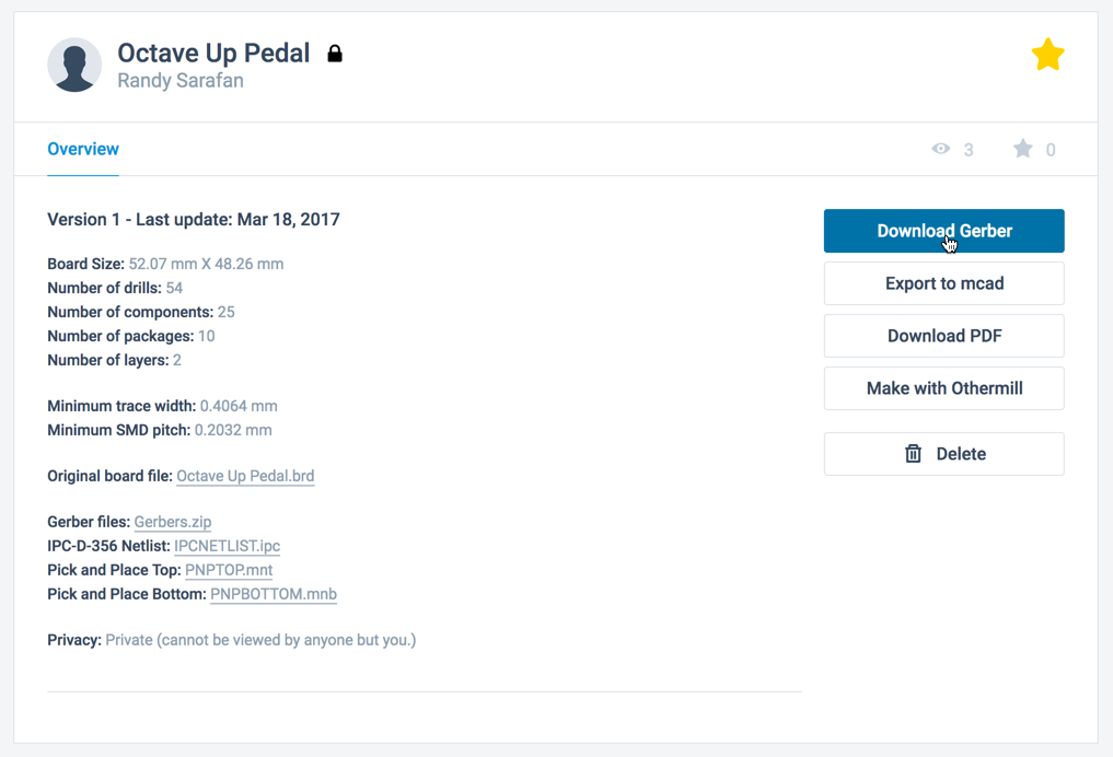

When you are sure they all look correct, scroll down the page and click the big "Download Gerber" button to download the zip file to your computer. This file is what you will be providing to the manufacturer.
If you want to take a look at my files, you can find them on the Octave Up Pedal Instructable.

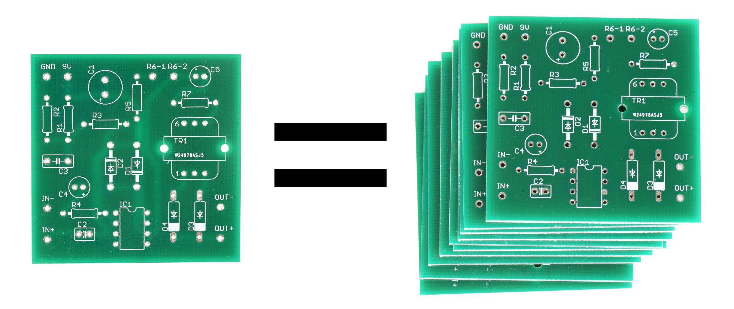

Another thing to keep in mind when working with low-volume production is the cost to make one might be roughly as much or the same as the cost to make ten. A lot of the initial charge is setup fee, and producing addition boards might be possible at little to no cost.
In my opinion you should always order more than one in case one is corrupted, you assemble it wrong, or there is a design flaw and that you need to debug. Five is a fairly safe number and not too excessive.
