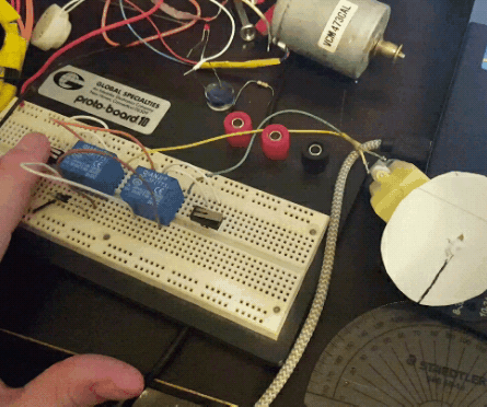

Here is a circuit I designed to be part of any number of projects. It is used to detect when an AC current is flowing and send a 5 VDC signal to another piece of equipment. It is a simple circuit that can be built with as little as five components.
There are many uses for the sensor. When used with a comparator, Schmitt trigger or optocoupler and a separate power supply, it can drive higher amp dc loads. It can also signal microcontrollers such as an Arduino, giving you even more possibilities.
For example, I am working on a project where I would like a shop vac to turn on as soon as i press the trigger on my mitre saw. when the trigger is released, I would like it to run for 5-10 seconds longer to clear all the dust. Another possible use would be to turn on a bathroom fan when the light is turned on, and off after a preset amount of time.

Parts needed:
1 Current transformer.
1 Full wave Bridge Rectifier or 4 diodes ( I used 4, 1N4007s)
1 Electrolytic Capacitor, 10uF
1 Zener diode, 5.1V (use any voltage desired, this determines the HIGH signal voltage)
1 1/4W resistor, the value should be high. Although it is a balance between switch time and sensitivity. Too high and the circuit may not turn off very quickly. Too low and the circuit may not sense a current at all. (I used a 10k, but on some low loads, the current was not high enough to trigger. maybe a 20k would be better)
Assembly is pretty straight forward. Just be sure to keep the correct polarity on the capacitor and diodes.
Look at the photos for a second schematic. It describes the use of a trim pot instead of a pull-down resistor. I haven't tested that circuit but if my theory is correct, you should be able to adjust the sensitivity with the trim pot.
To use the circuit, just feed the black (hot) wire on the AC circuit through the CT and voila, current sensing.
