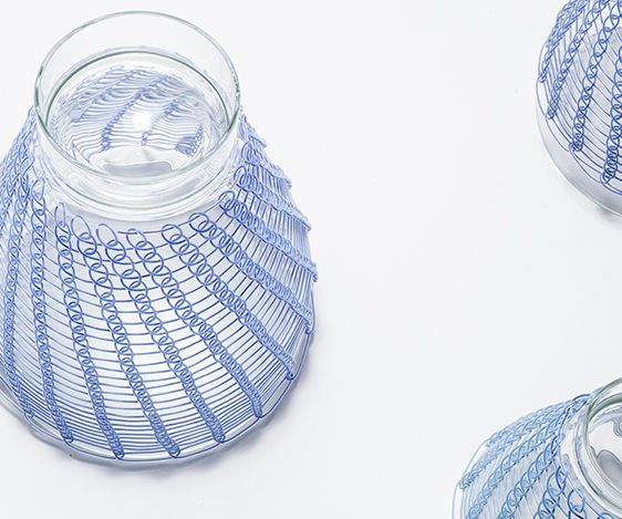

Matrix jig is a bending tool that allows for the iterative forming of compound curves. The jig’s interchanging parts can be customized into different combinations to create curves with varying dimensions. A collection of functional objects can be created through this process driven approach where the formal and aesthetic decisions are informed by a machine.
Conceived based on the combination formula, this mathematical approach to designing a tool as a physical algorithm helps to generate more possible combinations and provide a full spectrum of options. The idea is to embrace an equation that can exemplify creativity and then to interpret the various parts that are produced.

4. Use:
Experiment with the different combinations of compound curves that can be made using this tool. Experiment with materials to bend like ash wood, metal rods, acrylic rods, leather...etc.
