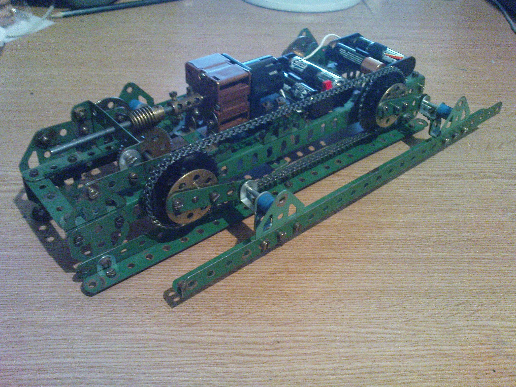

Step 5: Axles
These two axles are the main moving parts in the whole machine, they transfer the motion from the motor to the legs.
The parts needed are:
2x axle rods, part 15a
2x sprocket wheels, part 95
1x gear wheel, part 27a
You will also need a lengh of chain. The amount of links needed will become clear when you have both sprockets in place.
Make sure to get the gear wheel in the middle so that it will mesh correctly with the worm gear.

Step 7: The Worm Gear
This is the gear that transfers the power from the motor to the legs. It is quite simple, but involves a lot of setup.
For this you will need:
1x worm gear, part 32
1x axle rod, part 16
1x coupling, part 63
4x bolts part 37b
1x grub screw, part 69a
Begin by attaching the coupling to the gearing unit. This can be done with one bolt, but it's best to have two either side to help spread the load. Next slide the rod into the double angle strip at the end. Slide the worm gear onto the rod and attach the rod to the coupling with two bolts. Make sure the worm gear is in the right position and tighten up a grub screw into the worm gear.
Now this is the fiddly bit. The legs are quite hard to push up for the motor, but it will manage it, but only if the gear is placed correctly. The worm gear has to be as far apart from the gear wheel as possible, without slipping. To adjust the height of the worm gear, just loosen off the bolts holding the double angle strip in place, and tweak the fishplates up and down until you have the worm gear correctly meshing with the gear wheel.

First of all, make sure that the axles are correctly aligned in the middle. Then one leg can be bolted onto the side with the sprockets. This just bolts right up against the sprocket. The other side will need to have two washers per shaft, and one spacer, if you do not have any then just use more washers.
This should be it, the last thing that needs doing. There are a few places where you might come into trouble though, so I'll explain:
Rubber pulley collars - they may not be strong enough if they have been pulled on and off of rods a lot of the time, so you might want to replace them with metal brass collars instead. They have been fine for me, but I used rubber collars that were unused, so they fit tightly.
Motor stalling - this can be frustrating to have the motor not powerful enough to turn the legs. It happened to me and the most likely problem is that the motor is mis-aligned with the gearbox. This means that there is more strain on the motor and it just doesn't have enough power. If you loosen the bolt holding the motor then it should work. Tighten them back up when you have made sure that the gearbox and motor are aligned with each other correctly and straight.
Worm gear slipping - this also happened to me and is a problem. Try and adjust the fishplates holding on the double angle strip to make the worm gear mesh properly with the gear wheel.
