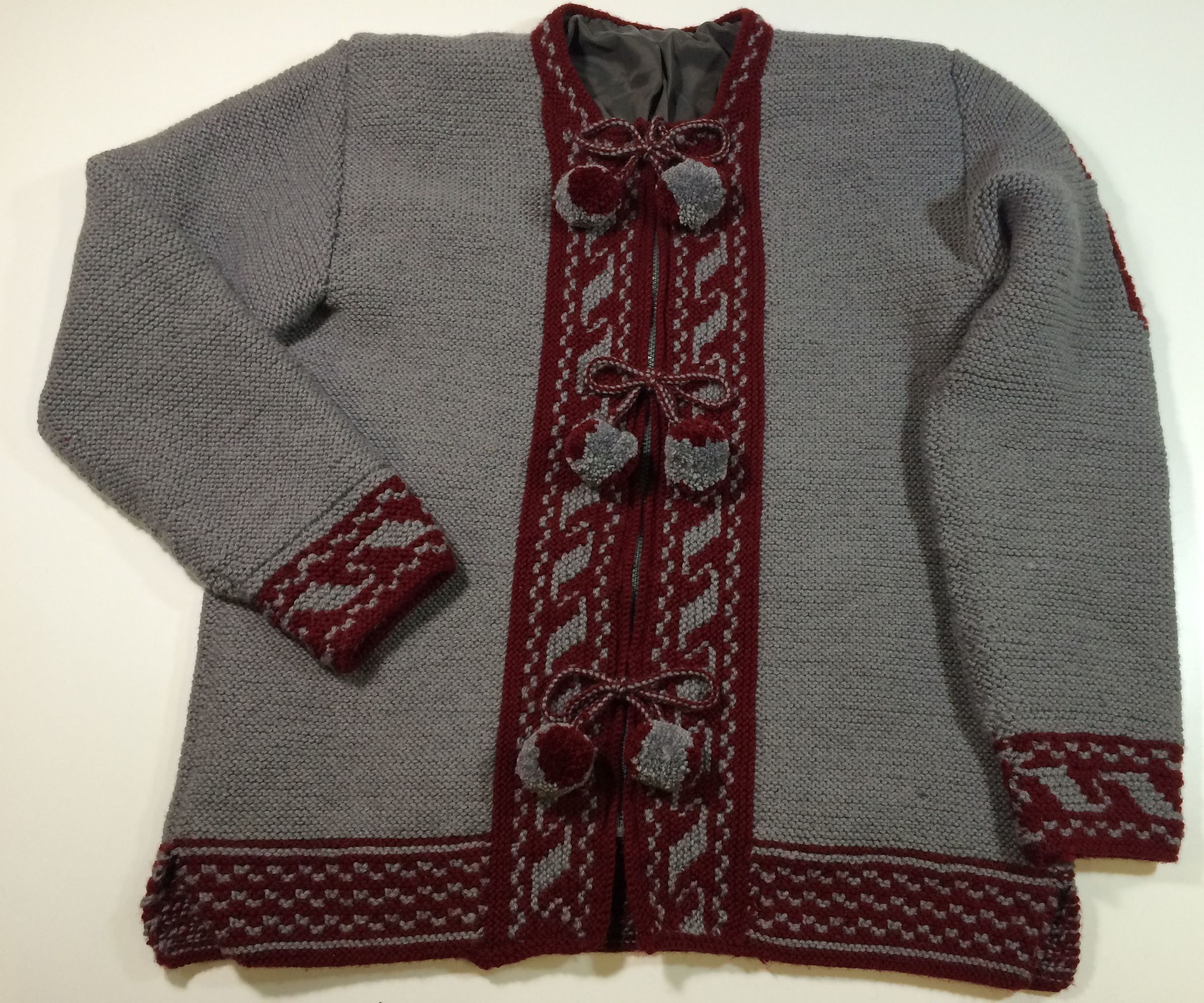

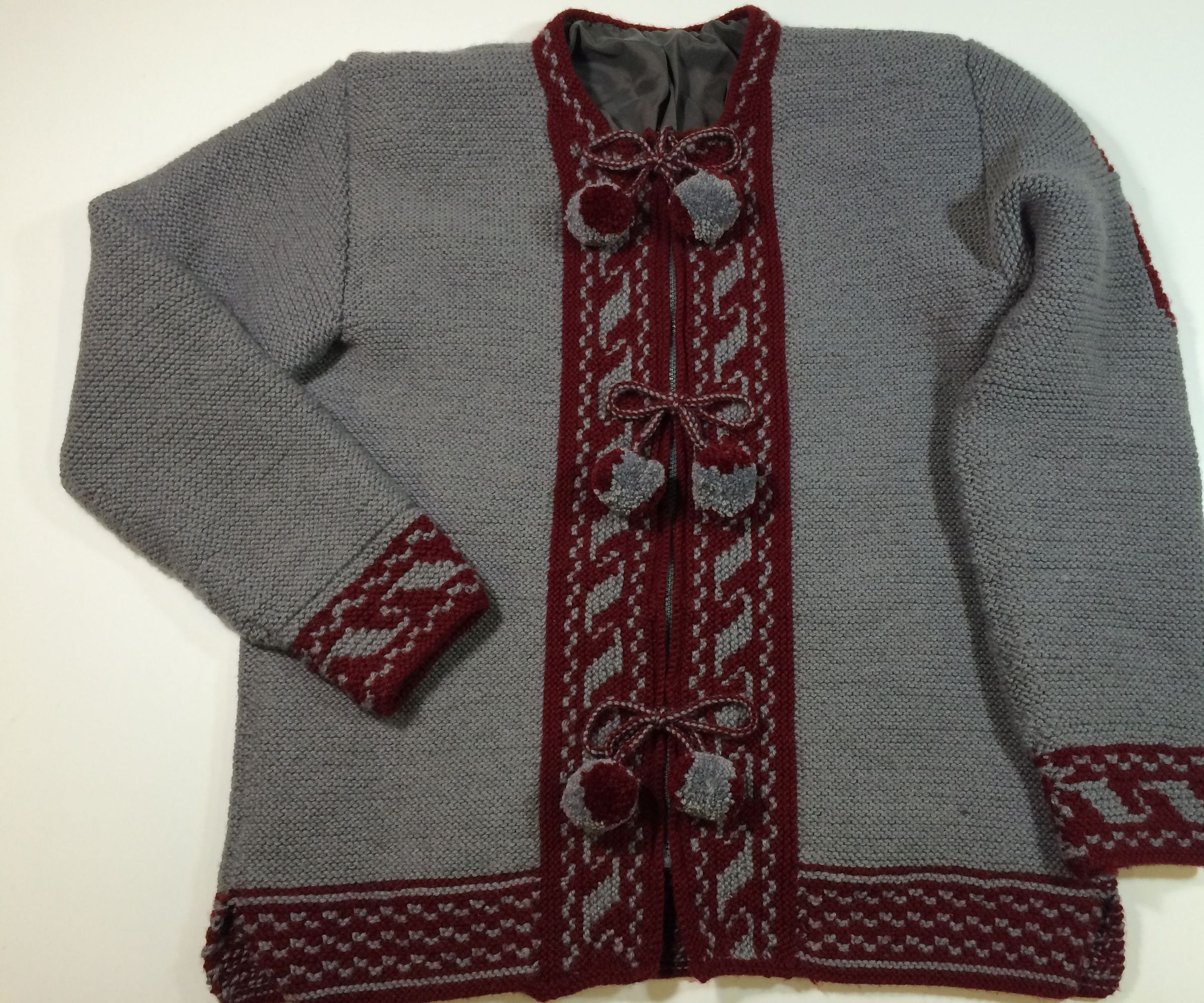

Step 1: Garment Presentation
As we have previous mentioned, the Mendigoizal is a traditional woolen coat garment knitted with two knitting needles.
The project we propose recuperates a twentieth century design that can be seen in the gown collection of the Basque Ethnographic Museum Bilbao.
With the collaboration Mari Carmen Boller San Martín and Lourdes Serrada Escudero, expert weavers with extensive knowledge and experience in making traditional knitwear. We will try to show you how the traditional Mendigoizal jacket is made

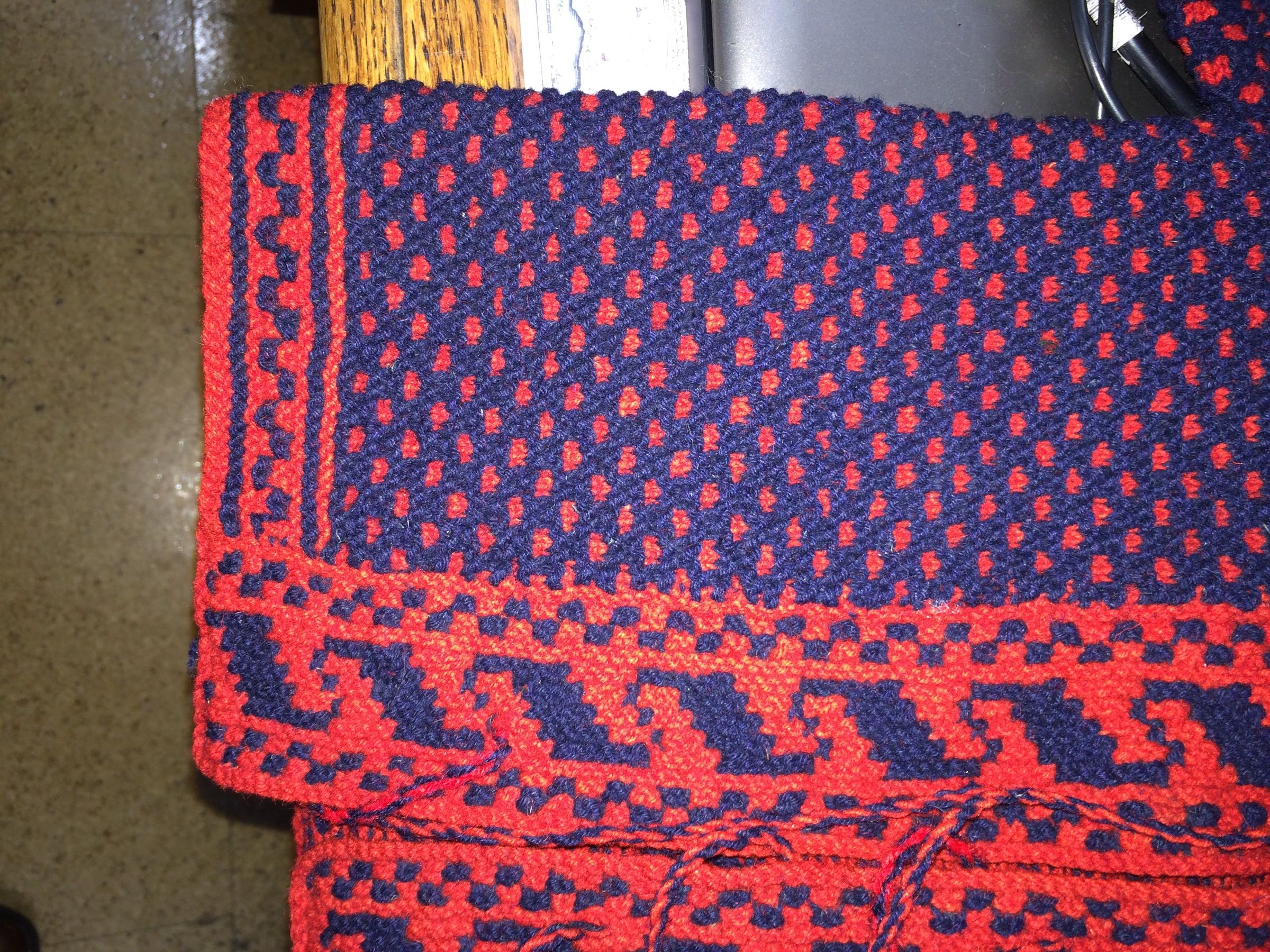

  • As for the stitches, two different ones are used for this project. On one hand the garter stitch is used through almost the entire jacket. On the other hand the bicolor Mendigoizal stitch we use for the geometry border design which is almost the same garter stitch but with a Jacquard stitch that gathers hanging treads from behind. Strands that are not being used are gathered up with alternate stitches creating a firmer weave. You can see it in the following videos.

Knit stitch Mendigoizal knitting, this is, Jacquard knit stitch picking up the threads that hang behind. The thread that is not being used is picked up behind so that the knitting is stronger. Example: 10 x 10cm = 22 knits eta 19 rows 1 row = one-way and return How to do it:
BACK:
Prepare 80k. - 85k. – 91k. with the contrast colour (red) Squared greek border:
Knit 2 rows (4 one-way and return) with the knit stitch.
3th row, base colour (blue)
4th row, contrast colour (red)
5th one-way-row, two knits with the base colour (blue) and two knits with the contrast colour (red), starting with the blue. Carry the thread in each knit (watch video). 5th return-row, take the thread in and out with the corresponding colour in each colour change (watch video)
6th row same as 5th row but starting with the contrast colour (watch video).
7th row contrast colour (red) 8th row base colour (blue)
9th and 10th rows contrast colour (red) Keep knitting with the base colour (blue)
