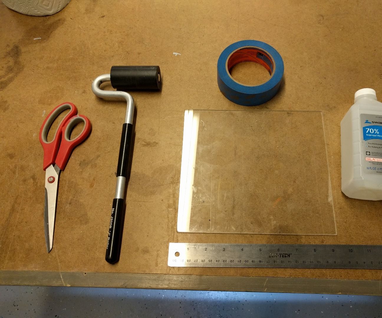

Step 1: Materials & Tools
- 1 Sheet of 1/2" thick MDF - 49" x 97". You'll use 2/3 of a sheet for each frame, so if you are doing 6 frames you'll need 4 sheets
- 1 Can of 3M Super 77 Spray Adhesive
- 1 Can "Dark Steel" Rust-Oleum Spray Paint
- 50' Roll of 4" Galvanized Flashing. You'll use 142" per poster.
- 260 1/2" #8 Lath Screws. You'll use 54 per poster.
- 3 8-32 1/4" T Nuts
- 3 8-32 Pan Head Screws
- 2 8-32 Washers
- 2 Picture Hanging D-Rings (Heavy Duty)
- 100 Grit Sanding Block
- Circular Saw or Table Saw
- 4' Ruler
- 1' Square
- Box Cutter
- Hammer
- Screw Driver
- Drill
- Nut Driver (Optional)
- Tin Snips
- J-Roller
- Two Sided Bastard File
- 5/8" Paddle Bit
- 3/16" Drill Bit
- 5/32" Drill Bit
- Black Sharpie Marker
