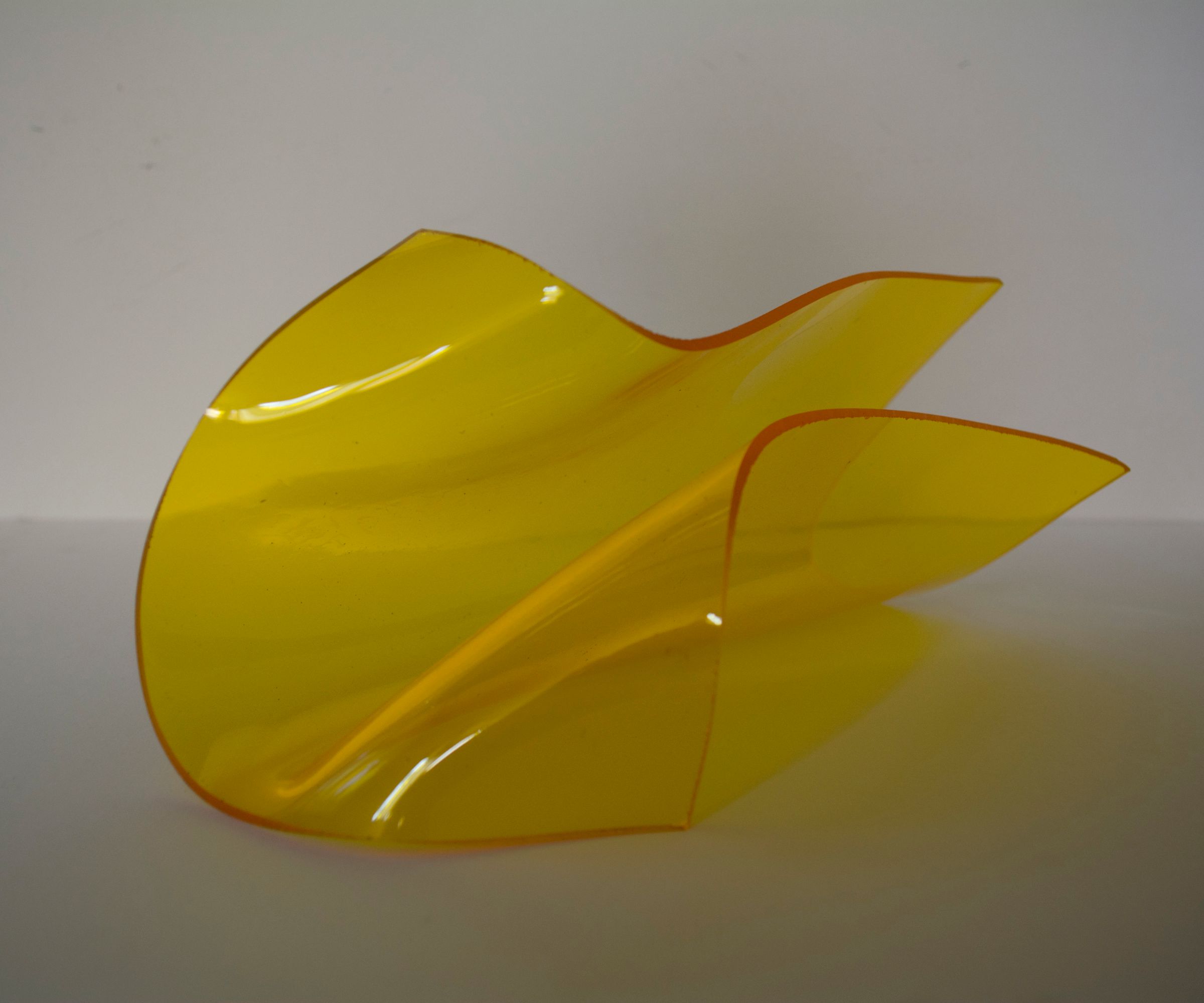

This bendable metal piece was created using a 2D drawing. The technique used is called kerfing, refer to Aaron Porterfield's study of different kerfing patterns. https://www.instructables.com/id/Curved-laser-bent-wood/

Reflections:
-I think inserting a gap is a great and simple way of achieving double curvature.
-kerfing metal has the advantage of staying in the shape you bend it to,
-but a kerfed wood piece may also achieve the same result if it is soaked in water then left to dry in its curved state. (I will need to do more experimenting with this). this is how I achieved the photograph of the wooden kerfed piece.
