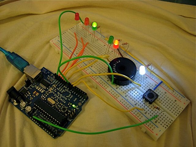

I am going to assume you already have the programming cable and software setup from the Ghetto project and jump straight into building the project.
Ok first we are going to lay a few things out connect the pins of the battery the the +ve and -ve lines, plug in the micro controller and the head pins.
To start with you will notice that there are 2 sets of holes running down both sides of the board each row down is interconnected up to the break in the middle of the board, effectively there are 8 strips running down the board. We are only going to use the inner 4 strips on the board. To make the top strips link with the bottom ones we need to connect them using a jumper wire. You can see the orange wires on the image below they are joining the top and bottom.
Now place the battery on the board at the bottom as close to the edge as possible and work out where its pins will rest, ensure the +ve and -ve pins are on different sides of the central divide. Using the a longer jump wire connect the pins to the +ve and -ve strips. (Notice the yellow jump wires in the image below). They are connected because the rows are connected across up to the central divide (this is different to the way the power strips work which are columns not rows).
Ok Now at the very top right of the board push the header pins into the board it should use rows 1-5 then two rows down (8) insert the microchip so it bridges the gap over the centre.
Ensure the micro controller is inserted correctly (the dip/cut semi circle should be nearest pin 8 on the breadboard).
Step 3: Wiring Up the Micro Controller
I used my own wiring for the header pin so make sure you connect your parallel port pins to the right place on the micro controller. (Just follow the instructions on the Ghetto project).
Once its wired up you should have some thing like this... If you do not already have 1k resistors on your programming cable ensure they are installed on your board to protect the parallel port on your computer from being fried.
Step 4: Installing the LEDs
Before we begin ensure all LEDs are connected the right way around. The short lead goes into the -ve supply the long one goes into the micro controller (+ve).
Also ensure you use the 150ohm resistors on the LEDs lay them out as below.
I have jumped the centre divide with resistors and put the -ve pin directly into the -ve rail so that I create a circuit, you could alternatively solder the resistor onto the long wire coming out of the LED.
Step 5: Buzz
Ok in the same way that you connected the LED's add the buzzer you don't need a resistor however if you find the noise annoying a 150ohm resistor will reduce the volume a bit.
Step 6: Inputs and Outputs
In this step we are going to connect up the outputs to the appropriate pins to get you going.
There are 6 LEDs and 1 buzzer as outputs and 1 button as input. Thats 8 pins on the chip. The best way to deal with this is to connect all the LEDs except the white one to the right hand side of the chip to ports PB0 - PB4 (see diagram)
The white LED will be connected to PD4 and the buzzer to PD3. Finally the switch will be connected to PD5.
Step 7: Home Run
Now you have it all wired up, if your microchip is still programmed from the LED flashing Ghetto project you will probably notice that the white wait LED is flashing on and off. This means its all working.
