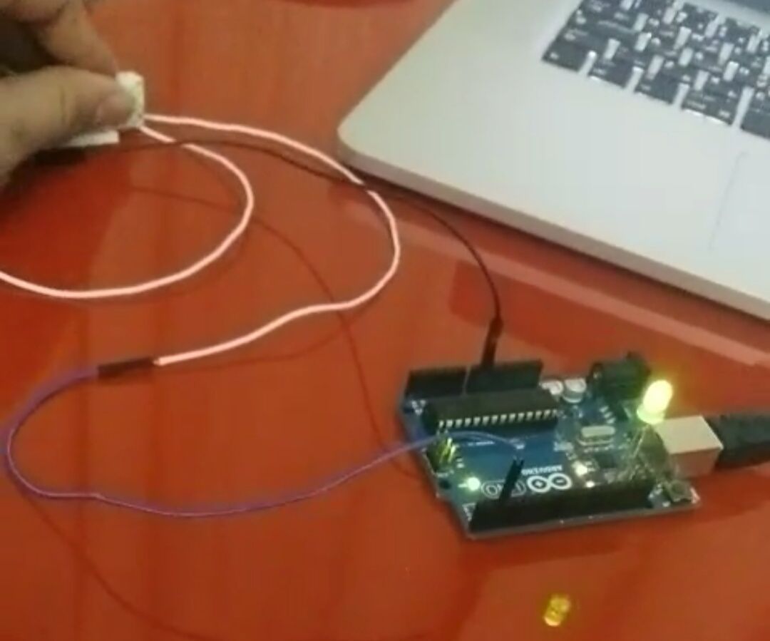

Hi all, This is my first i'ble and I'd just ask you to please be patient with me if I'm not as clear as experienced users. On to the making, I needed an LED Tester to to check which color it was, if it was infrared, or if it were working. I have a very large range of LEDs kinda lying around which require different voltages so I needed an LED Tester which would work two batteries. For me the convenient ones were a 3V button cell and a tiny 12V battery. You may use any kind of battery you prefer as long as they fit in your casing and can power an LED. Let's get started.

After some soldering, it is time to put it all together. Connect one wire, which is soldered onto the end of the switch, to the positive of one battery and the opposite wire of the switch connected to the positive of the other battery. Then put the female port soldered onto the switch through a hole in the casing. Put the negative female port through the other hole, while the switch is placed in the larger hole.
Step 7: Close It Up
Once your done, shove the wires in there and make sure everything fits and finally close it. I used a sharpie afterwards to label the switch and female ports.
Ta-Da!
