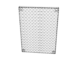

Step 1: 3D-print the STL´s
You will need a bottom, a lid and a powerbutton, you can find everything here or at thingiverse:
https://www.thingiverse.com/thing:2374637
I printed it at 20% honeycomb-infill PLA.
I used Support for the minibottom part, the other ones no support.

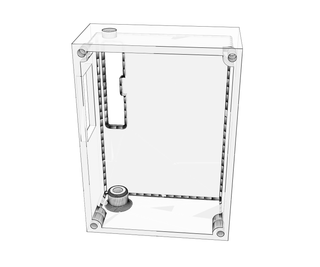

Step 4: Assamble
First insert the 3D-printed button, then the PCB and battery holder.
Step 5: Glue
Make sure everything works and glue everything where it belongs.
Step 6: Lid
Put the on the buttom and tight the 4 x M3 screws 10 mm.
