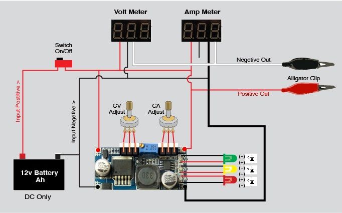

Step 5: The Ammeter
You may wonder why I dedicate a whole step just for the ammeter. There are two reasons:
- I could not find any decent info on how to connect the ammeter, so I blew up the ammeter and had to wait for weeks for another one from HK.
- The ammeter needs modification so it can be fitted to the box.
Let's explain further:
- This ammeter is very sensitive and it will fry instantly if wrongly connected. The ammeter has 4 wires, 2 thin and 2 thick wires. The two thin wires (black and red) are power input, black = negative, red= positive, nothing too complicated. This is the bit where you need to be careful: The 2 thick cables (black and white) are black= negative in to ammeter, white= negative out of ammeter. Make sure you connect the cables right. It may be a good idea to try the accuracy of the ammeter before mounting it to the box.
- The ammeter has a resistor shunt (or at least that’s what I think it is), on the front of the PCB, this shunt is coming out even more than the 7 Segment LEDs, making it impossible to mount on the box. To solve the issue what I did is desolder the resistor shunt and resolder it to the back of the PCB.
Do not connect the small black wire if you are powering the ammeter from the same source to be read like I did. Otherwise it will give you a wrong reading.
Step 6: Schematic and Soldering
Here is the schematic, it’s very simple really.
- Use servo wires for the potentiometers, and with electrical tape or some heat shrink cover the solders. The same is done with the LEDs. See the photo for the “polarity” of the LEDs on the PCB I used.
- After soldering everything, it’s time to fix the meters to the box. Secure them with hot glue, but not too much just in case you need to replace them in the future.
