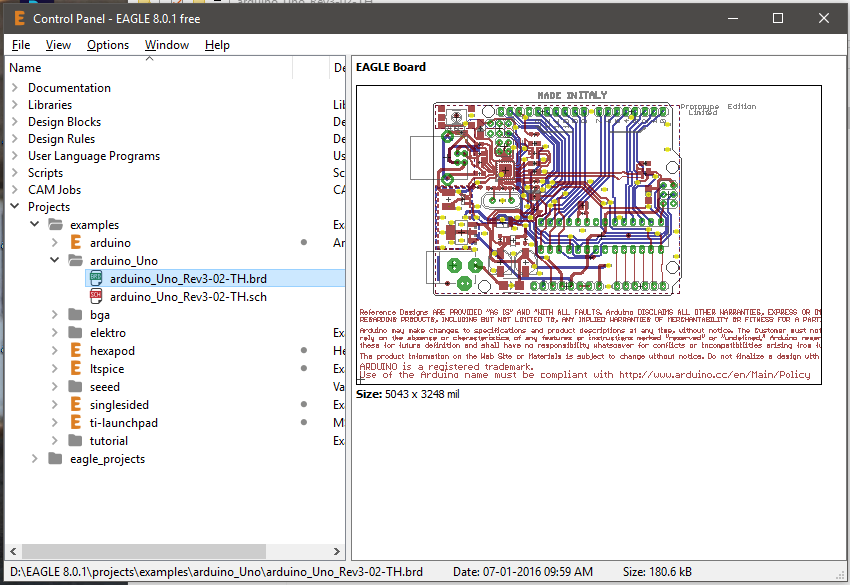

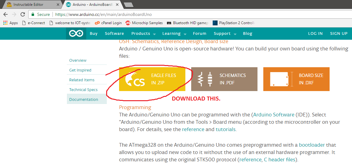

As I mentioned in the Intro, It's based on the arduino Uno board. So the first thing we'll do is to go to THIS website to download the source PCB file from the website.
download the eagle files as shown in the following picture.
Extract and copy the folder to your eagle projects directory. by default, it's located as $USER$\documents\eagle\
Now open up EagleCAD and navigate as follows.

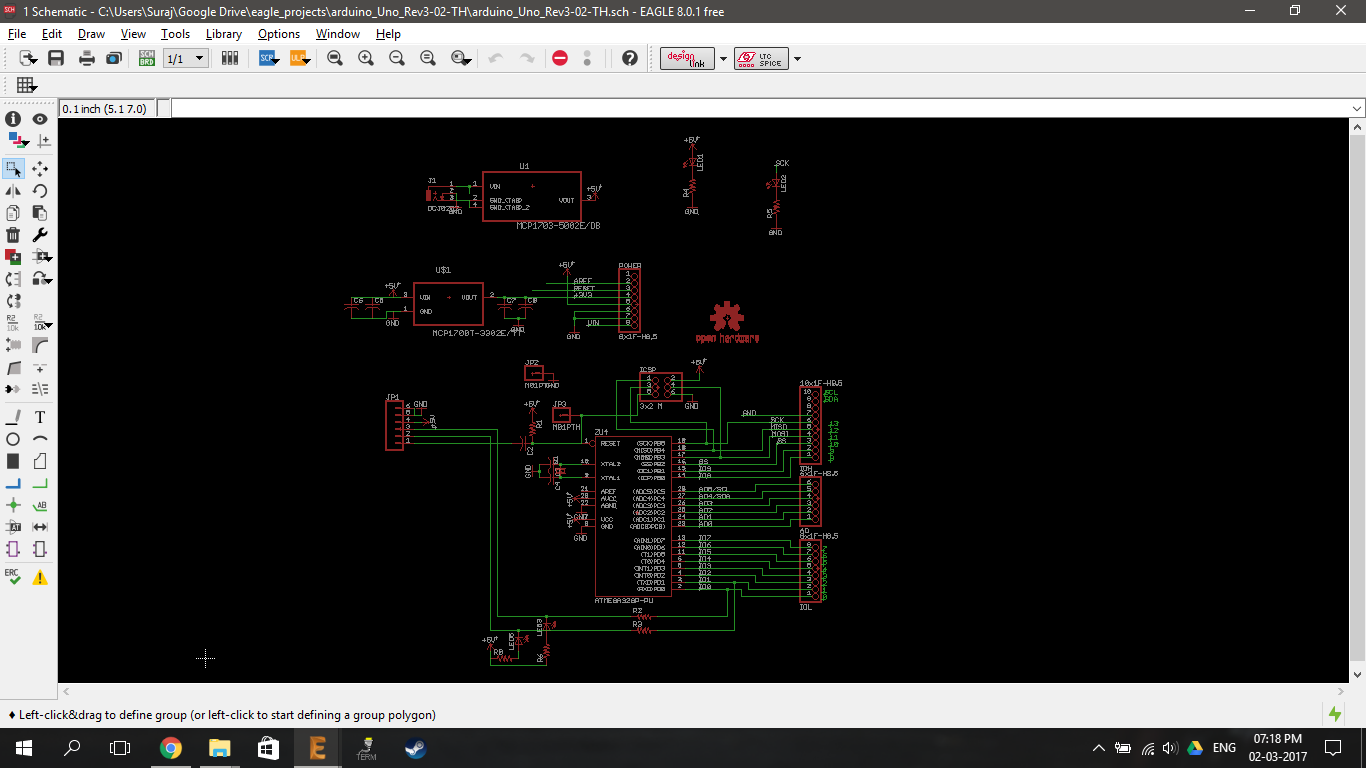

Open the *.sch file and you'll be presented with the following window

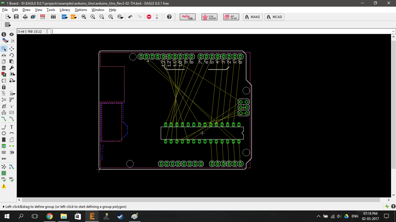

Now start removing stuff and only leave the atmega328p IC the female headers and the ISP header. After that, start adding components as shown in the following picture.
The board has a few pins that are not populated... i.e. AREF, IOREF, SDA/SCL pins along side digital pin 13 (but you can always use pins A4 and A5 if you want to use i2C) .

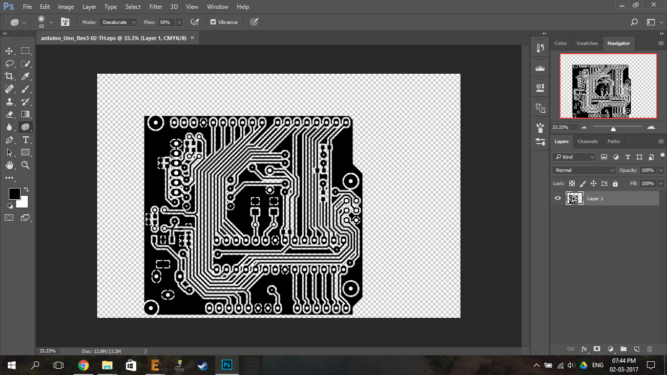

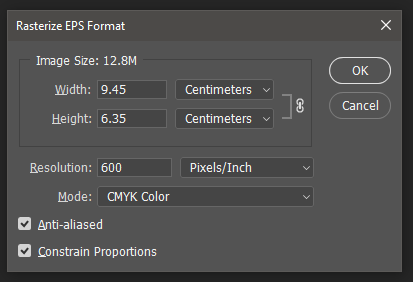

You'll notice that a new *.eps file is created. Open that file using photoshop. you'll be greeted with the following window(Photoshop CC 2017)
Click open and following window will appear.
NOTE: Since this is a bottom layer PCB, it doesn't need to be mirrored before printing.
Now print this file on a glossy side of the paper. and prepare for the PCB printing and etching procedure.

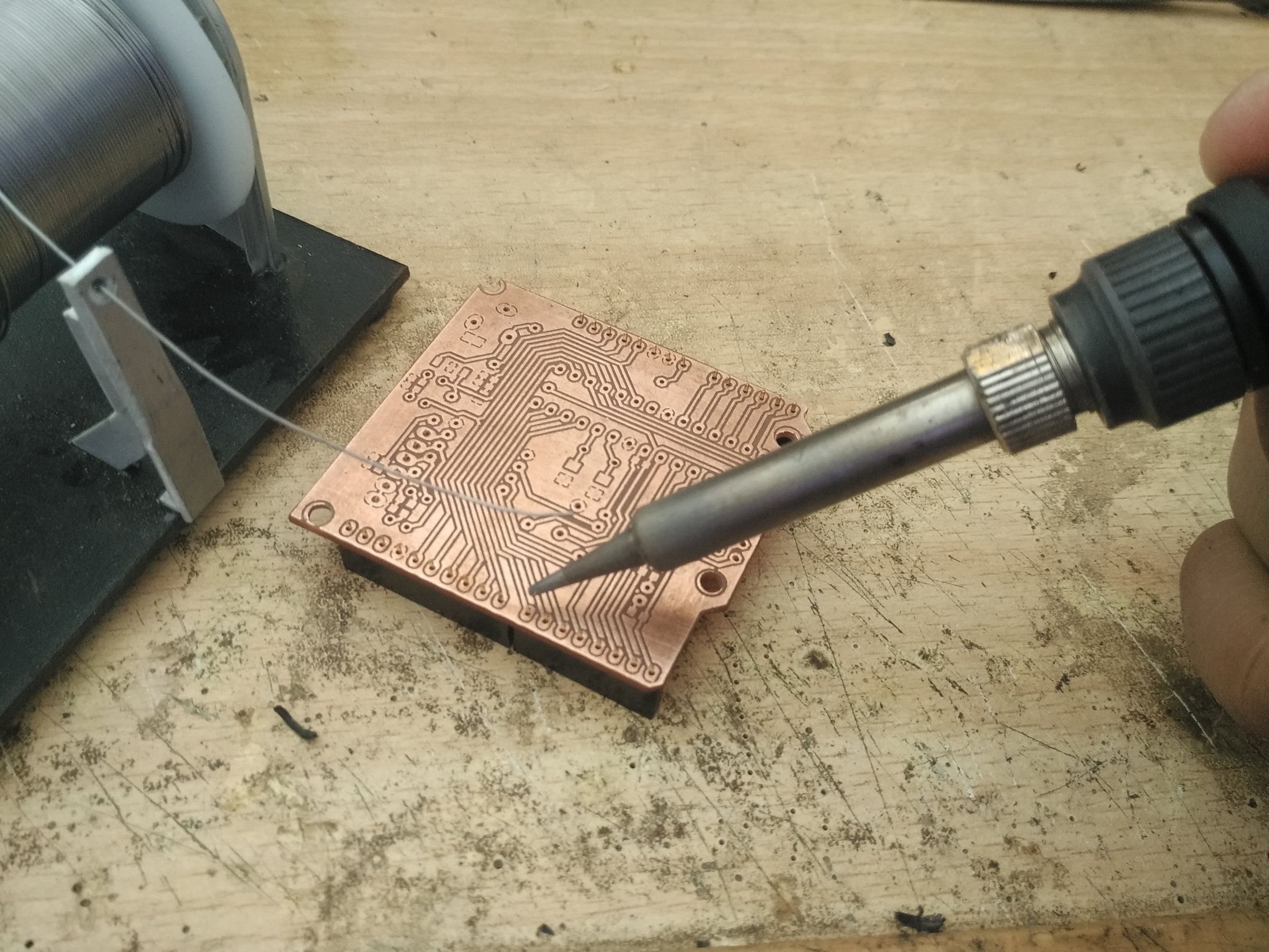

Step 8: Soldering.
Now begins the soldering process.
The components can be seen from the schematics and pcb layout that I've attached in the intro.

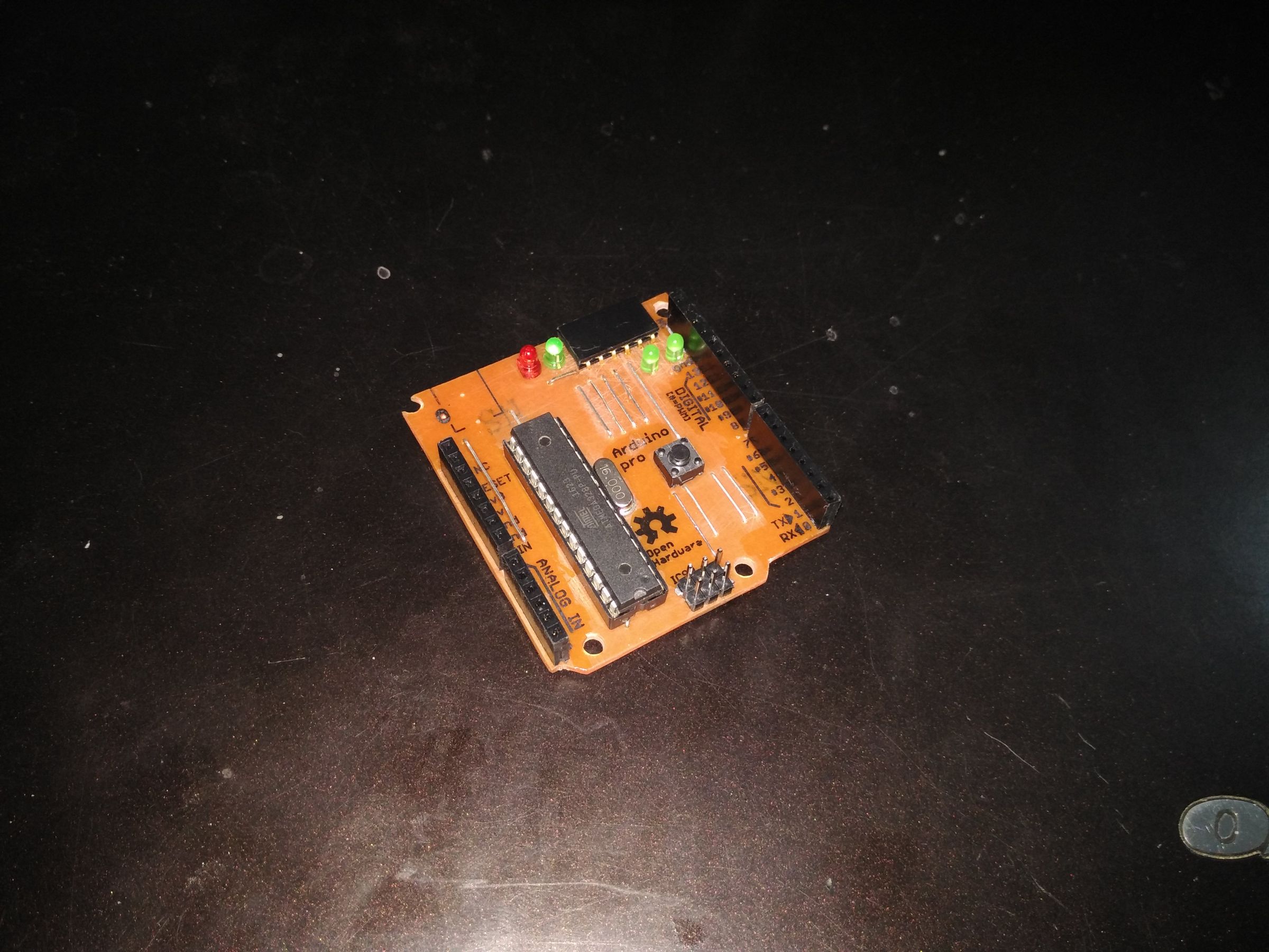

After the Soldering process it'll (hopefully) look like this.
And the bottom layer looks like this.
