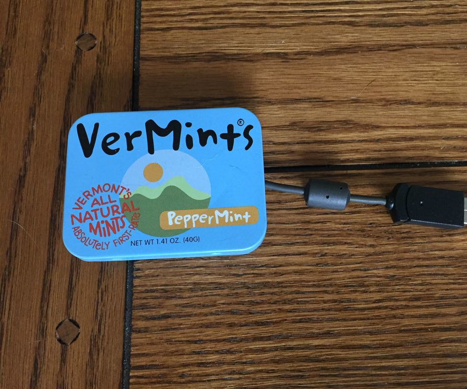

- A mint tin of some sort (Altoids are traditional, but given my Vermont family connections, I'm partial to VerMints, and given my Linux loyalties and caffeine addiction, Penguin Mints are also good. I used a Celestial Seasonings tin here. I am not an employee of any of these companies, btw).

Using double sided tape, attach the PCB to the bottom of the mint tin. You now have an Arduino-ish programmer/prototyping tool you can use to program very inexpensive ATTiny chips to put in the final version of your projects. Enjoy!
