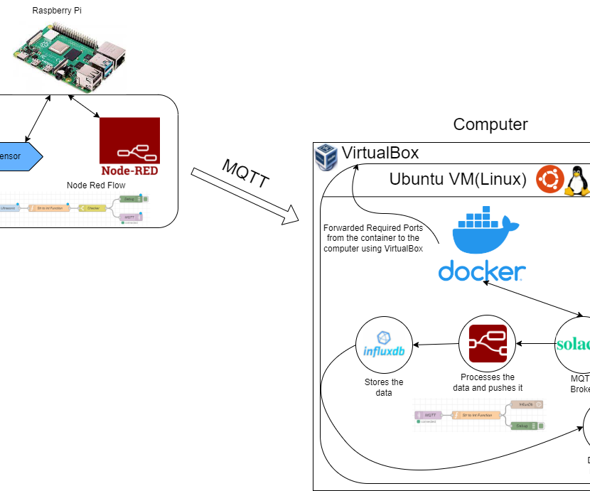

I have a plant that I’ve been taking care of for a while, but I recently started to neglect it. As a techie, I decided the best way to make sure this plant gets the care it needs was to make a system that uses sensors to read things like the moisture of the soil and temperature around the plant, and lets me know when I need to water it.
As far as hardware goes, that’s a natural job for Raspberry Pi, and I decided to create an app using Flutter to notify me whenever I need to water the plant using data from the sensors. The Raspberry Pi will send the data to a database, the app will be able to read the data from there, and let me know when it notices a situation that needs my attention. I also wanted to make it possible to manually refresh the app, and had to figure out a way to actually do it.
Flutter is a widely used app-making framework to create cross-platform apps which can be run on multiple operating systems. Using Solace’s MQTT to subscribe and publish functionality, I can communicate with the Pi and the app using it as a broker to manage the messages.
In this article, I’ll explain how I used MQTT to communicate with the Raspberry Pi using a Flutter app, and I’ll present it in the form of a tutorial in case you want to do something similar yourself.

I have a Raspberry Pi that I want to receive data from for my use case. To implement this, you will need a script where the Pi is subscribed to MQTT and listening to the Solace PubSub+ server.
For my use case, I have a humidity/temperature sensor to record data around my plant. To replicate this, you must write the sensor according to your needs and install the Adafruit package by running this command in the terminal:
pip3 install adafruit-circuitpython-dht
Now, you’ll want to create a new Python file on the Pi which will hold the code for listening and responding whenever a refresh call is sent. In the text editor of your choice, edit the file to have this code in it:

Now you can have a Raspberry Pi that listens to MQTT commands sent from an app and execute commands from those sent commands! That’s great for my use case so that I can send a command to refresh from a Flutter app and use Solace’s MQTT platform to do something about that data like having it read temperature and humidity so that the app can see that refreshed data. If you’d like, there is also a Github repository linked here with the code for the app referenced in it.
