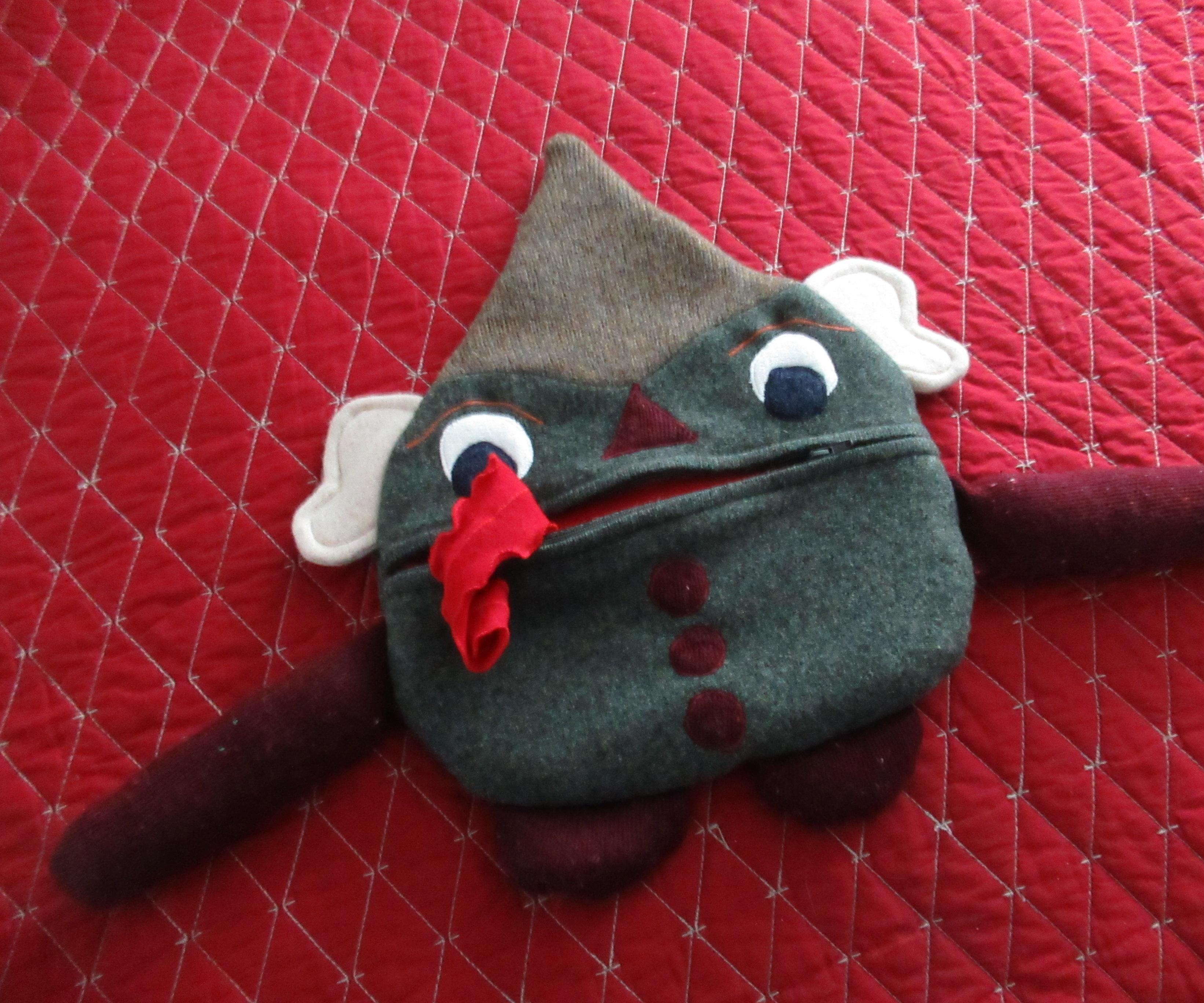

Step 2: Designing Your Monster
I started with a small drawing just to get the idea of what I wanted. Some of the the things changed as I actually made the monster, but it gave me a starting point.
My monster is going to have a body made of two pieces, the upper one will include the head. It will have arms and legs, horns (every good monster needs horns!), eyes, ears, a nose and a mouth. I think I want it’s tongue to stick out of it’s mouth as well! I’m also going to add a pocket, because I love pockets! I’m going to attach all these parts so that my monster could be for all ages – so no buttons or other pieces that could easily be pulled off by younger children.
Draw your monster on paper – just a rough draft, keeping in mind that the simpler the better. Do it small so you get an idea of what you want. Now is the time to think about how your monster will look. Are its arms and hands one piece? Do you want it to have shoes or will the legs and shoes be one piece? Will it have hair?

Once the sweaters are dry, you are ready to start cutting out your monster!!! I decided to use the blue sweater as the body and sleeves, and the caramel one for the head. Those are the big pieces of the monster and will take a good portion of each sweater. I want some contrast in the other pieces so I think I’ll use the green hoodie for the feet and nose, the blue again for the horns and irises of the eyes, and, of course, the white for the eyes! I hadn’t noticed the pockets on the caramel sweater, but since they are there, I’ll use one of them for the pocket on my monster instead of making a pocket from scratch. (So, out goes the pocket pattern!)
Pin pattern on sweater fabric & cut out
- Body – cut 2 (front & back)
- Arms – cut 2 for each arm (front & back)
- Legs – cut 2 for each leg (front & back)
- Head – cut 2 (front & back)
- Face – eyes, nose, mouth, cheeks?
- Ears – cut 2 for each ear (front & back)
- Embellishments – Horns (cut two for each horn), tongue (cut one), eyes (cut two for the whites, and cut two for the irises), teeth – cut the number you want!
I decided I didn’t like the bright red for the tongue, so I looked through my scraps from other projects and found two colors of orange – deciding to use the darker of the two for the tongue and the bottom of the nose, to add contrast. I also decided to put on eyelids rather than do zigzagged eyebrows, which was my original plan. I cut the eyelids out of green to match the nose.
With all the pieces cut out, I laid all my cut out pieces of sweater together to make sure I had everything I needed for this monster.

Stuff! Make your monster as full as you wish. I like mine to be fairly full! Push stuffing into the corners and edges. Work the stuffing around so there are no lumps. Once you have your monster stuffed to your liking, pin the edges of the opening together.
Hand sew the opening edges closed, going over the stitching twice to give a secure closing.
