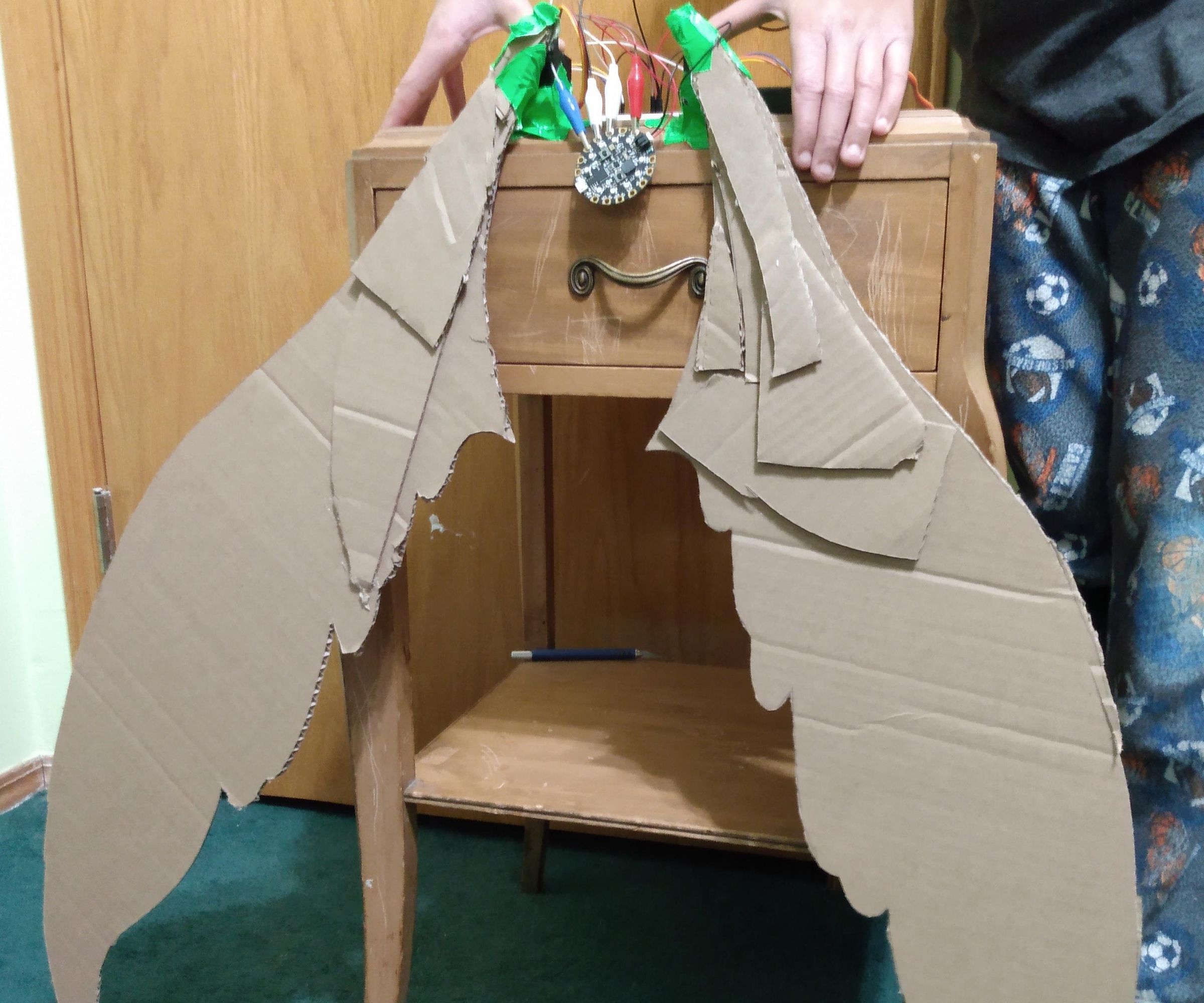

Using the cardboard cutout wing from part 1, I traced the form and penciled out the contour of the wing frames on a piece of bristol board.
With a craft knife, I cut out the shape, traced it on the other half of the bristol board, and cut out the second paper frame.
I then took armature wire and created supports for the wings running along the two main top and bottom lines of the frame, and hot glued the bases, and then colored the wire and paper frames with gold metallic paint.
Cutting out about 30 inches of iron-on vinyl, I layered iridescent film onto the sticky side of the vinyl and lightly traced some of the inner contours and loosely traced the form of each wing frame.
Directly on the iridescent film, I colored some areas with bright green ink to tint the film, and left it to dry for a full 24 hours before carefully sealing the frame in between the painted film and vinyl side and a second sheet of iron-on vinyl.
I laminated the wings using a small clothing iron set to medium heat, and finally used fabric scissors to cut out the wing shapes.
