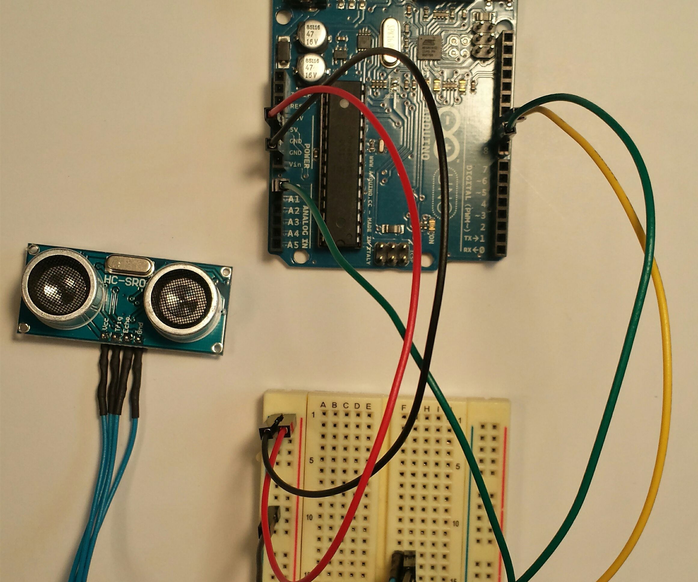

Step 2: Wire Everything!
Now all you need to do is connect everything! I used Fritzing to create a circuit diagram. I have also provided some pictures of the final product.
The code provided uses digital pins 9 through 13. Pin 9 is the data pin for the servo. Pins 10 and 11 are the echo and trig pins, respectively, of the left sensor. Pins 12 and 13 are the echo and trig pins, respectively, of the right sensor. I connected the 5v and gnd pins from the Arduino to the breadboard and then used jumpers to connect the servo and sensors.
