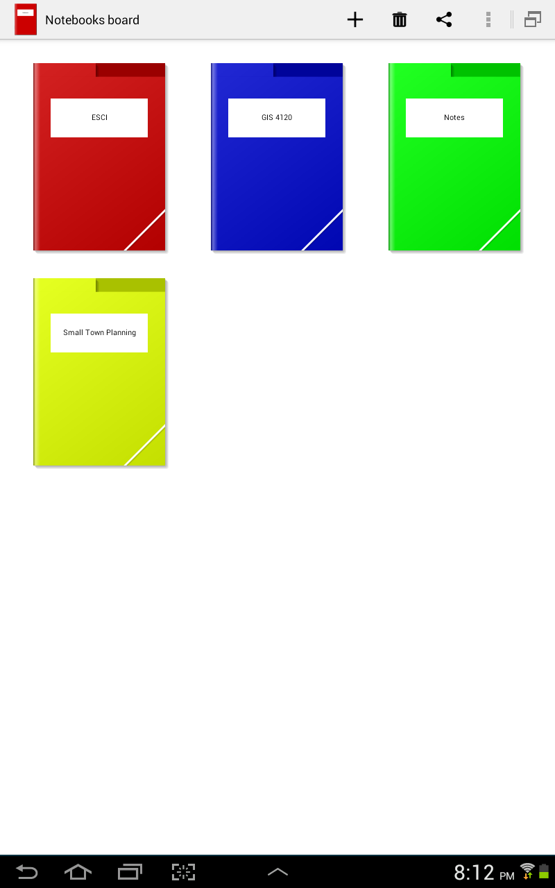

Beginning again at the LectureNotes board, we are going to make a backup of the notebooks board, and restore the board once we have changed the directory location.
Terran's method to backup a folder using DropSync Pro:
http://forums.androidcentral.com/samsung-galaxy-note-10-1/258719-how-sync-snote-internal-sd-card-external-sd-card-dropbox-same-time.html#post2629006
Step 1:
Begin by selecting 'Backup Notebooks Board' which will place a zip file in the app directory. If it asks you to share the backup, skip over this as we already have a local copy available (hit the back key to exit the upload chooser).
