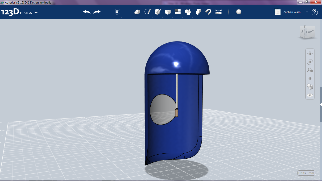

Step 4: Slopes
1. Create a right-angle triangle using the polyline tool (Side One: 15, Side Two: 7.5).
2. Extrude the triangle (Height: 16).
3. Rotate the shape so that it is positioned as shown in the picture.
4. Move the shape into the main body so that Side One is coincident with the left side of the main body and touching the base.
5. Copy and mirror the object.
6. Position the new object in the same proportion as the the first object except on the opposite side of the main body.
7. Subtract both triangular objects from the main body.
