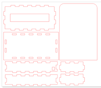

- I made the base out of 5mm plywood I got at Home Depot in the flooring section. Its called underlayment and pretty darn cheap for how nice the veneer on the top looks.
- I then used BasedBox - Boxes (festi.info) to generate the .svg of the box. I have attached the .svg file I used which has the top hole for the acrylic and the back charging port hole.
- I used the same wood for the backboard that goes behind the last sheet of acrylic. (see step 2)
- I then cut out the box and backboard on a laser cutter.
-If you don't have a laser cutter you can make a box out of whatever you have around (foam board, Legos, etc.) The finger joints look nice but are not necessary. If you have to make the box, the only really important dimension is the rectangular hole in the top (27.75mm x 139mm). As long as that is the right size, the rest of the box can be any size. Just make sure it has enough room for the ESP32 and Developer Board plus the LEDs in it.
-(I decided to add a 3d printed base .stl so you can print the base too if you'd rather not build it.)
- Cut a hole in the backside of the box with the laser (I included both the center hole in the top where the acrylic goes and the square hole on the back for the power port.) (Can use a drill if no laser available.)

- I used the same wood as the box and cut out a rectangle (203mmx135mm) with the top corners rounded (16.5mm), this is same shape acrylic will be cut.
- I included the backboard as part of the .svg file in the previous step.

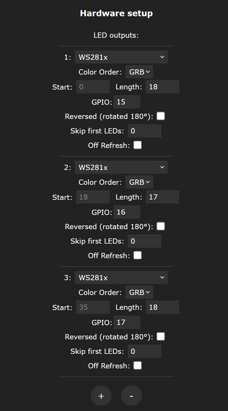

- First we need to go to Config, then LED Preferences.
- We need to set it up so there are 3 different led strips, to do this first fill out the following information,
START: 0
LENGHT: 18 (or however many you have per strip)
GPIO: 15
- Hit the plus button now to make your second strip.
START: 18
LENGHT: 18 (or however many you have per strip) (I had only 17 on this one, had to cut and resolder)
GPIO: 16
START: 36
LENGTH: 18 (or however many you have per strip)
GPIO: 17
- Below this make sure you check make a segment for each output.
