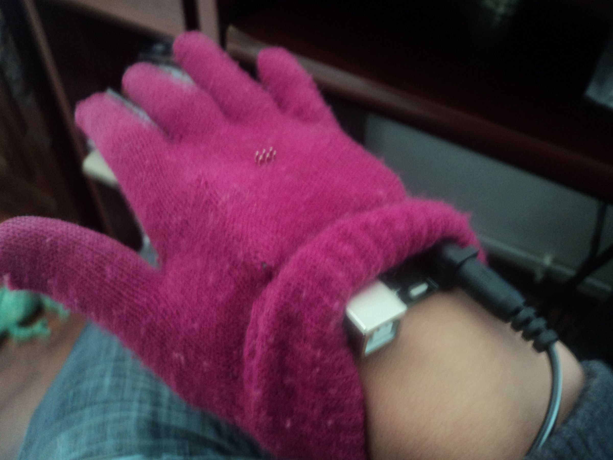

3. MoveGame
By moving our hand and fingers we can control the computer (text input, cursor control) and play computer games. We can also transfer some video games to the computer and control them with this application, if we are using emulators. For example, Playstation Emulator and other programs we can find on the Emulator Zone website. The movement sensing is performed by an ADXL335 three-axis accelerometer, and the flex sensor monitors the fingers for key command input. There are flex sensors assigned to each of the forward, backward, right, left and selection (Enter) commands. The control chip is an ATmega32U4 with Teensy bootloader. The operation comprises three steps. 1. The chip reads and processes the data from the accelerometer and the flex sensors. 2. It sends the control commands to the PC via USB, using HID protocol. 3. The computer receives the commands and based on them performs the key operations or moves the cursor to the selected points.

Step 2: Hardware
What is Arduino and Teensy?
Arduino is an open physical computing platform based on a simple circuit and software development environment. The programming language used on Arduino is an implementation of Wiring that was developed from Processing. Physical computing is a creative framework that helps learning and exploring human’s relation to the digital world. It has many application areas, such as art, security technologies, hobby technologies, medicine, etc. Arduino is a C-language based platform that is very much universal thanks to the bootloader that has to be burned in before programming. Due to the bootloader-requirement, it can be used for various microcontroller families. It is a very compact, logical language. The circuit part is easy to make, even for a beginner electronics fan. For more information about Arduino click here or here . Teensy is a complete USB-based platform, built on the Arduino framework, but it is cheaper and more efficient. For more information about Teensy click here .
Power supply to the circuits
As power supply for both the Teensy board and the Arduino board power may be supplied via the USB port. As external power supply a 12V, 500mA unit may be used, or if necessary even a 9V battery as well, though this will deplete quickly. The microcontroller may not be driven directly by an external power supply, it the power supply in question delivers a voltage above 5V. In this case, different stabilizer circuits or components may be used to ensure a stable 5 volts tension. The simplest approach to solve this problem is the use of stabilizer integrated circuits. Such is the L7805 type of integrated circuit. These are inexpensive and efficient. However, it is important to take care also of cooling. These are not needed when using the Arduino panel, since this dose include stabilizer integrated circuit. However, one should be careful not to exceed 12V (1A) input voltage, because in spite of cooling the integrated circuit may blow up because of overvoltage. In the case of the Teensy panel, there is no built-in stabilizer circuit. In the case of the Teensy, if one does not want a USB power, then for the external power source the above mentioned integrated circuit is also needed.
The schematics are attached at the bottom of this page in more formats.
