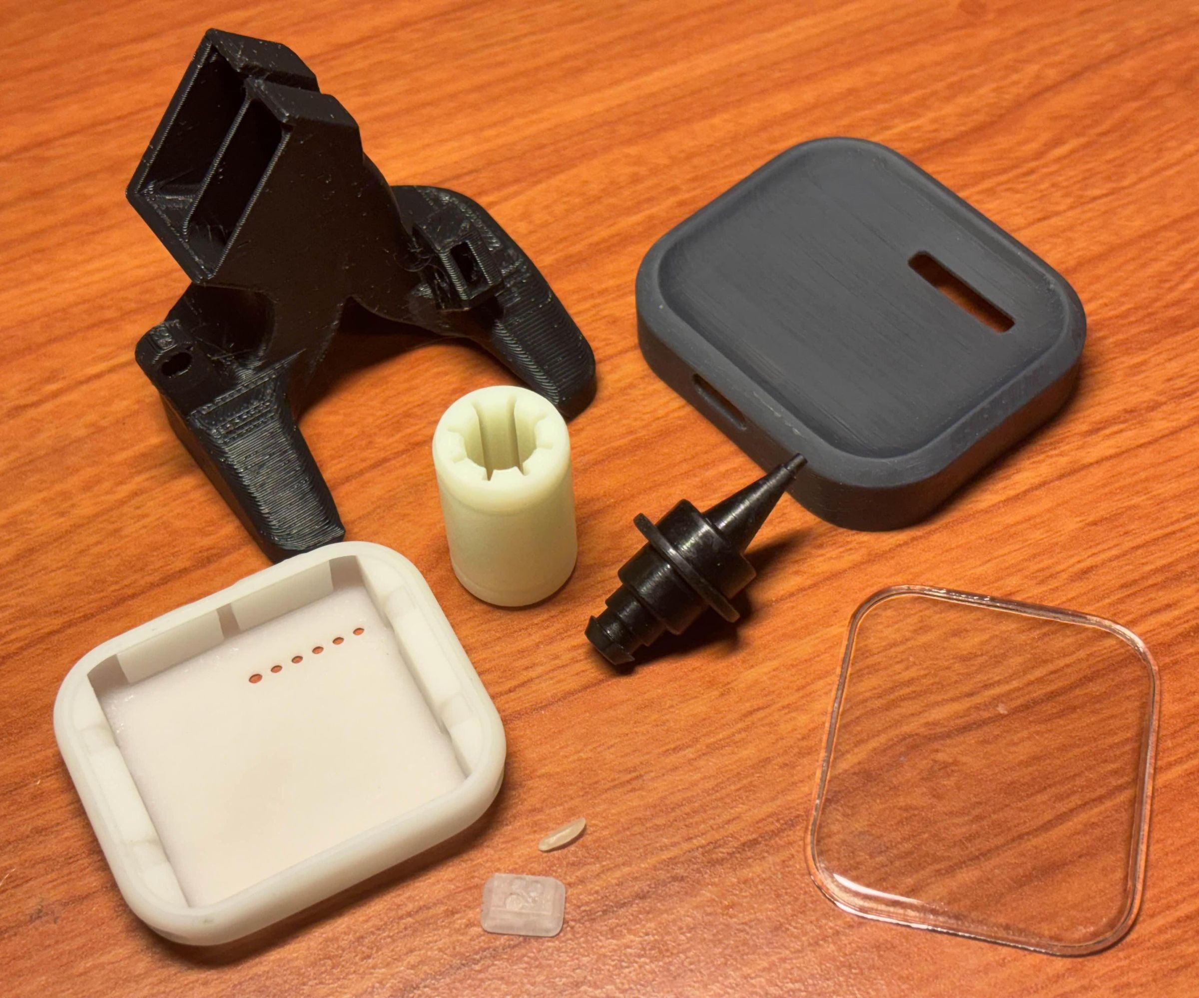

Step 2: Print PCB and 3d Parts
Download all the Parts STL files from here print by your self or use printedsolid.

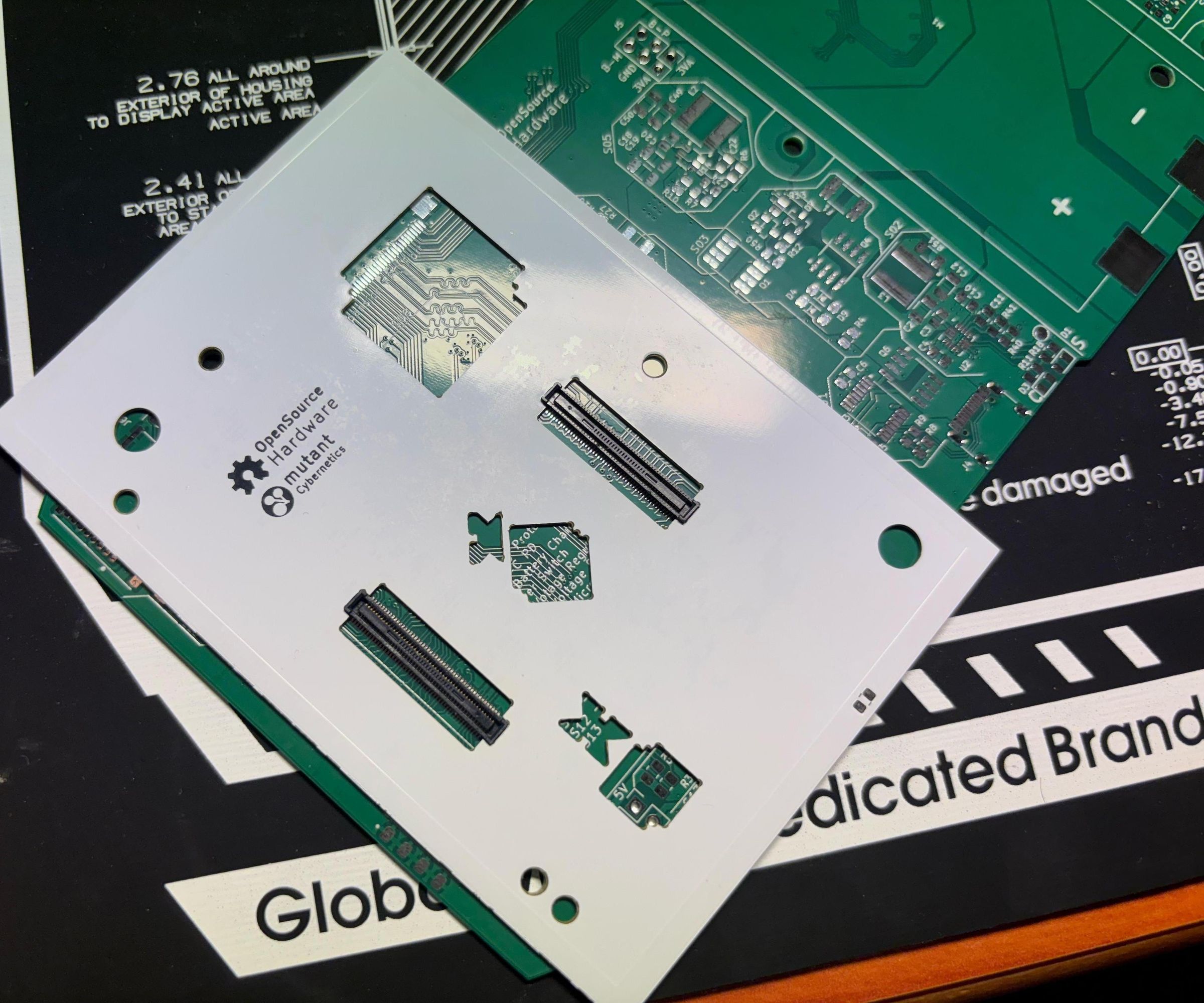

And use this two garber files from display_PCB and main_PCB order the pcbs from JLC_PCB or pcb way or oshpark .
Step 3: Solder the Ardiuno Pro Micro and Buttons and FPC Connector
You have cut the headers to keep a low profile.
Don't wast your solder by soldering 4 pins of the PushBottons. Only solder the 2 pins that are connected.
