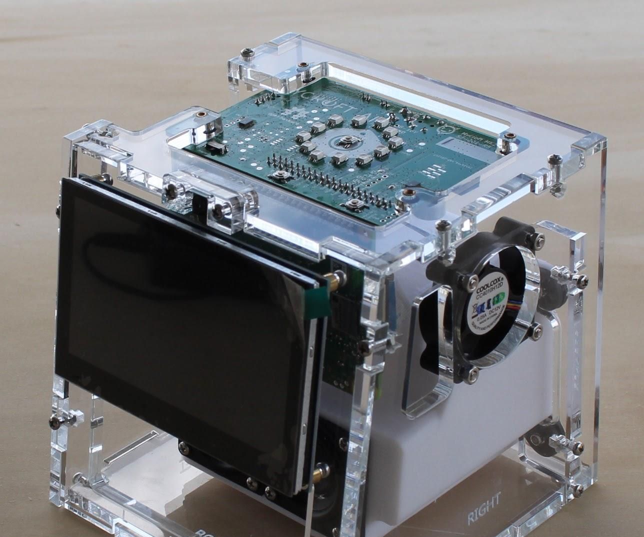

Step 1: Unpack Your Kit
Included in the Kit are the following items:
  • SJ201 Mycroft Audio Pi Hat
  • 1.5" Speaker Drivers
  • Power supply (12v 3A)
  • 10x M2.5 x 12 mm screws
  • 35x M2.5 Threaded inserts
  • 12x M2.5 x 10mm screws
  • 9x M2.5 x 6mm screws
  • 4x M2 Threaded inserts
  • 4x M2 x 8mm screws
  • 4 Blue Speaker Grommets
  • Raspberry Pi 4b 2GB
  • Raspberry Pi Heatsinks
  • Fan
  • USB Drive 16gb
  • 4.3" LCD touch Display
  • Display Cable (DSI)
  • Wire holder
  • 4x Grommet insert spacer
  • 4x Foam Microphone Gasket
  • Tweezers
  • Alcohol Wipe
  • Instruction Card

On the Display Housing clean the square camera mount with the Alcohol Wipe to promote good adhesion. Next remove the paper covering the adhesive on the camera and place it in the square camera mount on the Display Housing. Next place the Camera Shutter 1 over the camera. Then stack Camera Shutter 2 on top of Camera Shutter 1 (Camera Shutter 2 is the sliding mechanism) Finally, place Camera Shutter 3 on top of Camera Shutter 2 and secure with 2 m2.5 x 10mm screws.
Next, remove the outer film from the screw mounts on the LCD display. These mounts are how the LCD display attaches to the Display Housing. Place the Display in the Display Housing with the thinner bezel facing up toward the camera. Then Fish the camera cable around the back of the display and out the back of the Display Housing. Use 4 m2.5 x 6mm screws to attach the LCD display to the Display Housing.
Last step, place the Bezel into the housing and align the hole with the camera. Secure from the back with 4 m2.5 x 6mm screws.
Step 10: Combine Display Assembly and Grill
You will need the display assembly, the grill, and 4 m2.5 x 12mm screws. To attach the display to the grill align the Camera ribbon cable (CSI) and Display ribbon cable (DSI)with the slot in the grill. Feed the ribbon cables through the slot. Align the grill with the 4 mounting holes on the Display Assembly. Attach the Grill to the Display Assembly with 4 m2.5 x 12mm screws.
Step 11: Attach the Display Assembly + Grill to the Body
Using 4 m2.5 x 8mm screws attach the Display Assembly + Grill to the Body.

Step 16: Combine the Top Assembly and Raspberry Pi 4
Combine the Top Assembly and Raspberry Pi 4 with the 40 pin connector.
Step 17: Attach the Fan to the Body
With the Wires facing the top and the label facing out attach the fan to the Mark II Body with 4 m2.5 x 12mm screws.
Step 18: Attach the Top Assembly to the Body
Connect the Display Ribbon Cable (DSI) to the Display Connector (DSI) on the Raspberry Pi 4 on the edge of the board near the SD Card slot. Make sure the connectors are facing toward the center of the Rapsberry Pi board and not toward the edge. The cable needs to twist 180 degrees for proper alignment. Attach the optional Camera cable (CSI) to the Camera connector (CSI) on the Raspberry Pi 4. Again, make sure the connectors are oriented correctly. See the photo for proper orientation. Connect the 4 pin Fan cable to the SJ201, it's a directional connector with a key, it can only be assembled one way.
Carefully place the ribbon cables between the Raspberry Pi and the Grill. Slide the Top Assembly into place, it will friction fit into two slots on the body. It will be later secured in the back with two screws.
Step 19: Place the Audio Chamber Into the Body
Add the 4 Blue Grommets (for anti-vibration) to the hooks in the Audio Chamber. Place the two Grommet Insert Spacers in the upper two grommets. Carefully slide the Audio Chamber into place, the Grommets should meet up with the 4 Audio Chamber mounting bosses on the Body. Secure the top two mounts with 2 m2.5 x 12mm screws. The bottom will be secured through the Back piece.
Step 20: Attach the Back to the Body
Using 4 m2.5 x 12mm screws attach the Back to the Body. The top two holes will sandwich the Back, Top, and Body securely together. The bottom two holes will sandwich the Back, Audio Chamber, and Body securely together.
Step 21: Add the Door
Using one m2.5 x 6mm screw attach the door to the side of the body.
Step 22: Add Feet
Add feet to the bottom of the Body. The feet we are using now are replacement laptop feet with a diameter of .7"
Replacement Laptop feet
Step 23: Assembly Complete!
You're all done, now it's time to enjoy your Mark II 3D printed Dev Kit. Before you get started visit account.mycroft.ai to create an account. You will need an account to pair your device. Next, plug in the power supply and follow the prompts to set up wifi and pair your device. Happy hacking!
