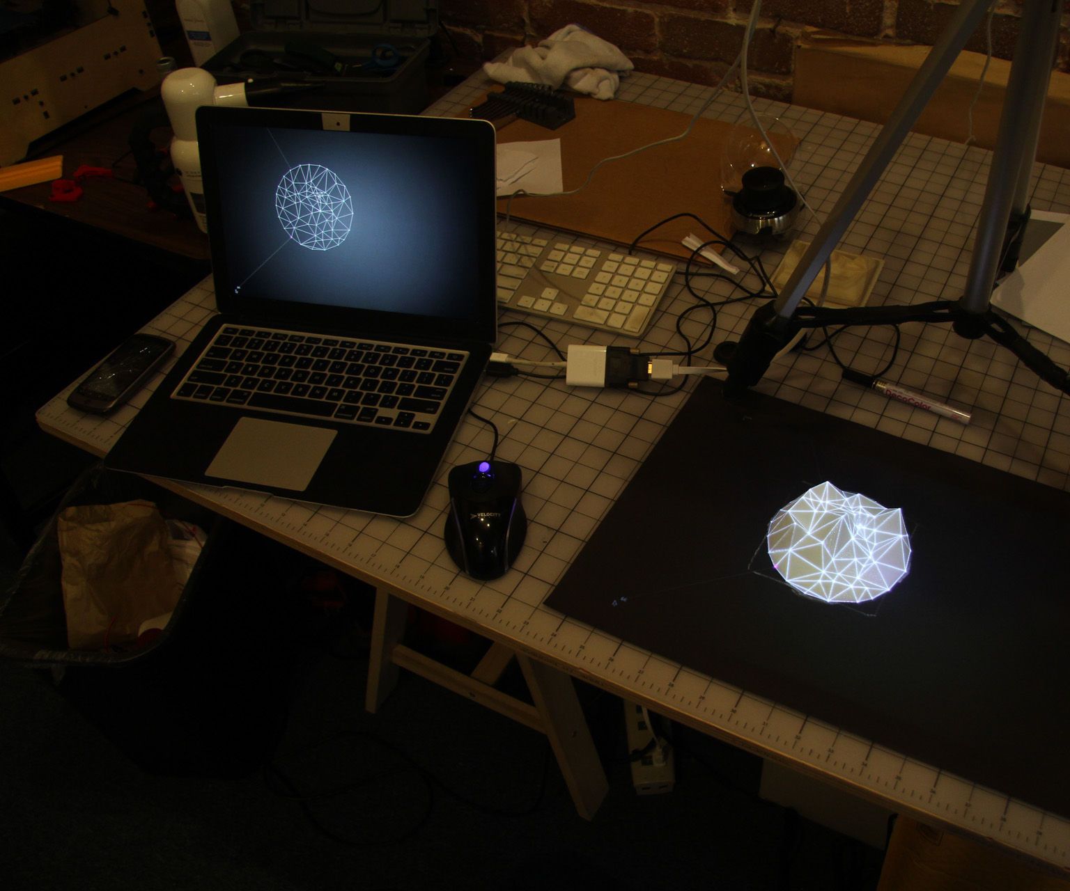

Step 36: Mapping With CamShnapper
Mapping the sculpture is done with CamShnapper, an interactive mapping patch for TouchDesigner based on MapaMok by Kyle McDonald, a mapping technique that leverages optical functions in OpenCV.
The proxy mesh is imported into TouchDesigner for use as control points, and CamSchnapper modifies the camera's POV to optically warp the scene to match.
Each projector requires its own camera, so each projector requires to be mapped individually
