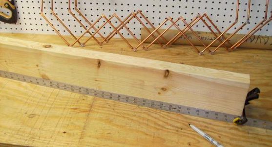

Make this jig for bending tophat NAROD elements that add VHF-high reception to the Gray-Hoverman homebuilt tv antenna. This is one of several of my Instructables related to building this antenna. To see the others and my related Instructables, click on unclesam in the INFO box at right and repeatedly click NEXT to page through them all. To receive automatic notice about my future antenna construction postings, you can click in the INFO box to subscribe to me. In the final step I include links within Digitalhome.ca that further describe the antenna.
STEP 1: Materials and Tools
Materials
Board, 2X6 (actual one and one-half inches thick by five and one-half inches wide) by 32 inches long. The jig could be made on a smaller board, even a 2X4, but the larger board provides room for clamping it to a benchtop.
Wood, plywood or plastic for cleats, about one half inch thick by about one half inch wide, eight inches long
7 screws, multipurpose (drywall), one and one-quarter inches long
screwdriver, phillips
Wooden dowel, seven-eighths inch diameter, two pieces 2 inches long each (I cut off end of the handle from small-size toilet plunger)

STEP 2: Draw One Horizontal
Begin by drawing a line parallel to and about one inch from one edge of the board.This jig is intended for bending #6 solid copper wire to meet the dimensions provided (by others) on this linked page http://mysite.verizon.net/imagelib/sitebuilder/misc/show_image.html?linkedwidth=actual&linkpath=http://mysite.verizon.net/res11d41p/sitebuildercontent/sitebuilderpictures/Tophat_NAROD_dim03.jpg&target=tlx_pica4bz. The drawing's dimensions refer to the centerline of the wire, and the dimensions of my bender account for the 0.162 inch diameter thickness of #6 wire, matching the drawing within a few thousandths of an inch. Other size wire can be used for the NARODs, but the dimensions of the jig would need to be adjusted. The antenna design and the dimensions on the drawing are protected (by others) by license. The information is provided free for individual use, but commercial exploitation is prohibited.
STEP 3: Draw Three Vertical
Mark the center of the horizontal line. At 8.25 inches to the right of the center, draw a vertical three inches long. At 9.25 inches to the right of the center, draw another vertical three inches long. Mark the lefthand vertical at 1.64 inches above the horizontal line, then mark the other vertical at 0.60 inch above the horizontal line. These two marks are the centers of the two holes to be drilled.
STEP 4: Drill Then Draw Some More
Drill a seven eighths-inch diameter hole at the marks on the two vertical lines. At the top edge of the lower hole, draw a horizontal line to the left for six inches long. At the top edge of the upper hole, draw a horizontal line to the left for six inches long. At the top edge of the upper hole, draw a horizontal line to the right for six inches long.
STEP 5: Cut and Attach Cleats
Cut one cleat seven inches long and attach it with one edge right on the horizontal line, about a half inch past the righthand vertical line. Cut the short cleat three-quarters of an inch long and attach it with one edge against the lefthand vertical line and its head end against the horizontal line that runs left from the top of the lower hole. Mark the short cleat so it can be removed and re-installed in the same orientation every time.
