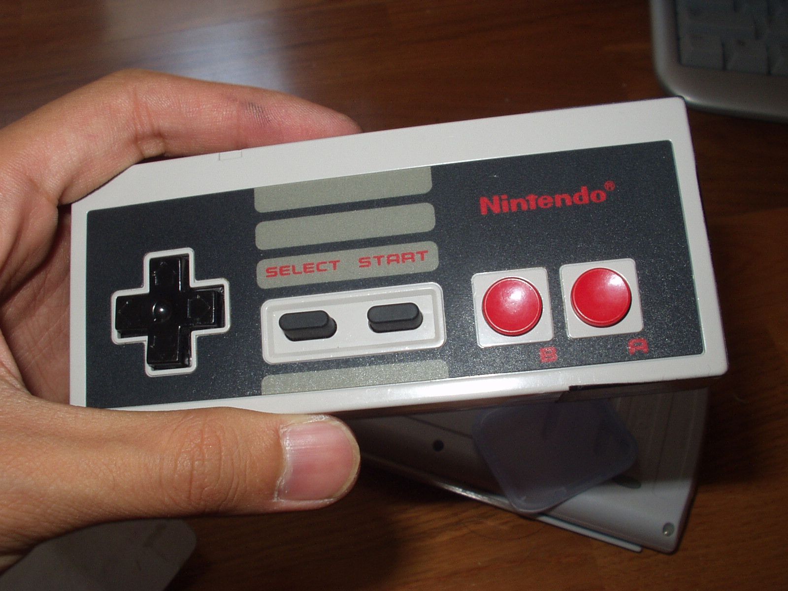

I've managed to squeeze a Motorola C168 into the tiny compartment that is the NES Controller.
Yes. I know. Amazing.
I got the idea while at the local Play N Trade. I saw the controller on the rack, and immediately said: "That would make a great cell phone!"
And so I did it!

Step 3: Dremel Time
This is pretty much the entire project. It took about 90% of the total time.
Use multiple bits for different situations. Don't use the same bit for the whole thing; you'll have a horrible time if you do that.
The pictures pretty much explain it all.
If you Ever plan to do this, you Must use the goggles. The dremel created showers of molten plastic shards, which flew everywhere at hundreds of miles per hour.
If you don't want to be as blind as Anne Frank, wear goggles!
