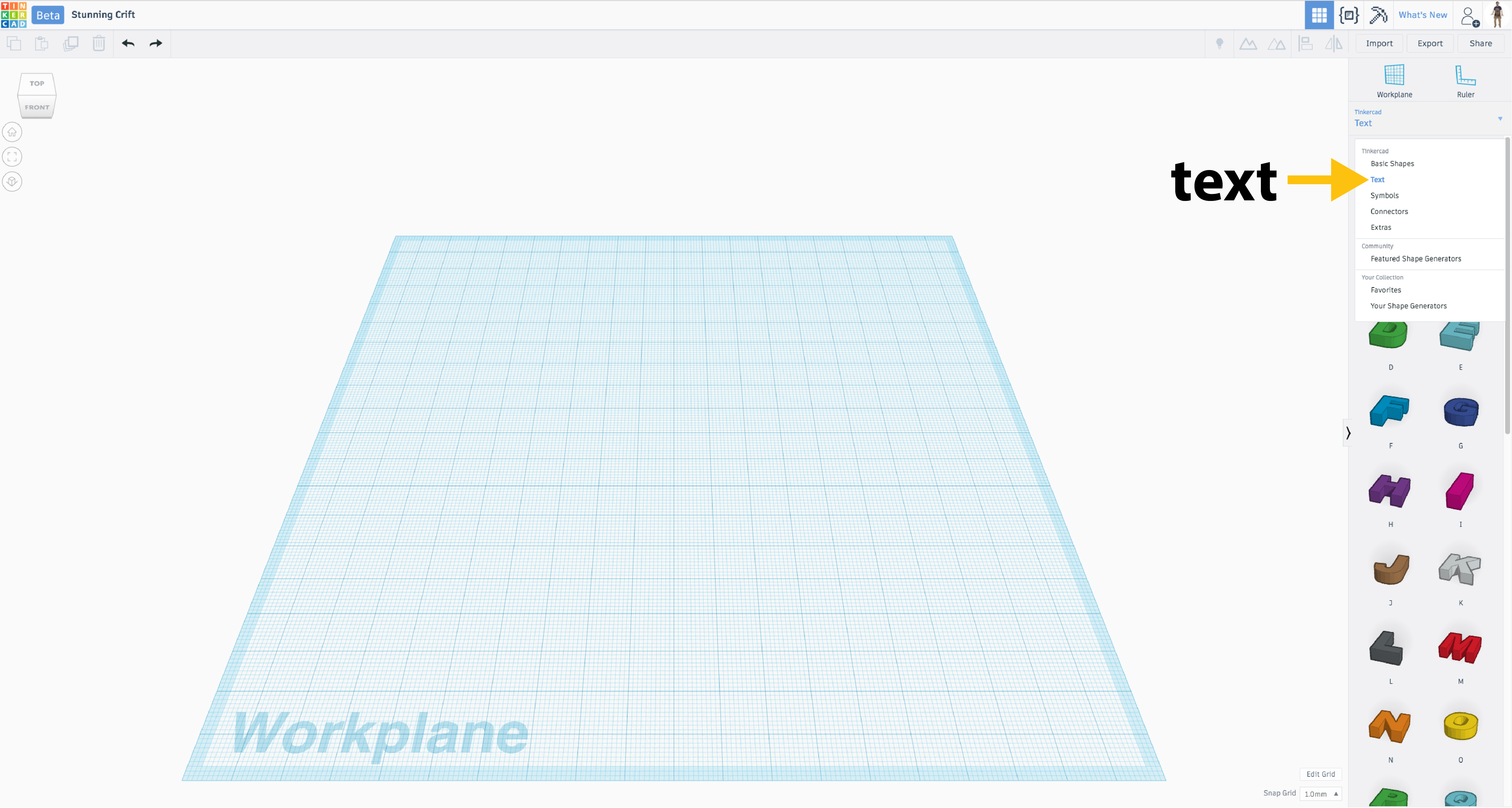

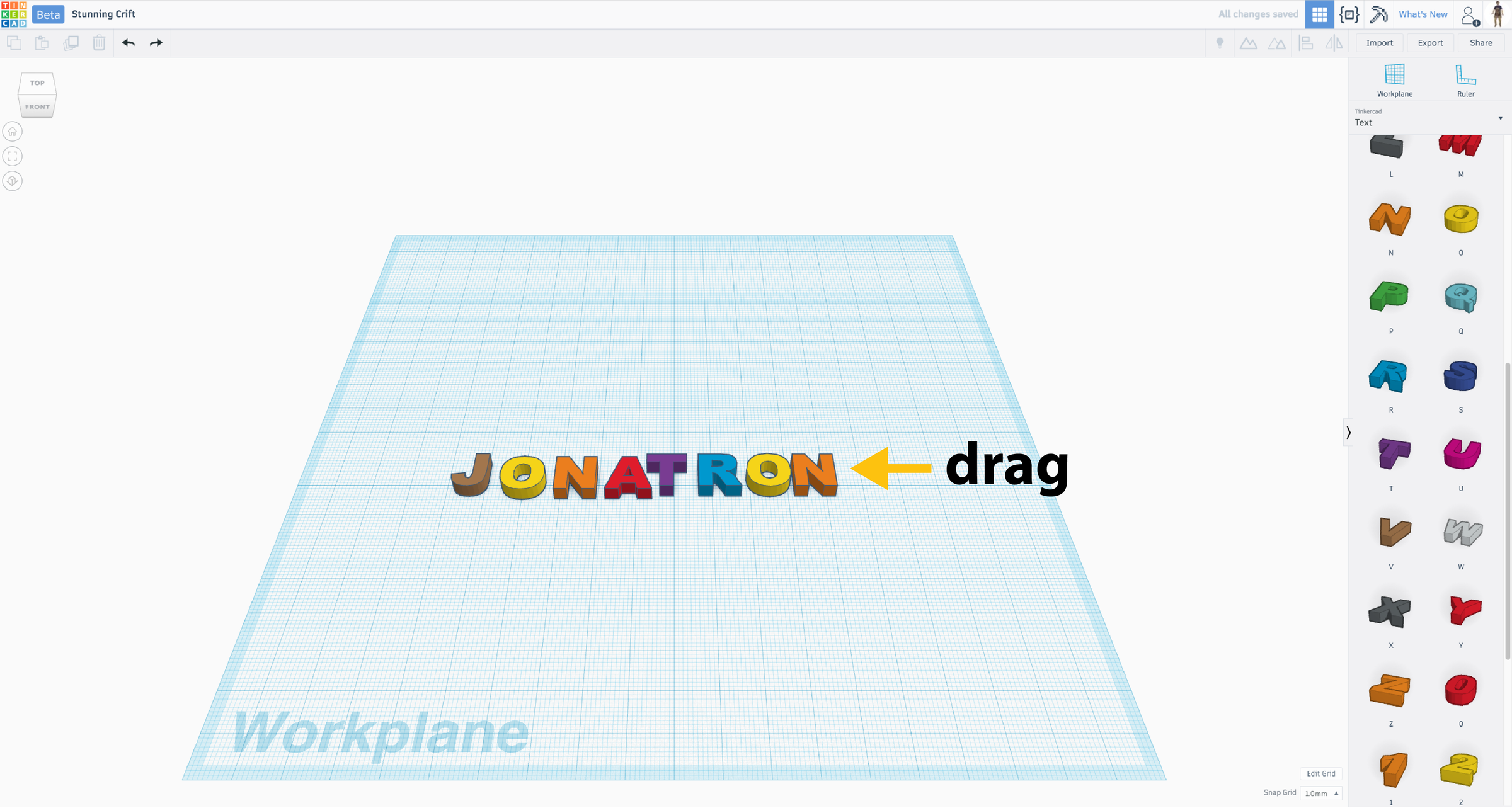

Expand the Text panel on the right side of the screen, then click and drag the letters onto the workplane.
Drag each letter of your name onto the workplane. Remember: I used the letters of my Instructables alias, but you should use the letters from your name or any other word you would like to turn into a keychain.

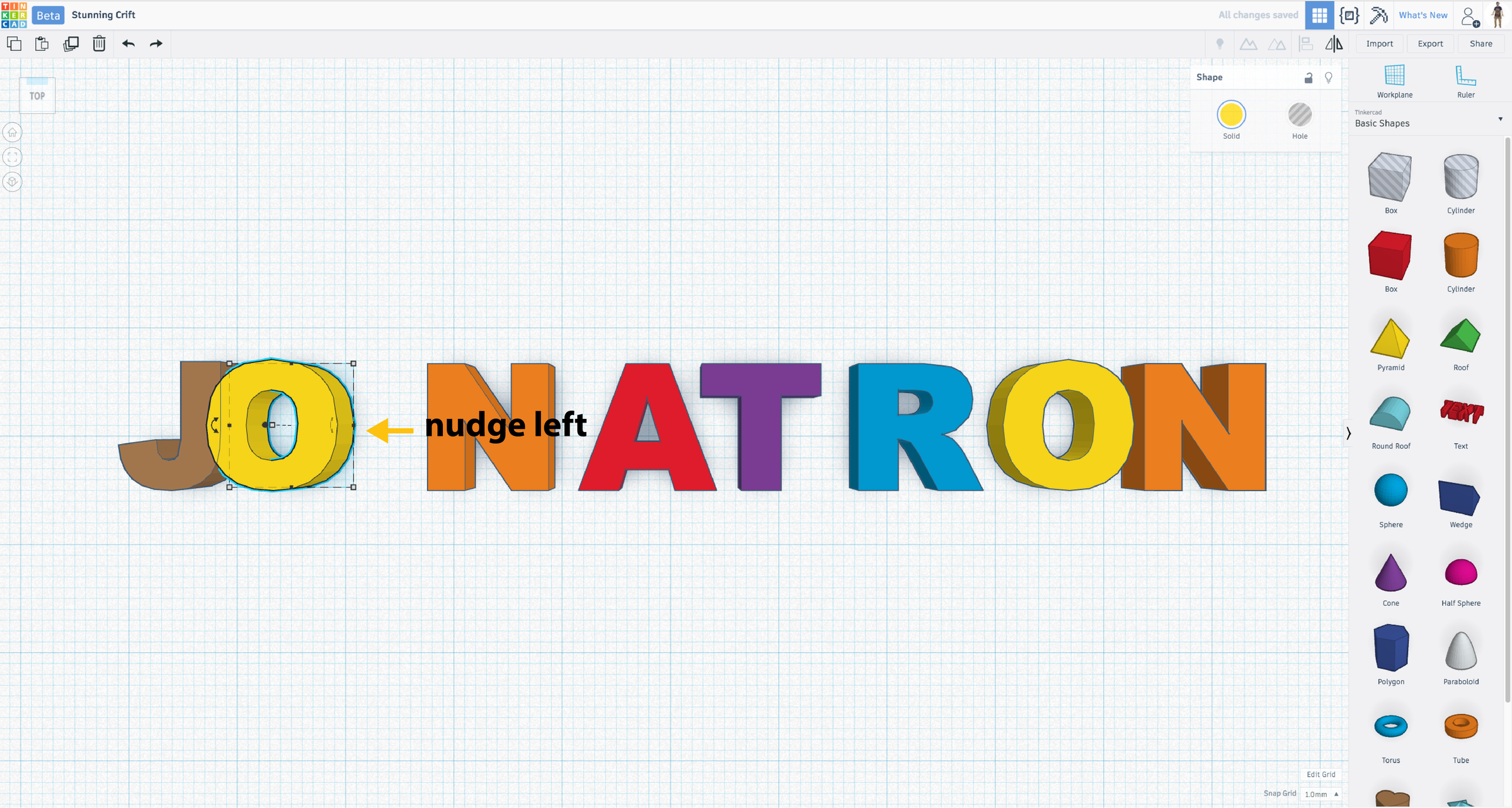

Step 4: Make the Letters Overlap

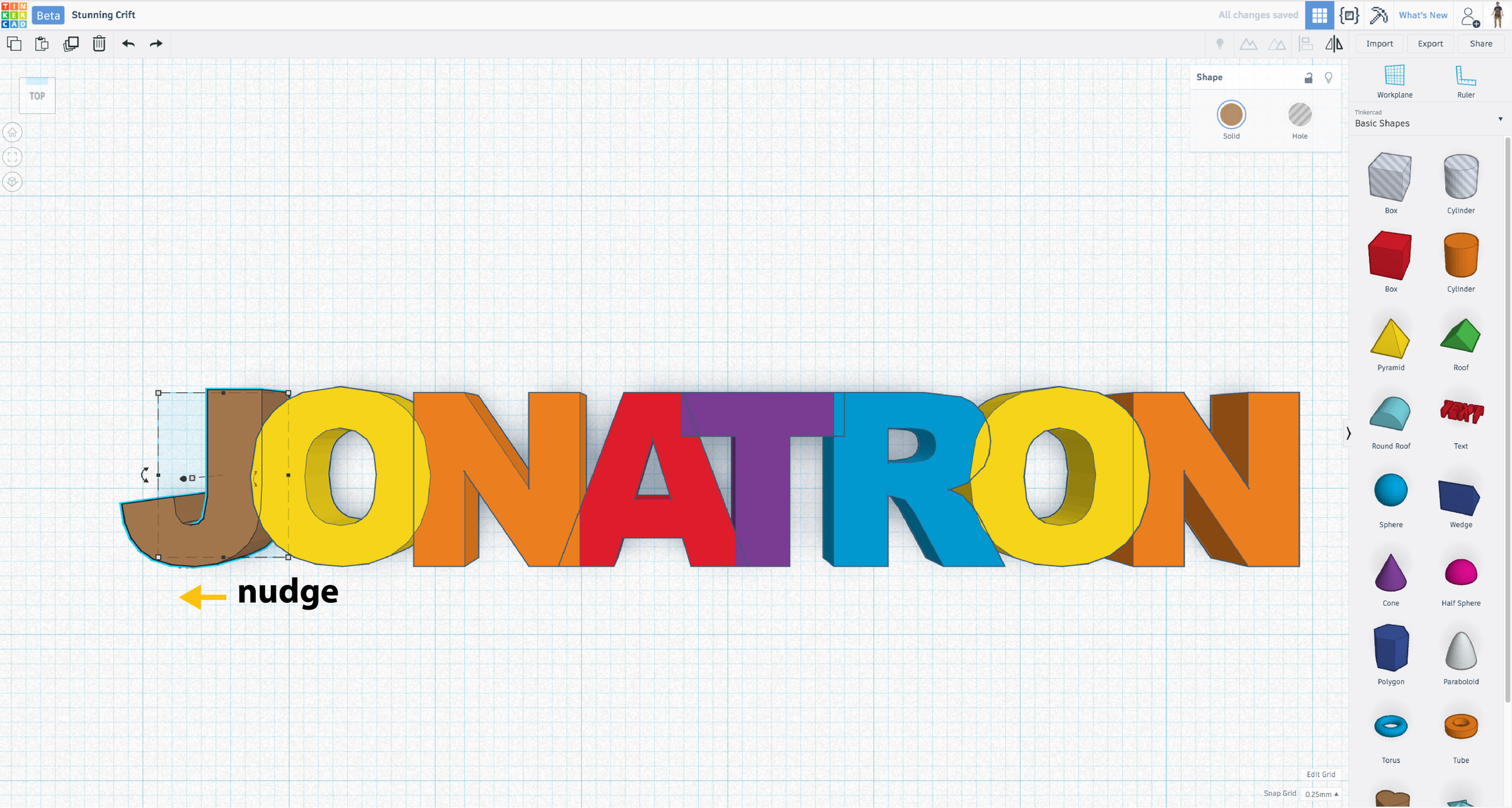

Rotate your view so you are looking down on your name by clicking Top on the View Cube. Select the second letter in your name and use the arrow keys on the keyboard to nudge in closer to the first. Note: Each letter should overlap the letter before it by about 1mm, but this doesn't need to be exact.
Repeat the previous step for each of the remaining letters in your name. When each of the letters is overlapping the letter before it in your name, you are almost finished.
Not all the letters are the same width and you will probably find that some letters overlap more than others. If you want to fine tune how much your letters overlap you can set the grid snap to 0.25 and use the arrows on your keyboard to adjust the amount each letters overlaps it's nearest neighbor.

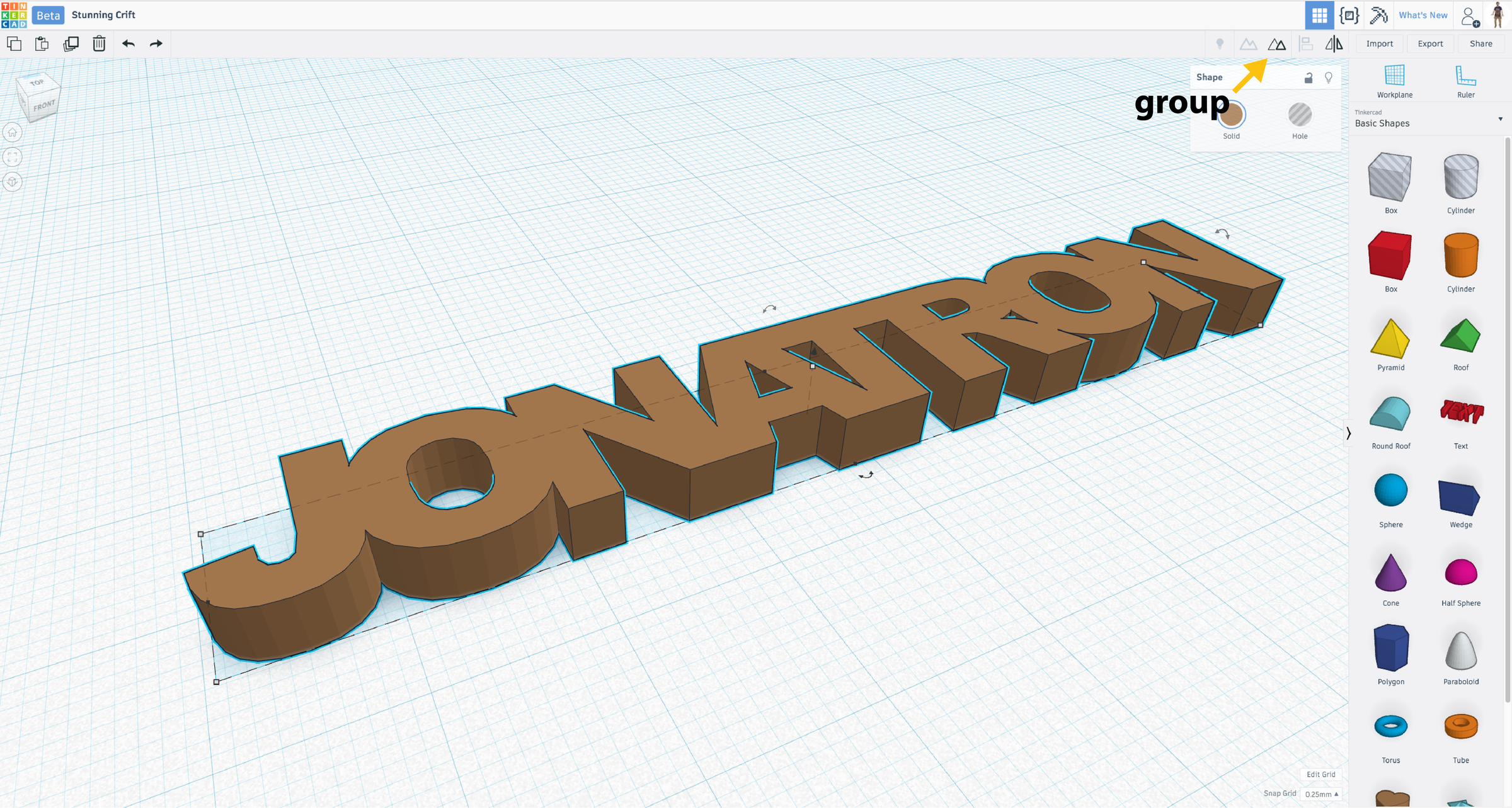

Select all your letters and group them into a single object. To do this, click and drag a box over all the letters, then click the Group button in the upper right corner of the editor as shown in the picture above. Is your name a little hard to read like mine was? Let's fix this.

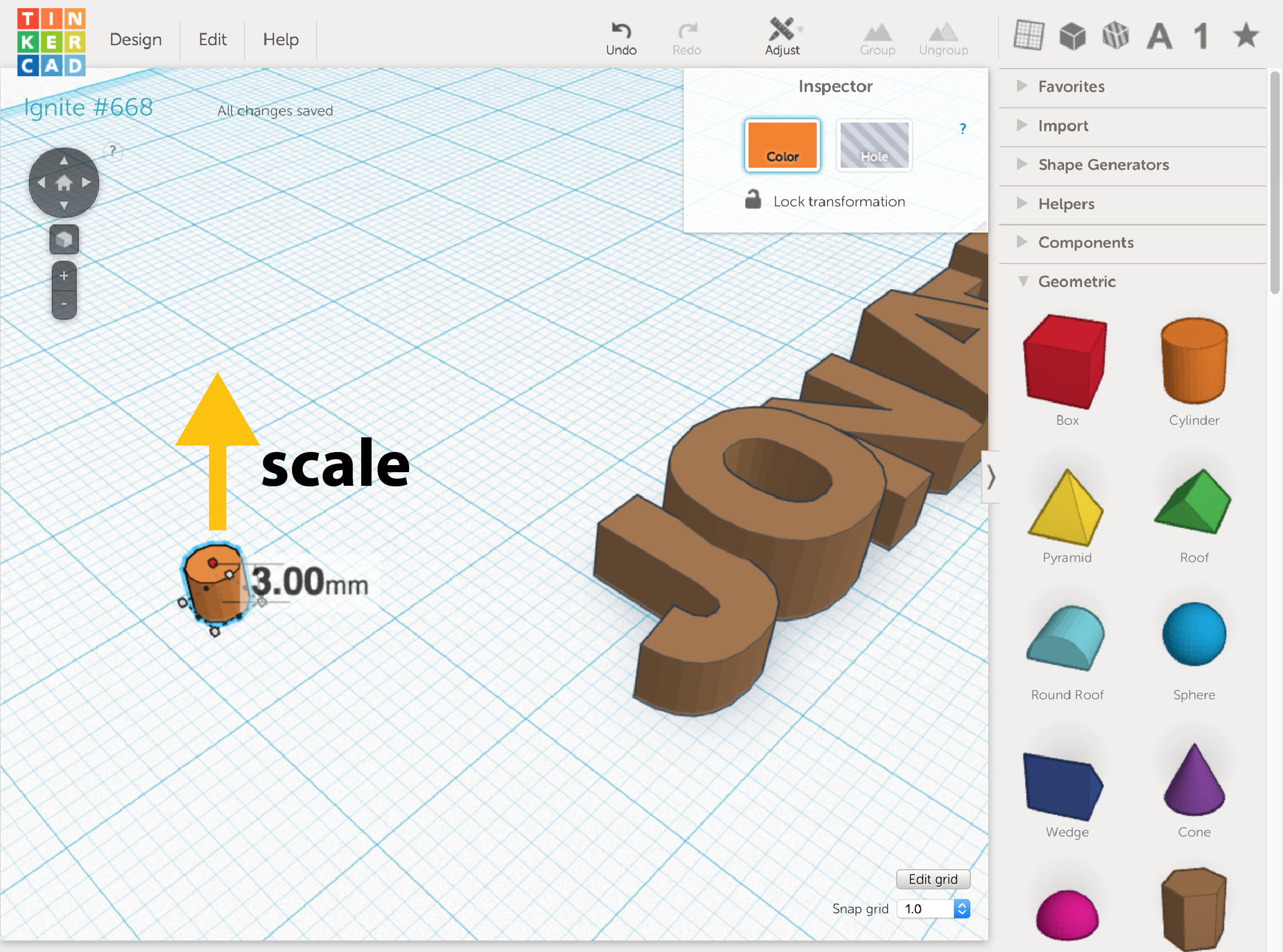

Drag and drop to place a cylinder on the workplane.
Shift + Drag the handle on the workplace and make the cylinder 4mm X 4mm in the X/Y dimensions.
Drag the Z dimension (vertical) handle to make the cylinder 3mm tall.

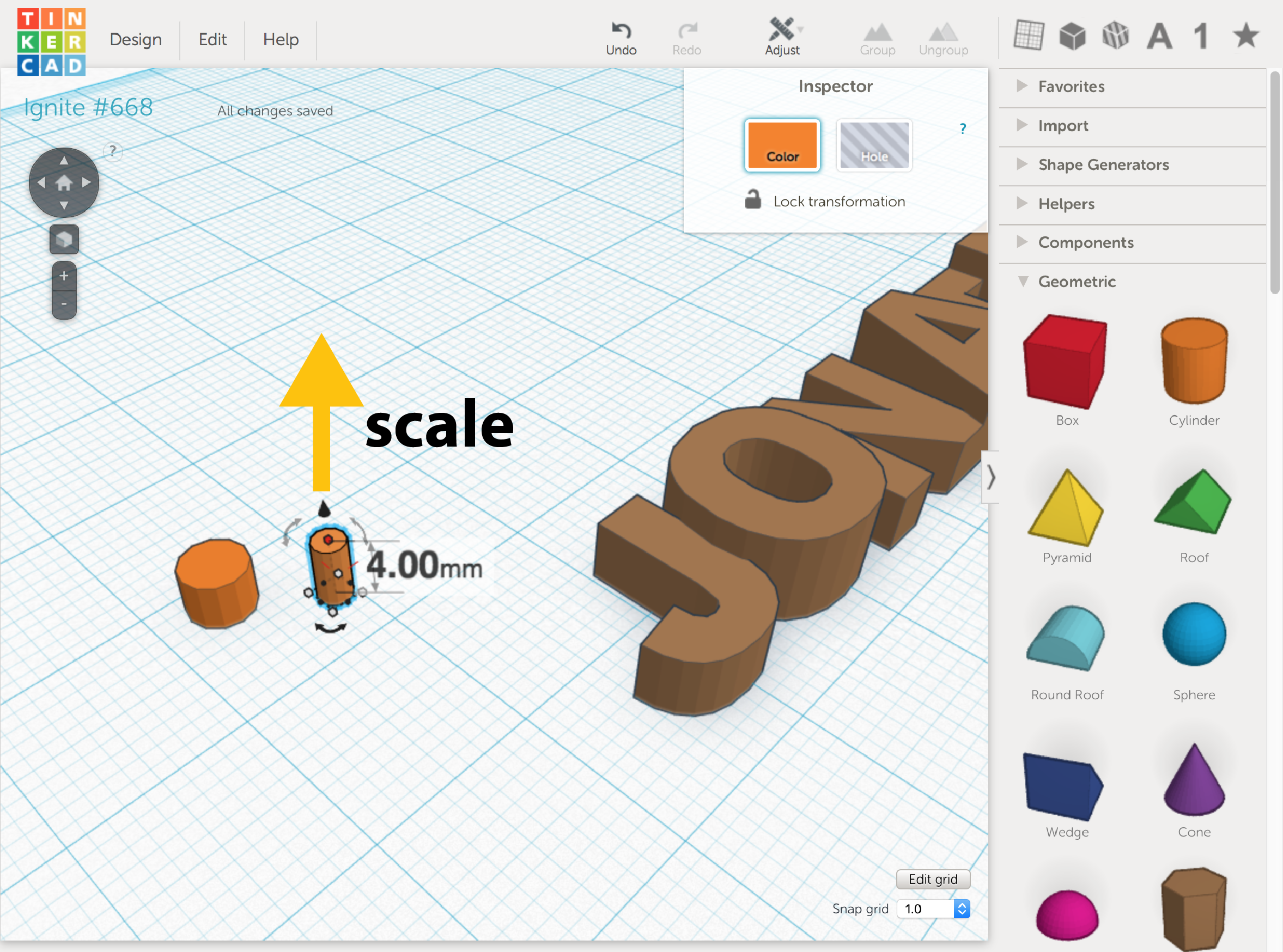

Drag and drop to place a second cylinder on the workplane and size it to 2mm square.
Drag the vertical scale handle to 4mm tall.
Select the second cylinder and make it a Hole in the inspector window.

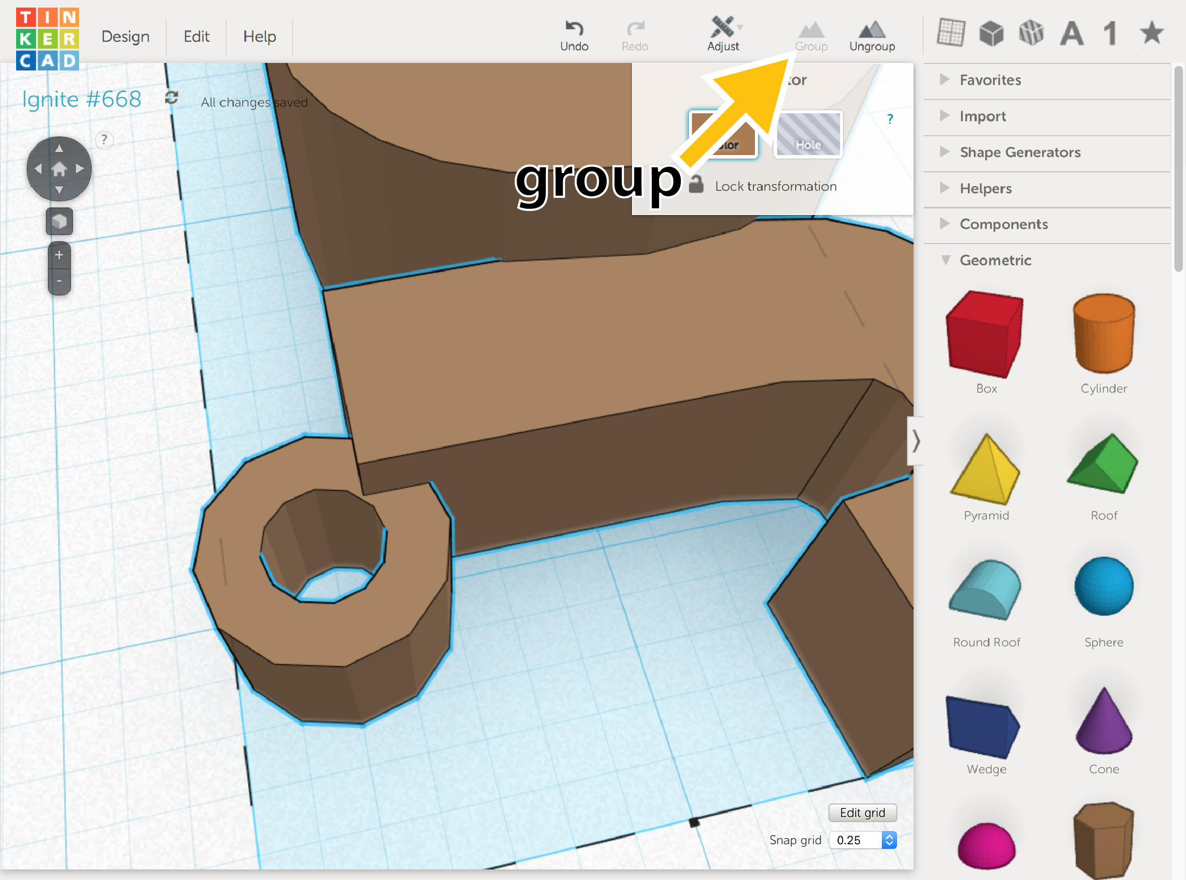

With both cylinders selected, group the cylinders into a single object by clicking the Group button on the top bar.

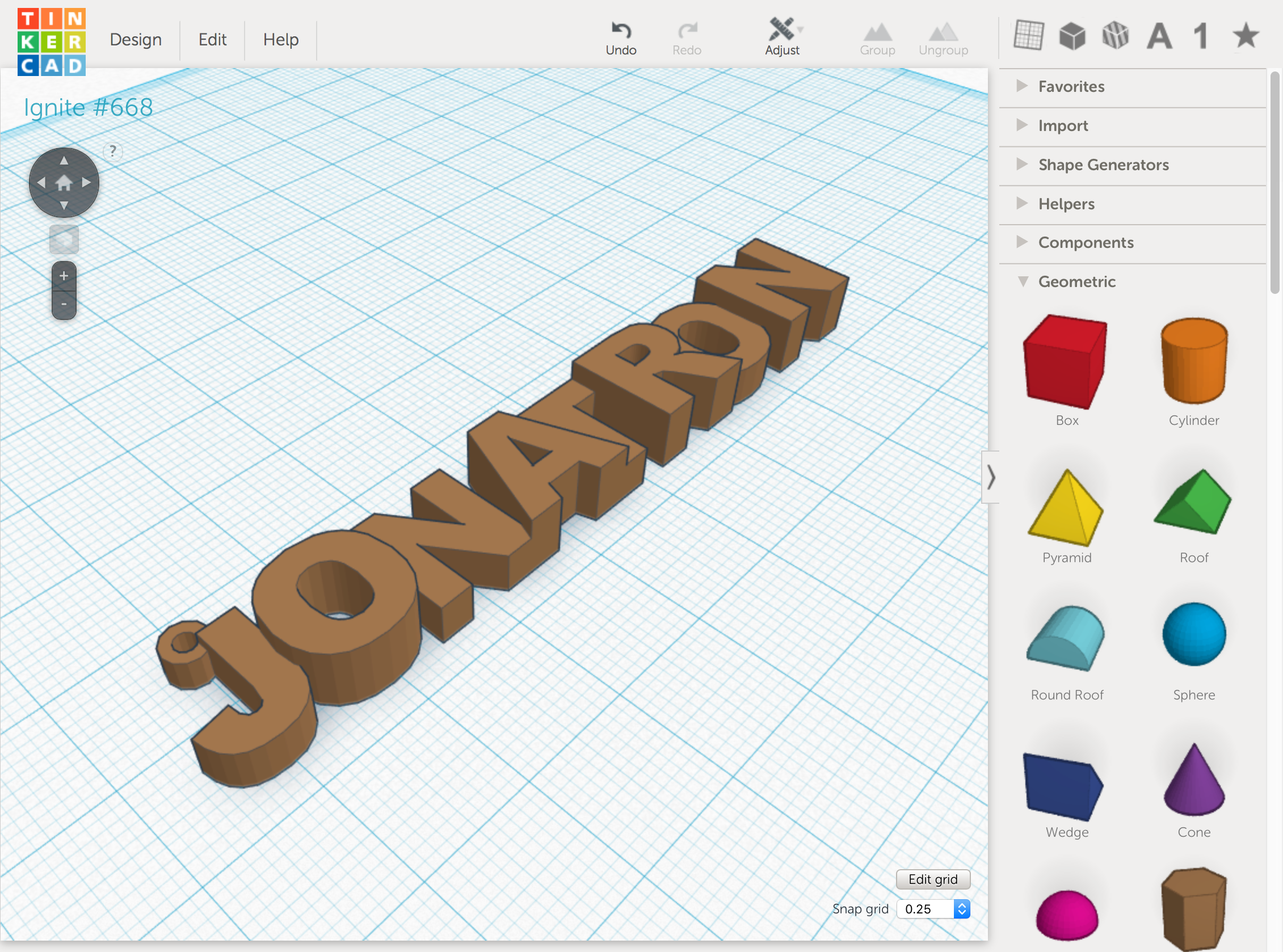

Select the key ring and use the arrow keys on your keyboard to nudge the ring into the first letter of your name.
To complete the key chain, Group your name and the ring together into a single object.
Step 7: You're Done!
Good job! Now you've created a solid object you can use to make your own 3D printed monogram keychain.
