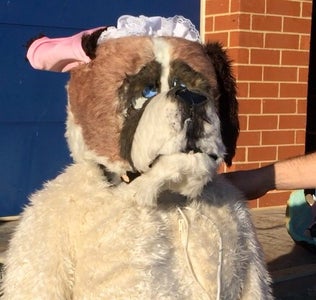

Introduction: "Nana" Costume, St. Bernard Dog Costume From Disney Peter Pan
This is the making of (for care and maintenance reference) the full St. Bernard Dog Costume used for "Nana" from CYT Fredericksburg's production of Disney's Peter Pan.

The costume was intended to bring the the anthropomorphic qualities of a cartoon dog to stage with real actors. The result is sort of a hybrid of real dog traits and exaggerated cartoon features

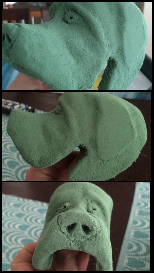

Step 2: Thumbnail
I used florist foam to get a feel for the qualities and then transferred to 2" foam board slabs.

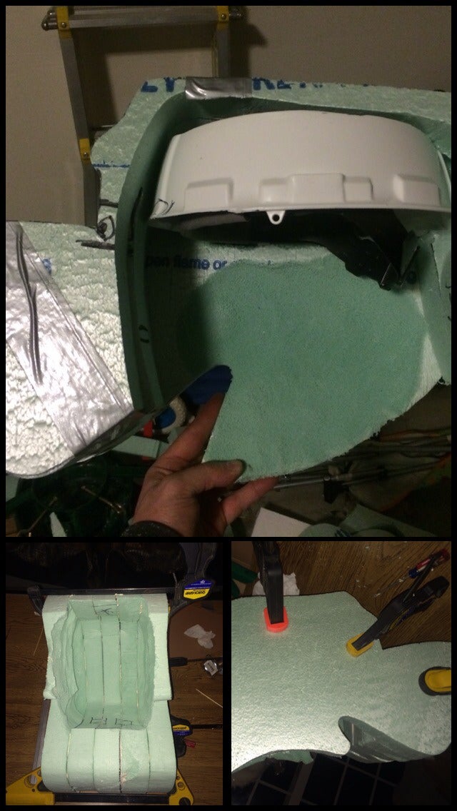

Step 3: Shaping and Eyes
Ok lots of sculpting here. Used a rasp, wire brush bit, anything I could find to shape head. Used ordinary window screen (2 ply with one offset 45deg) for eyes. Paint on one side doesn't affect visibility.

Step 6: The Body
No really good pictures here. The body was templated and built in the 'all fours' position. Looks great on stage; a little goofy standing as you might expect. There is a zipper up front. Repair as you would...
Inside is a dog chest foam frame and a tailored waist. Gives that true dog anatomy look.
Neckline is drawstring, one size fits all, cinch it up pretty good.
